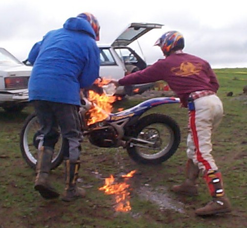

Don't remember that laurel & hardy movie, i think the fuel is supposed to ignite AFTER you put it in the bike. :ph34r:
The picture reminds me of the movie "On any Sunday" when the rider trys to make a signal fire.
nice to know that whoever had the camera dropped it and rushed to help
regards
N
watch the man on the right he is pouring more petrol on the bike.
:ph34r:
watch this man people blowing up beta's everywhere.
