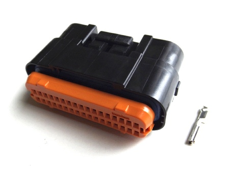

Did you guys had any problem to remove the wire from pin 32? I tried to push it from the hole in the connector with a big needle and it doesn't move. I don't want to broke the pin :huh:
I finaly get it. I found a very small screw driver and was able to push harder and heard a clic. After, I used the needle to get it out. But when inserted in the 12 pin hole, I didn,t was able to really clic it in the hole. I hope it will hold enough. It didn't was push out when I install back the ECU, it look ok.
Stou, many connectors have a small barb that holds the contact into the housing. Sort of like a fish hook, it goes in but does not want to come out. To take the contact out, the right way is to squeeze the barb in before pushing the contact out. Simply pushing it out may have bent the barb or even broken it off. That is why you did not hear the click when you inserted it.
I would suggest you take it out again and look to see if you can gently bend the barb back out so it will click in place in the connector. Otherwise it could vibrate out. I have no idea what might result from that.
Hi Thats_a_five, i know those connectors with a small blocking pin, but those on the Ossa doesn't seem to have one.
The connector is like that:
And the female pin are like this one:
It look like there's something on the top and maybe it's only because I can't push hard enough. The wire is really soft and I tried to push the pi9n with a very small tool but nothing seem to clic. But when I plug the ECU, it look ok. So I will try it like that.
