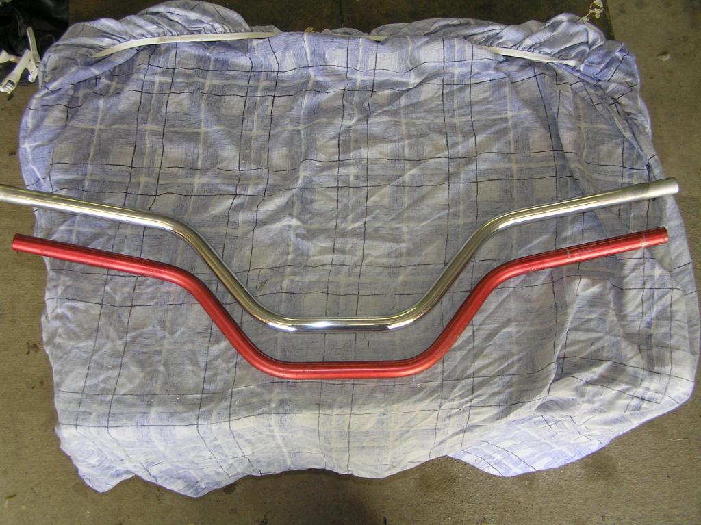

I also wanted to be able to buy bars like 1970s Renthals and recently had some sets of new bars custom made. They cost $120 per set. The red bars are 1970s Magura trials bars.
Edited by feetupfun

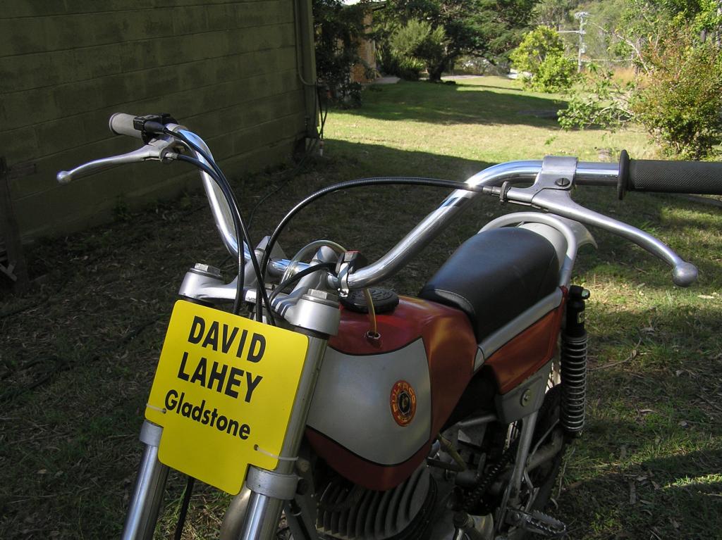

feetup, those bars look pretty nice. Here is what I would like to find. They are vintage Renthals and are very flat. I love the way they start angling up just past the clamps. These are on the wife's 175 and I bet she would notice if I swapped them.
