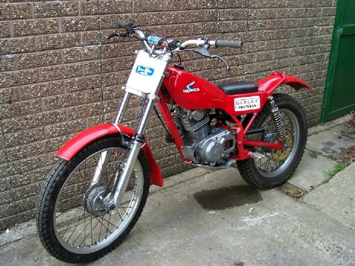

This is my Seeley...bought a couple of months ago, going to do some cosmetic work such as wheel rebuilds, hub powder coat etc.
Open to other suggestions..keep em clean please :rolleyes:

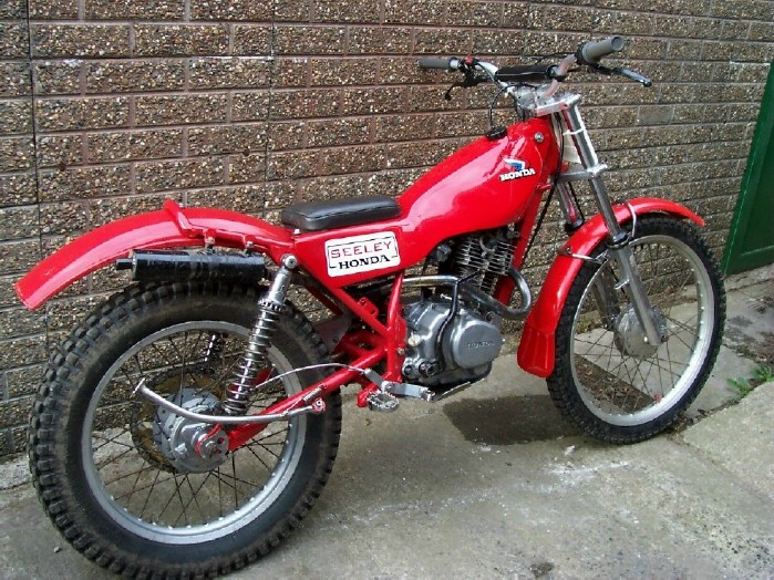

here's 1 with original mudguards & sumpshield
Not so sure about the black guards..makes the bike look a bit bulky IMHO..awesome sumpguard!
Is there any chance of a view from the otherside? would like a peek at the silencer.

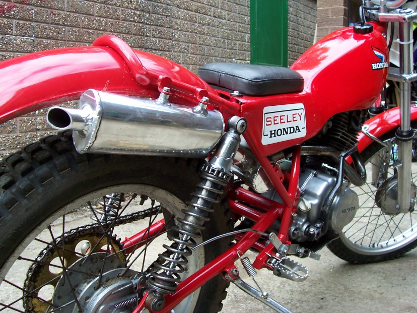

Think you've already seen the pics of my Seeley Mark, but here's a couple of pics of the exhaust. No baffles or pipe in it, initially thought there may not be enough back-pressure but runs superbly, no problems at all.

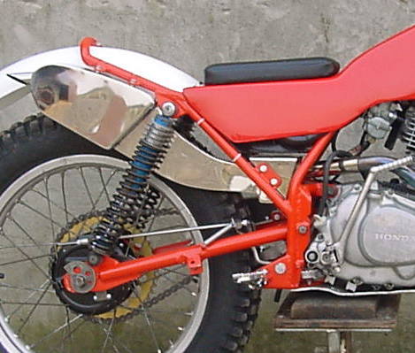

Built new alloy exhaust based on a couple of existing 'home-mades', larger tubing, mid section chamber and silencer, the bike revs out much better now and looks nice...will post picture tonight.
