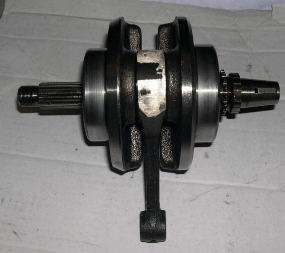

tlr 200 = 65,5 x 57,8

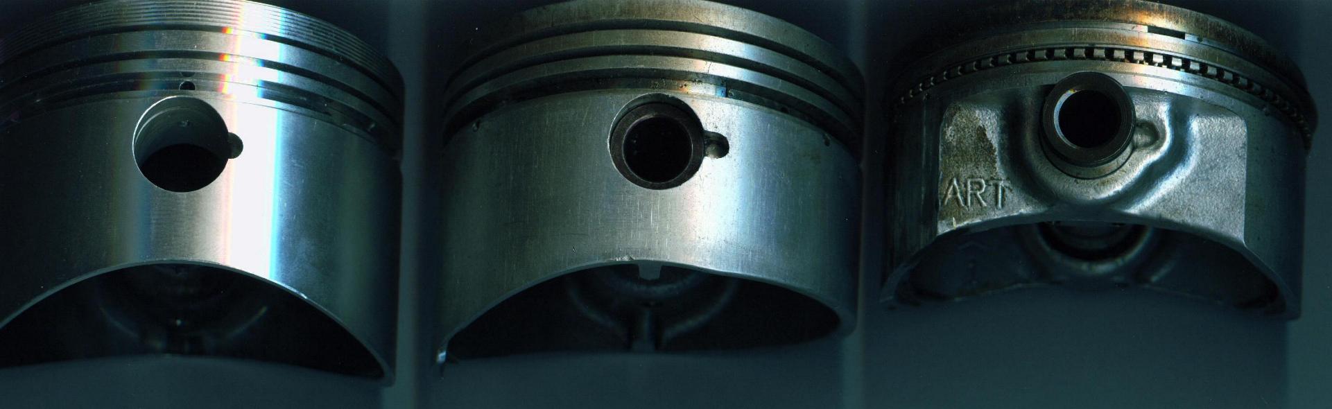

Honda provided a kit: 222 = 66 x 64,9 (right piston)
tlr250 = 70 x 64,9
the tlr200 crank mouth can be opened to fit the 250 cyl

the 210 kit is a project i'm working on, it is not complicated
altering the stroke is complicated
and a good tlr250 cyl & piston are difficult to find
philippe delwiche used to do the the 250 conversion
also a monoshock conversion, with tank/seat rtl-style
another option was a longer 6th gear (30T)
