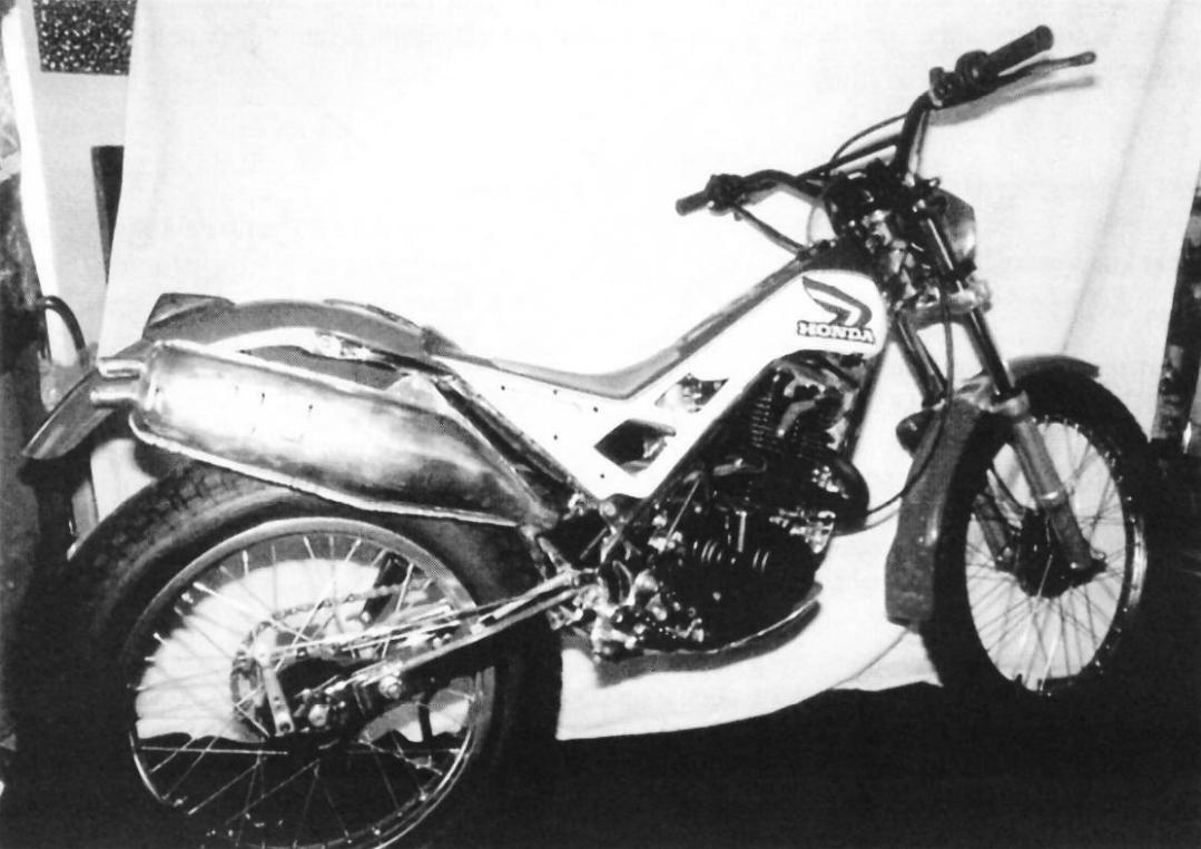

philippe delwiche used to do the the 250 conversion
also a monoshock conversion, with tank/seat rtl-style
another option was a longer 6th gear (30T)
Was this similar to the Gollner Mono TLR's?
tlrs

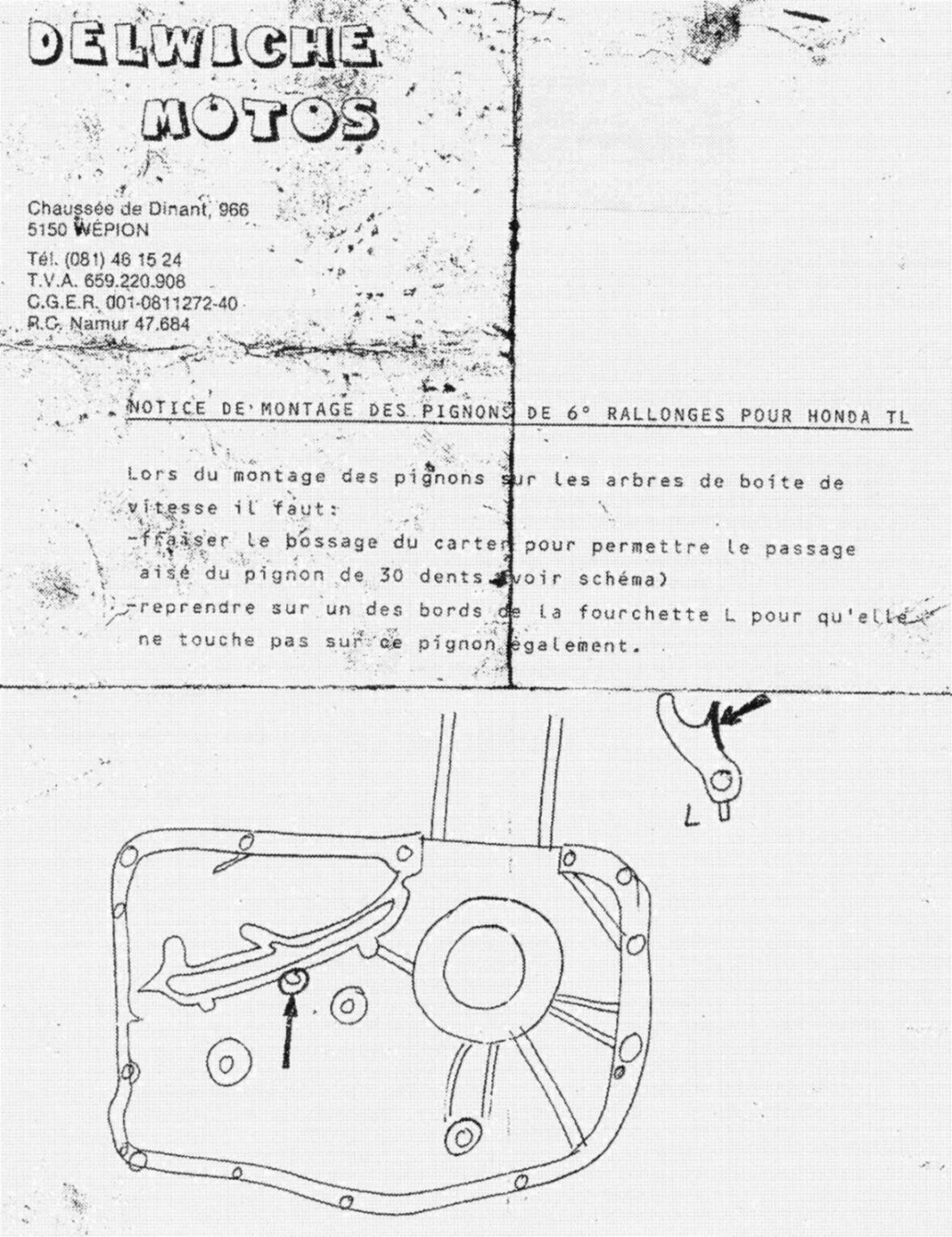

Can you give some details on the taller 6th gear? Was this done with Honda parts? Are the components still available?
sorry, i have no info on this,
just a copy of the instructions that came with it:
how to modify case & fork to accept the bigger pinion
delwiche monoshock tlr250
Just for interest does the shock work via a linkage?
Gordon
Thanks for the instruction copy. I wonder if it used gears from another Honda model? The quality of the instructions suggest to me that it was not a custom gear manufacturer. (although 20 years ago instructions were not so pretty) A wider range transmission would sure be nice.
