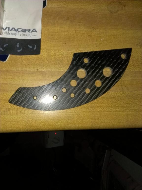

I have made these in the past for my own use and must agree that due to the exposure on the sprocket side they take too much of a beating to be practicle. The stock plastic ones are inexpensive and disposable.
Another thing to consider is the fact that one does not want something Soo rigid here to potentially break the mounts off the swingarm! The stuff I use is only 3mm thick, yet quite strong!
Here is a pic of the one that survived for quite a while on my old bike, for the disk side. The disk is smaller, thus less apt for impacts, as well as havinh at least some protection from kickstand.
I may decide to put it on the new bike and remove the plastic pos. Have not decided.(Note advert for JSE Racing)
