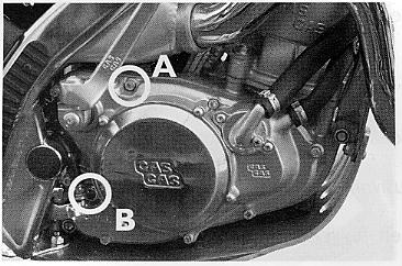

No you dont have to take the bash plate off as there is a hole like bigfoot said. Just use an allen key to undo the bung through the hole and let the oil drain, then refit bung (dont over tighten tho). The filler bung is just behind your kickstart (also allen key), take this out and fill up with fresh oil. I use Putoline GP10 but as said ATF is ok too. Use a measuring jug so you know how much oil you are you putting in!
A: shows you where the filler bung is (its actually just behind the kicker).
B: shows where your window is.
(I think this will be the same as your bike)
