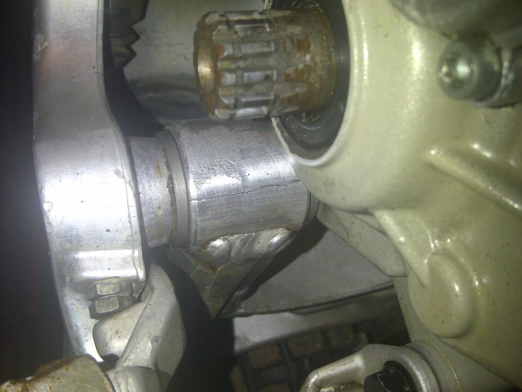

On setting up the swingarm to press out the u/s pivot bearings I noticed a crack full width of the drive side needle bearing knuckle. Didn't take much pressing out; both bearings pretty much fell out with a gentle push. Crack then closed up and was barely visible. No other significant damage or bends visible anywhere else on the swingarm.
Has anyone else come across this before? I have considered prepping the crack, tig welding and reaming the knuckle out to tolerance again to refit the bearings but I think the wall thickness is not sufficient to make such a repair structurally reliable. The bike has certainly been used for purpose but does not display any hard use or big hits for its age so I'm inclined to find this failure a bit out of character.

Here is a pic of the swingarm back in situ with the new bearings fitted. Crack is clearly visible and has gone all the way through the bearing housing. I should have taken a pic while dismantled..apologies.
The wall thickness is mighty thin. Didnt measure but estimate about 3 - 3.5mm. I dont reckon there's enough meat to bush it. Quite an unusual failure?

take the needle roller back out of the affected side .put a pair of vicegrips on it to shut the crack and run a weld over the outside and it will be as good as new
That's a very unusual place for a crack to occur, doesn't look to be related to stress from riding
It may have happened when the bearing was pressed into it so I would make sure your interference fit is right
I had a cracked swingarm welded a long time ago and the crack came right back, I think you need to completely remove the crack or at least make sure the material is completely fused inside and out
Probably need to talk to someone who is more than just a welder
I understand what 0007 is saying, but I would not put that much effort into it either as technowaldo says. To have the bore re- machined would cost more than the breakers swingarm.
You need to find a good ali welder, and if in doubt I would try contacting any(or more than one) local welding supply shop, as I hope you may have them. They could likely point you in the right direction to a local who knows his stuff and knock out that job in minutes. Then just monitor the thing afterwards and toss it if need be.
I recently found a great local welder this way, charged me a tenner for similar small job! Fantastic!

After seeing the pic and the thin wall thickness of the tube I would simply simply run a hacksaw through the crack, v it out tig weld it up, file it flat and bend a piece of flat ally around it and weld that to it to strengthen it up a bit / adding some extra wall thickness.
Looking at it I'm not at all surprised its cracked, it's very thin and the loadings in that area will be high from torsional stresses. It won't take long for fatigue to creep in over time.
I'm trained in tig welding and an engineer by trade, so that's how I'd do it - but I wouldn't have to pay someone to do it as I have all the tools so it wouldnt cost me anything to fix. if uou have a mate with a tig he'll fix it no problem for a minimal fee.
You might find a cheap swing arm else where but if you plan on keeping the bike then a repair will be stronger than new swingarm in the long run. In fact I'd probably do both sides cause the other is bound to go soon too.
