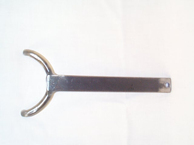

you could also spend the equivilant of 4/5 packets of fags and treat yourself to a proper flywheel holding tool, which will do virtually any bike flywheel...

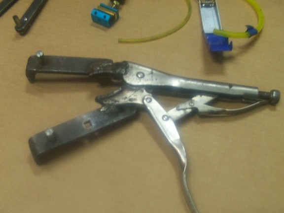

And it would probably look a lot like mine. <_<
Like this???
That one looks pretty 'fixed'.
Mine is the 'infinitely adjustable' model.
Just drill another hole and move the bolt.
another home made version. Fits flywheels, sprockets, and clutch hubs outside and inside. Looks tacky but its old and was quick at the time.
PS. I use the air gun to remove, and to very loosely assemble, but like charlie I use a wrench for final tightening.
Even my 3/8 gun has the potential to take the threads out of the nut, or possibly off the crankshaft. I just don't want the risk.

I'm sure theres a law against defacing mole grips :wacko:
