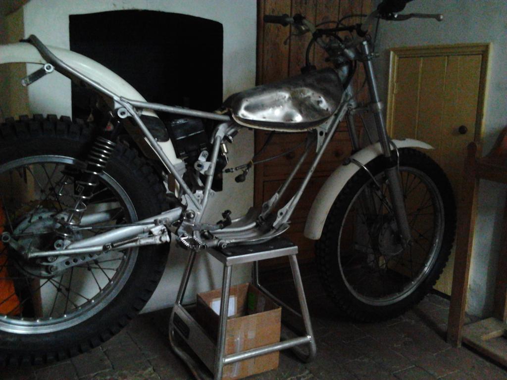

My version of the KATO tank ...... I could call it the SHIPDO tank (this was what lurked under bad graphics/paint/filler).
