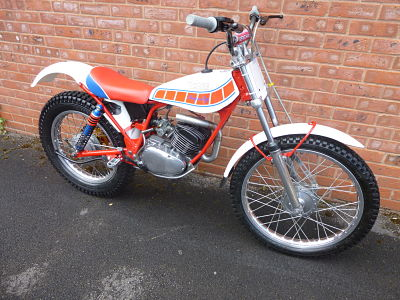

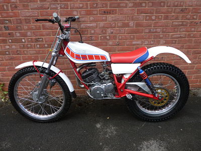

Hi All, Nearly finished my Majesty and I am in two minds what exhaust to use
Option 1 WES center box with no rear silencer
Option 2 two part WES system but by the looks of it it will need cutting and welding on therear silencer.
Option 3 refub the original system
I will ride the bike when done so performance is a factor.
your opinions welcome
Regards Scorpa250
