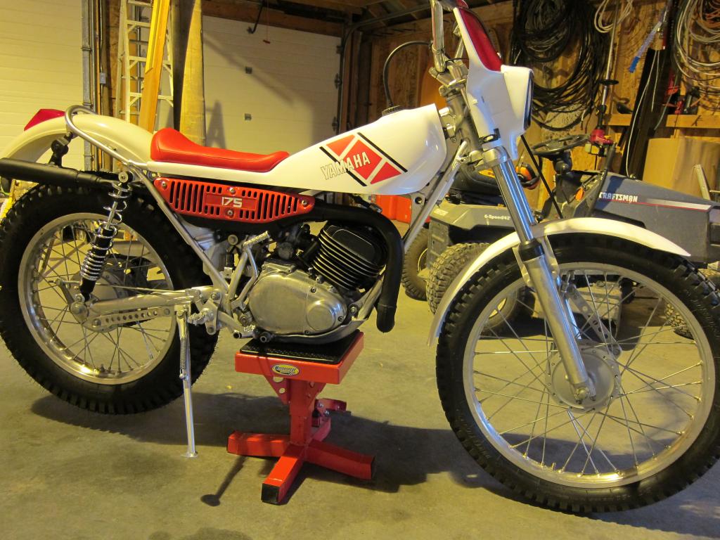

  • Before & after pics.  Just about finished.  Some fine tuning to do and in time will re-chrome the fork tubes.

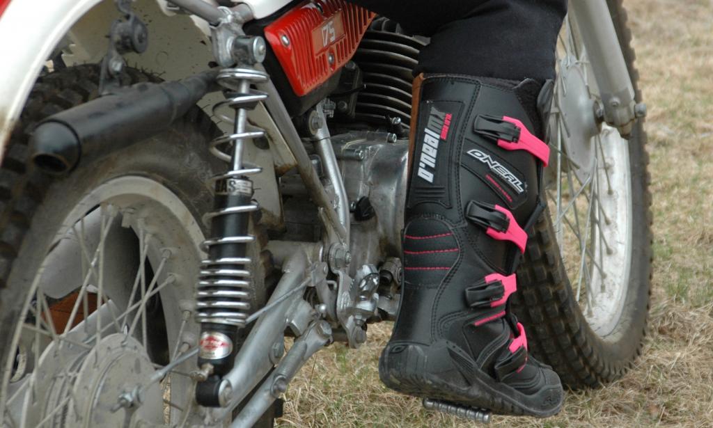

Thanks, but it's not mine, it's my friend, Lori's. (and the TY80) It's her first bike and she wanted to start with a seat. Hopefully we'll get her on a new bike next year! And save this one for vintage events. I think that will be fun for both of us. One of us might have to ride the 80, but according to 'Lineaway' I guess it's possible.
Edited by fulltilt
She rode it today for the first time and did pretty good. We'll get her to the events soon!

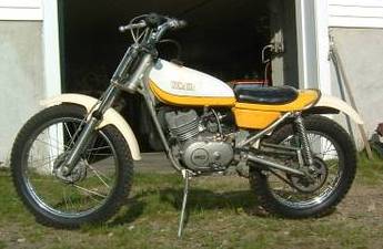

Can anyone tell me something about the TY footpegs. In the picture above you can see what is on it. But I noticed some knurled shaft ends under the engine which I'm told are the original peg mounts. Is that right? And if so, where can I get them? I'd like to get as much original equipment as possible. I do have the original metal tank, with nuts and seeds from a previous squatter. Original fenders will be really hard to find, without a doubt.
I was always under the impression the foot peg mounts under the engine were from the original DT175, of which the TY origins were built from.
I suspect they were leaving the option open of making a trail riding kit for the TY175, as was made for the TY250A. The DT100/125/175 footpegs of that time mounted on that sort of spline. As with the TY250A, it would require a very long brake pedal

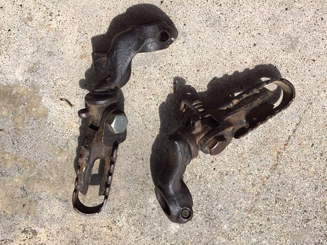

Like these? Got this set with some other TY175 parts.  Keeps you nice and centered!
 You have original equipment. As previously stated before, Yamaha could not sell the bikes as trials bikes. They came out with trail kits to make them worthless for trials, trail friendly. We had dozens of the original pegs left over when I worked at the local Yamaha dealer.
