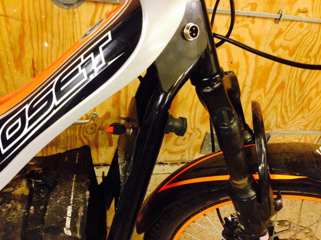

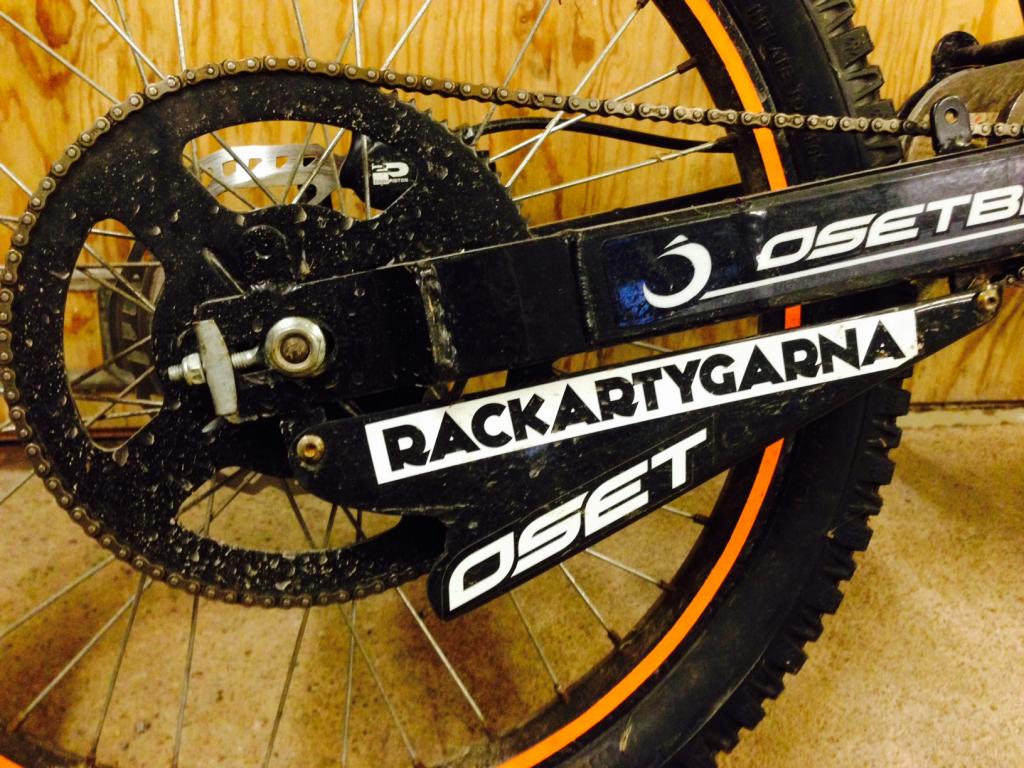

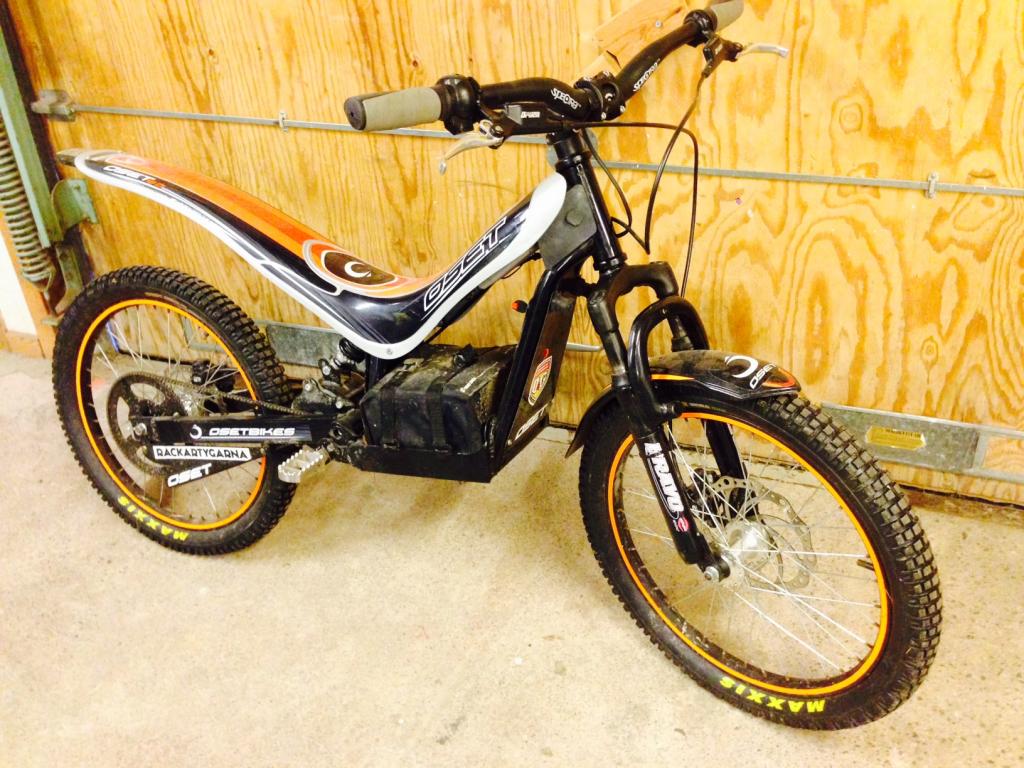

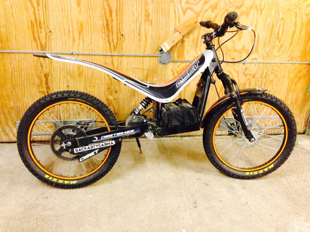

As requested by Sveson:
Homemade 20" OSET Lite, "Youtube-spec"
Standard OSET 16" frame.
Rear swing extended by 50 mm´s
24" front fork installed.
180 mm front disc.
Wider steerer(Same as oset 20").
Hydraulic brake converted.
Controls in accessible area.
