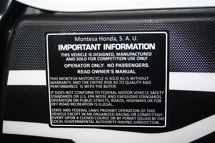

I took delivery of my 4RT last weekend. Although this sticker is on the bike, I asked the dealer about the warranty, anyway. He scrolled through some documents and informed me no warranty is offered on Race models.
I haven't ridden it yet and I haven't started taking it apart - I'm enjoying looking at and studying it in my living room (and probably will for the next couple months). The only thing I've found wrong, so far, is the fork legs aren't the same height in the triple clamp - one is about 1mm higher than the other.
They might get away with that in the US but there is a lot of consumer protection legislation in the UK such that the sticker would not be worth the sticky stuff it's made of. If a bike is sold for competiton use here then it has to be fit for same.
