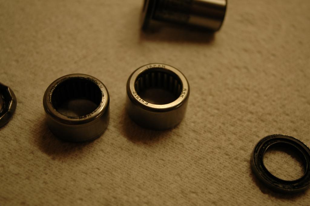

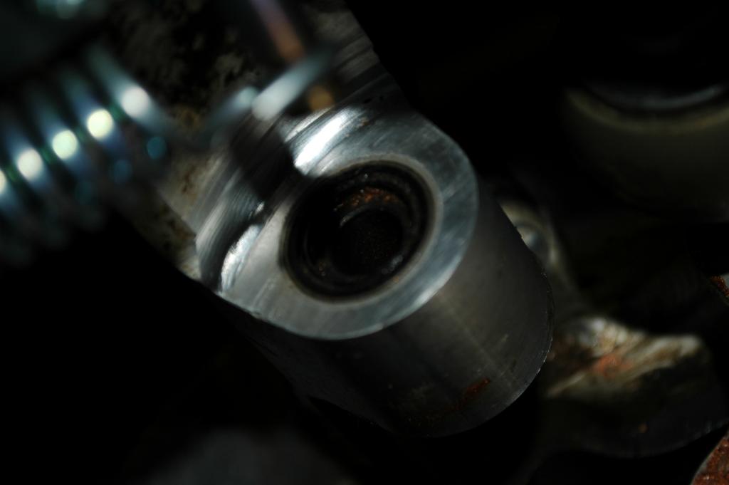

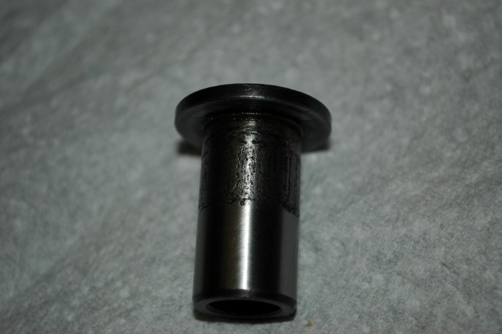

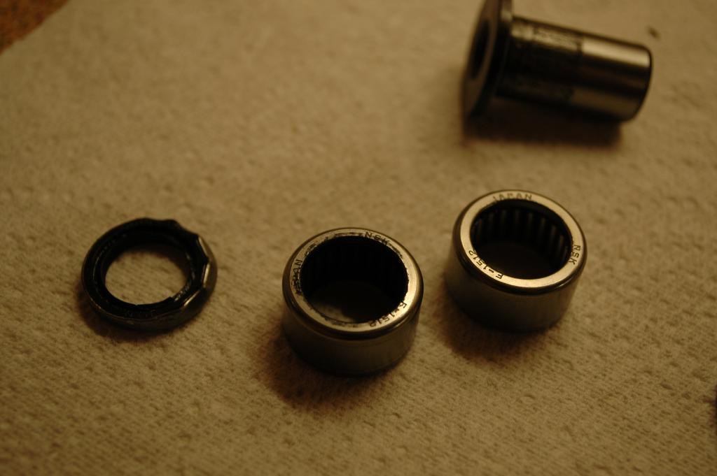

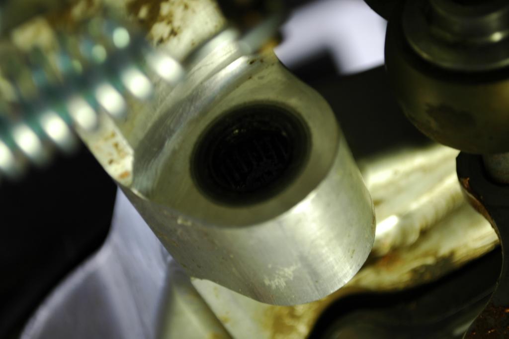

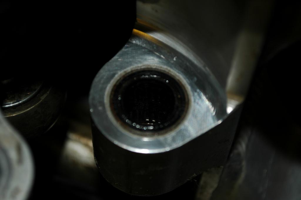

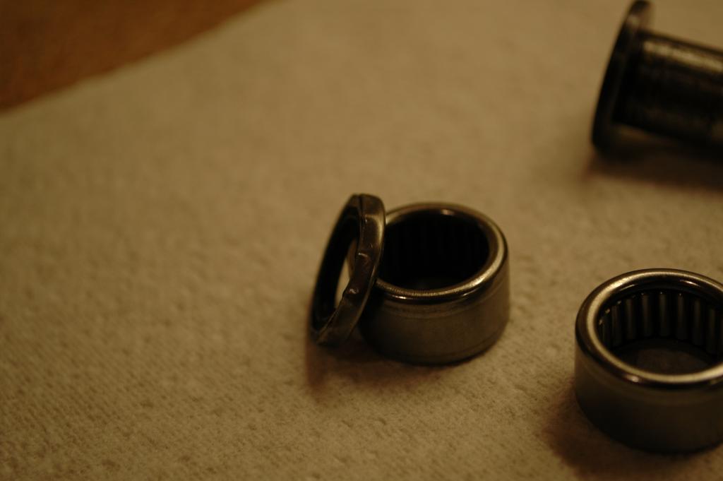

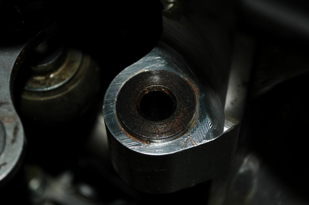

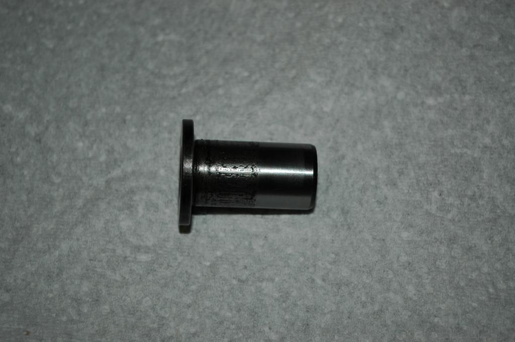

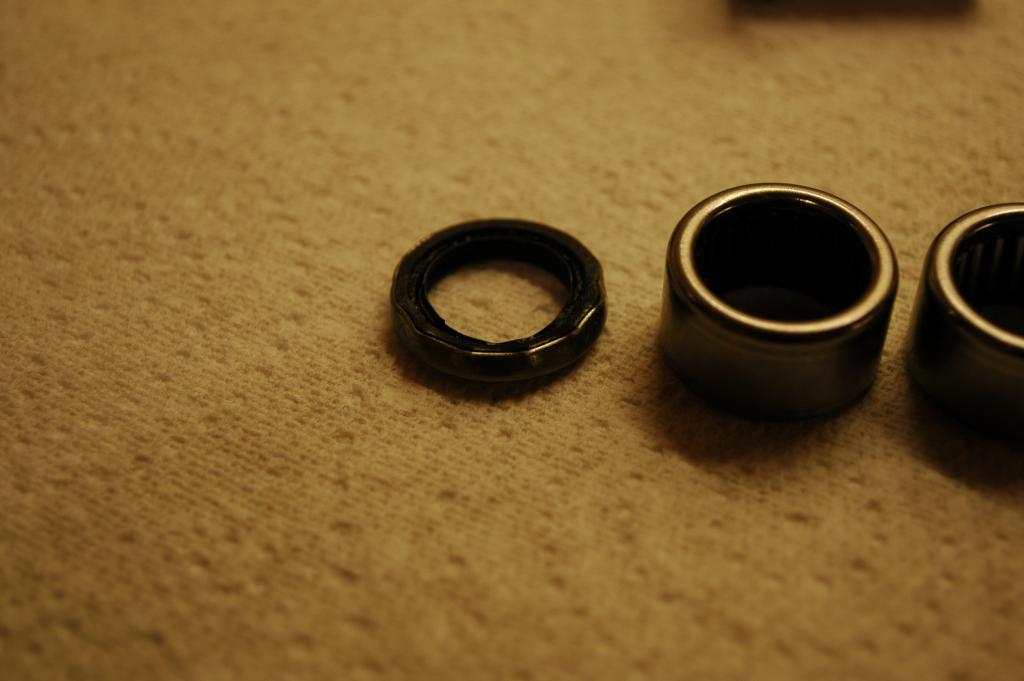

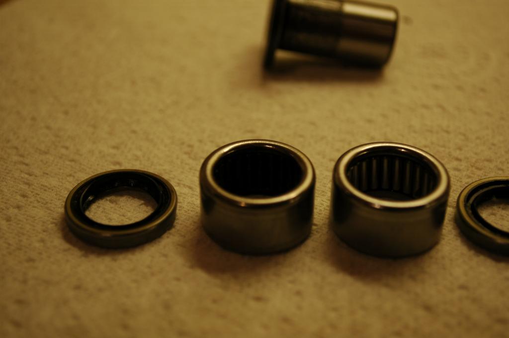

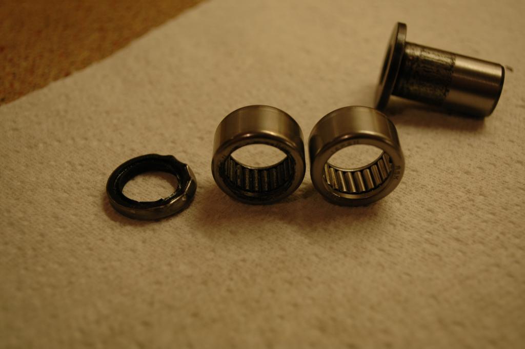

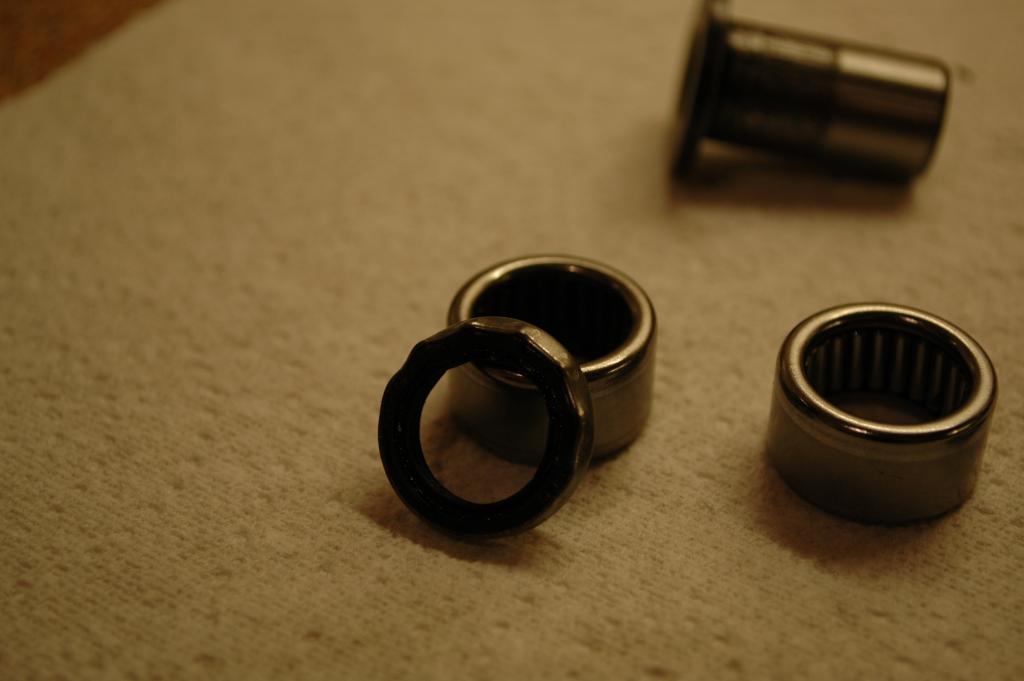

Well managed to get the old bearings and seals out tonight :-
Img 20 is the long collar left side
Img 22 is the opposite, right side
Img 24 & 27 is the collar removed, Quite obvious water has contaminated the left side and that the bearing has not been running on this side at any stage of the bikes life.
Img 32 & 31 bearings in situ with collar removed
Img 41 bearings and seals in order long collar side on left,
Img 43 note damage to seal inner side
Img 45 as 43 but also note how dark the needle rollers are compared to the right side
Img 48 please note the damage on the left bearing seal side compared with right side
Img 49 & 50 lost the will img speak for themselves
Now I know some of you will say Ah you have tried to pry the seal out with a driver from the left side hence the damage !
NO absolutely not
the bearing and seals were pushed out from the right side to the left using threaded bar correct side drift washer and hollow tube to push the bearings into. Therefore damaged seal out first.
Look to me very much like the left bearing has been pushed hammered or pressed in with the seal damaging both seal at bearing.
the bearing outer face has been squashed in preventing the needles from turning and due to the damaged seal water has got in to corroded the shaft. Just look how clean the right side is !!!!.

They've got to hold their hands up to that one. Never seen that on 11 years worth of monts. I've always wondered why manufacturers continue using needle rollers in the linkage as there is so little movement for them. Would spherical bearings work better?
Edited by jrsunt
Needle rollers are much lower friction / stiction. If all linkage bearings were spherical suspension would be nothing like as plush.
I generally run a new bike in then strip, clean and grease all the chassis bearings
If I pressure wash (very rare) the bearing area or if bike has been in deep water I strip, clean and regrease
Normally I service bearings about every 3 to 4 months.
I find on many bikes the dog bone bearings nearest the rear wheel need more frequently greasing than the others and swinging arm bearings.
