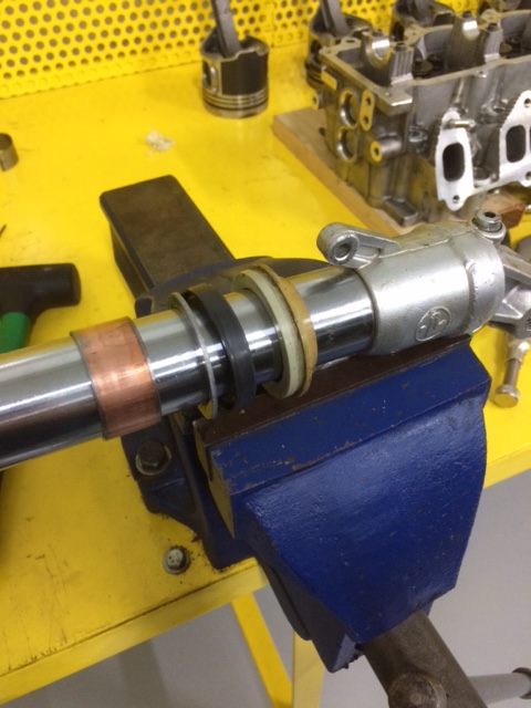

I finally got around to stripping down the forks today. Was hoping to find a snapped spring or something obviously wrong that needed repairing, however, everything seems normal although I'm not sure what the standard spring length should be.
Having said that, I'm not convinced the amount of oil drained out was enough (forgot to measure it). I believe it should have 250 ml each side, according to one of the above diagrams. Wasn't leaking but could have been before I bought it. Guess it looks like a a rebuild with new seals and oil and see if it's sorted!

Careful with oil capacity because the cartridge forks don't drain completely. Refill measuring oil level from the top of the tube compressed.

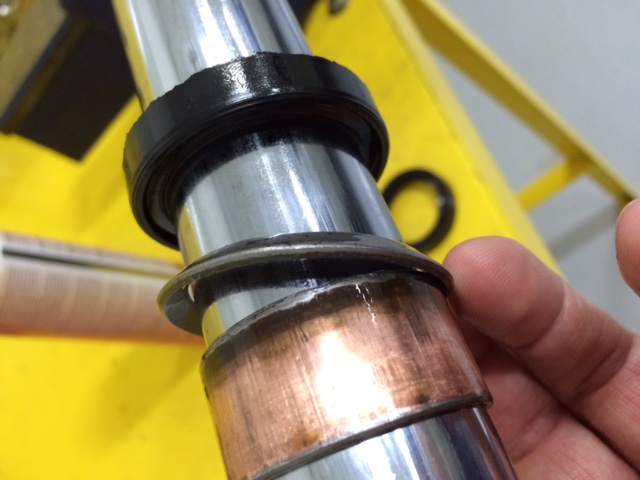

Are the left and right washers supposed to be different? The left (spring) side is flat, whereas the right is tapered.

No, they are supposed to be the same. That bush looks pretty hammered.
Unfortunately all parts are obsolete. I should be able to get the washers custom made, but the bushes may just have to be reused.
Hi. I broke a 95 techno so I have some of the shaped washers pm me
