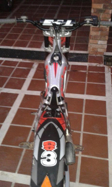

Hi Everybody ,
Wanted to share my happiness with yo all.. just purchased a 06 Beta rev3 which was in a shed unsed for a couple of years..
Opened the fuel valve , pull choke.. and she fired right up.. amazing for a bike stored and forgotten for years..
I come from a Extensive competition Enduros, and mx dirt biking and yesterday a gruop of trail riders took me to the mountain on my first ride... all i can say uufff.. this stuff is awesome... diffficult to adapt to this position due to my height..im 6'1'' and also coming from a full sized mx bikes.. the trial bike wasnt easy for the 1st hour... in the end I addapted really ell and began to understan that climbing really steep long sections speed is not the technique... is balance and momentum.. gas and clutch control... a total different attack compared to my full size ktm ... anyway.. this stuff is amazing !!! I hope i learn quickly and begin to clear all obstacles and sections clean !
No, for the bike...she was all dirty... stained... even the spokes on both wheels were totally atained with little rust...
But after 2 days of scrubbing...and using meduim abbrasive sponges... noy she is really clean.. the way it shoud be :))
this bike has been used... from what i can see she is not new ... but hopefully she has not been abused.
I did changed the tranny oil.. with ATF Dexron 6... 450cc.. ( please correct me if the quantity is ok)...
Drained all the old fuel... opened the carb drain plug... Added fresh fuel mixed with motorex 2 stroke cross power oil I had from my older 300 ktms i had in the past.. changed the grips... changed the handlebar..(old one was bent)...
removed the chain and cleaned it... lubed it and installed back on..... greased the bearings at the head tube..and wheels.. Installed a new Air filter properly oiled.. and ordered both front and rear Carb rubber manifolds since they are dry and rotten...
I heard from this forum that the carb on this bike is famous for p****** fuel...on and on..
Well on my bike no fuel leaks..either climbing or leaning tothe sides.. I believe im just lucky or the previous owner did something to it ... who knows... he is away and i was unable to talk to him directly.. bike was bought thru his neighboor whom really dont now nothing about dirt bkes..
Ill post some pics... Im really happy and looking forward to become and good trial bike rider !!
Im tall and weight 230lbs... so the golden rule on enduro bikes and mx..is first to set the bike for my weight... chosing correct spring rates front and rear... perfect SAG...
On this bike I believe ill need a stiffer rear spring... since I felt the tire rubbing te rear fender a couple of times.. and Ive never used a dirtbike without setting it right before attemting to go crazy and also compete.
All advice is more than welcome from you all... This is my 1st Trial bike ever... so Im new to this and also new to Beta...
So all tricks,,, advices... and tips will be highly appreciated !
Sorry for my bad grammar.. English is not my mother language... Im from Venezuela,.. and was fortunate to learn english way back at chidhood
Im new here in TRAILS CENTRAL... this is my 3rd post... I was looking at a gas gas.. really clean.. but was advised from everyone who rides here that BETA was mor reliable and solid in every way... So Here I stand.. a proud owner of my 06 Rev3..
Is there a way to find out if my bike is a 250cc or a 270cc ?? the bike does not has any sticker and the previous owner said he didint knew... he believe is a 250cc.
Cant wait from hear back with help and comments from you guys...
thanks in advance
Very tidy bike, I had an 06 and loved it. The best mod I found for mine was to swap the air box/carb rubber boot around so the larger opening fitted onto the carb venturi not the air box opening, made refitting the carb so much easier. We also removed the light blue spacer (about 4-5mm wide) from the reed valve block which gave even more room for the carb to go in. Re packing the silencer is very easy on the rev, you do need the right amount to go back in though (not too tight)

Looks a good bike :) I changed all the fluids, plug, cleaned and checked everything when I got mine found rear shock bearings had gone and front spindle pinch bolts snapped and just glued in :wall:
Engine code/number look under the carb towards rear of the bike.
Throttle cable is adjusted where it goes into the carb. If its fully adjusted think a new cable will be needed.
Would be worth giving the carb a clean out when you get the new rubbers.
You can add some preload on the rear shock cant tell from the photo but looks right off but yes a heavier spring probably needed.
Gear oil quantity in the book is 550cc but some put 500 in (so a bottle does 2 changes) after reading what others used some use ATF but a lot prefer the feel 75w gear oil gives the clutch.
You might find ATF a like too grabby in the gearbox/clutch.
As mentioned, a good quality 75w lite gear oil (550cc) designed for wet clutches I find works better.
