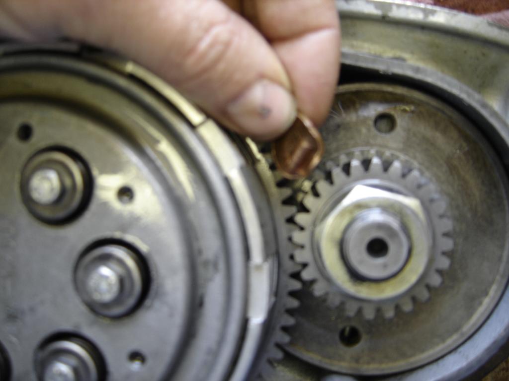

fulltilt Posted April 28, 2015 Share Posted April 28, 2015 I use a few old clutch plates and hold them together with locking pliers to hold the clutch basket. If your ambitious, I suppose you could rivet them together. That's a lot cheaper than the special tool. And a penny in the primary drive gear will stop it from turning. Make sure it is an old copper penny and not the new steel/copper coated. The steel will damage the gear. I've never had a problem with copper. Goudrons is right, you definitely want to do this in the frame, much easier. I had a 96 Gas Gas that I beat the crap out of. After 9 years of abuse, it sounded like an antique sewing machine on FullTilt! So, one winter, I lugged it into my apartment, (don't tell my landlord!) and I overhauled it. The big end of the con-rod was extremely sloppy. See picture; it's hard to believe it ran OK and didn't grenade itself when I red-lined it! I replaced the rod, bearings and pins, and went up TWO sizes on the piston and rings (with NO changes to the cylinder) and it ran like new. Just be sure you replace what it needs and don't overlook anything. 1 Quote Link to comment Share on other sites More sharing options...

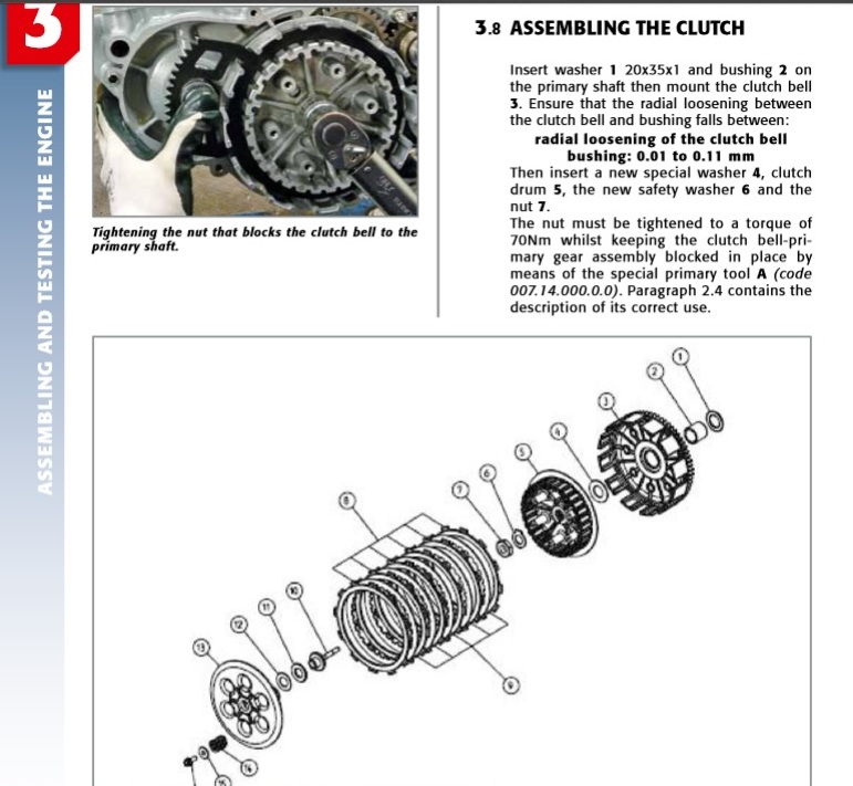

zoomered Posted May 14, 2015 Author Share Posted May 14, 2015 Excellent help thanks. Really wish I had listened the clutch basket before I removed the engine. Circling behind the nut is kinda in the way of the nut. Is this normal? Do I need to mark any of these or do they all just go back on one way? Kind regards Thanks Quote Link to comment Share on other sites More sharing options...
fulltilt Posted May 14, 2015 Share Posted May 14, 2015 (edited) Excellent help thanks. Really wish I had listened the clutch basket before I removed the engine. Circling behind the nut is kinda in the way of the nut. Is this normal? Do I need to mark any of these or do they all just go back on one way? Kind regards Thanks Does it look like my Gas Gas in the above picture? If you're talking about the metal flat washer that holds the nut on, just beat it flat with a cold chisel. It should be replaced, but I have re-used them. Some clutch baskets have alignment marks on the flanges, look them over carefully, usually, they'll go on in any position. If you look at the picture closely, you can see one of the towers for the clutch springs has a line stamped across where the bolt goes in. There is a similar mark on the clutch cover and they need to be put together so the lines match. I don't know if Beta has the same marks, just look it over and check the service manual. Edited May 14, 2015 by fulltilt Quote Link to comment Share on other sites More sharing options...
fulltilt Posted May 14, 2015 Share Posted May 14, 2015 Does it look like my Gas Gas in the above picture? If you're talking about the metal flat washer that holds the nut on, just beat it flat with a cold chisel. It should be replaced, but I have re-used them. Some clutch baskets have alignment marks on the flanges, look them over carefully, usually, they'll go on in any position. If you look at the picture closely, you can see one of the towers for the clutch springs has a line stamped across where the bolt goes in. There is a similar mark on the clutch cover and they need to be put together so the lines match. I don't know if Beta has the same marks, just look it over and check the service manual. 1 Quote Link to comment Share on other sites More sharing options...
