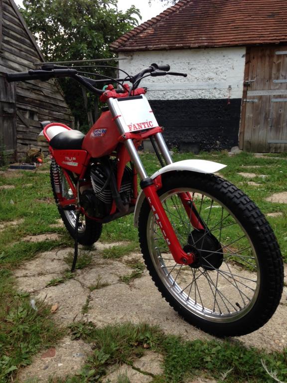

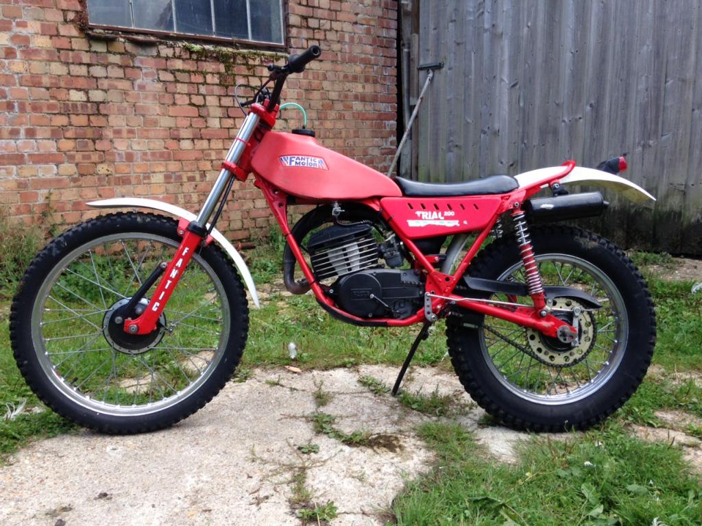

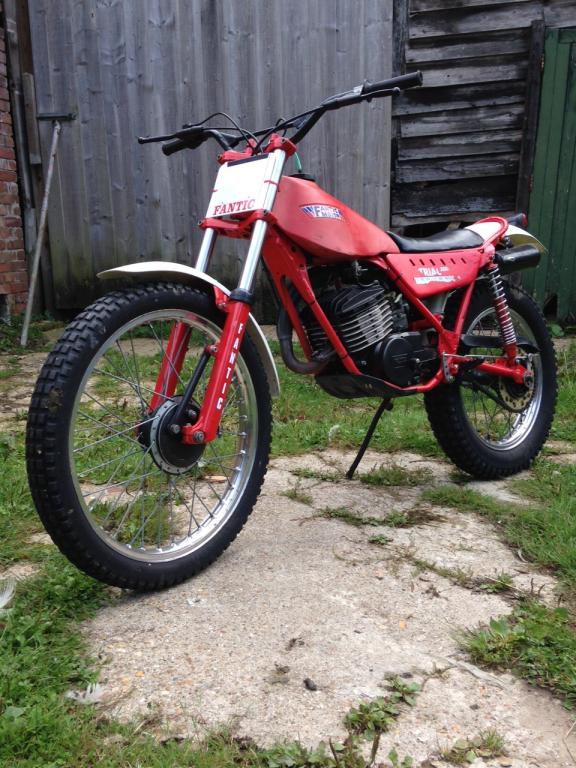

Hi all, I'm new here, so thought I would start by attaching some pics of my first Fantic....It's a 200, rear kick model in brilliant mechanical condition. The engine sounds tight and crisp with no rattles and starts second kick every time...I am not sure of the age, but would guess and#39;79-and#39;80...? Is there any way of identifying the agae of these bikes from the engine or frame no's? I love the bike as it is, and just intend to tidy it up really.....
post-21626-0-64539700-1440599629_thumb.jpgpost-21626-0-67579000-1440599642_thumb.jpgpost-21626-0-24611200-1440599652_thumb.jpgpost-21626-0-93341500-1440599662_thumb.jpgpost-21626-0-00408600-1440599674_thumb.jpg
That looks very tidy and original. I'd just service it and ride - they are a VERY capable little bike...
Look under the tank, there will be a date stamp, this should give roughly the age.
