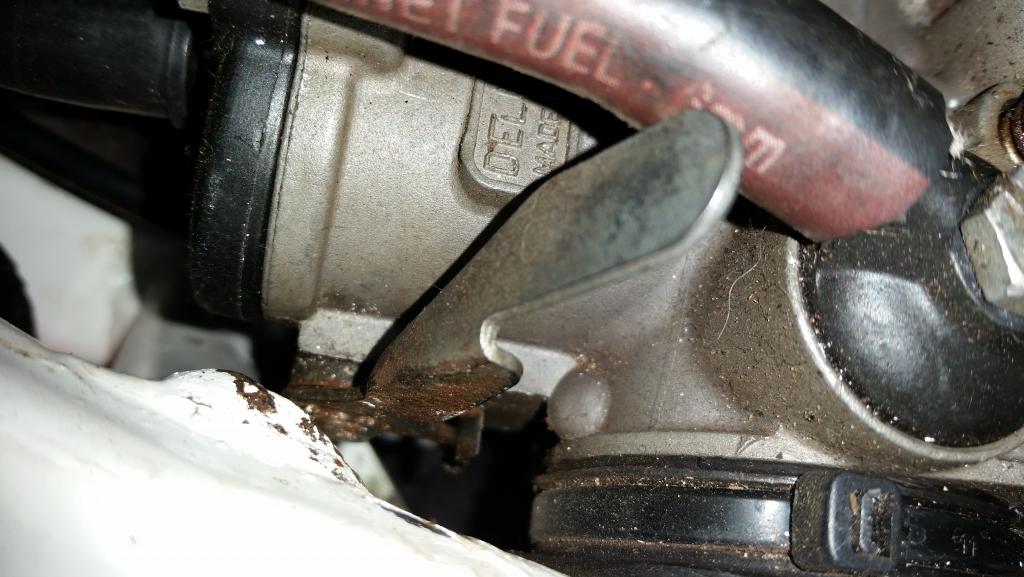

The 3 series choke set up is different to the set up on the 5 series bikes, down on a 3 series bike is on,I've just checked on my own 303. Looking at the photos of your bike in the gallery section I think I know your bike maggar,it looks like the one i sold 80% complete to the chap you bought if off.
Oh sorry it has the metal lever that pivots on the side not the usual flip up plastic lever. My mistake. My 240 and 307 has the plastic flip up type and my 309 had the metal side pivoted type otherwise both carbs are identical. I thought it was only later bikes had the metal type.
You cannot see the plunger on a 3 series bike, and as fantic240motor and myself have pointed out the set up is different, its worked by a lever which pivots,so when the lever is down the plunger is up hence down is on, this is a photo of my 3 series carb.
Thanks Andy, that has cleared it up. Thanks everyone for your replies.
