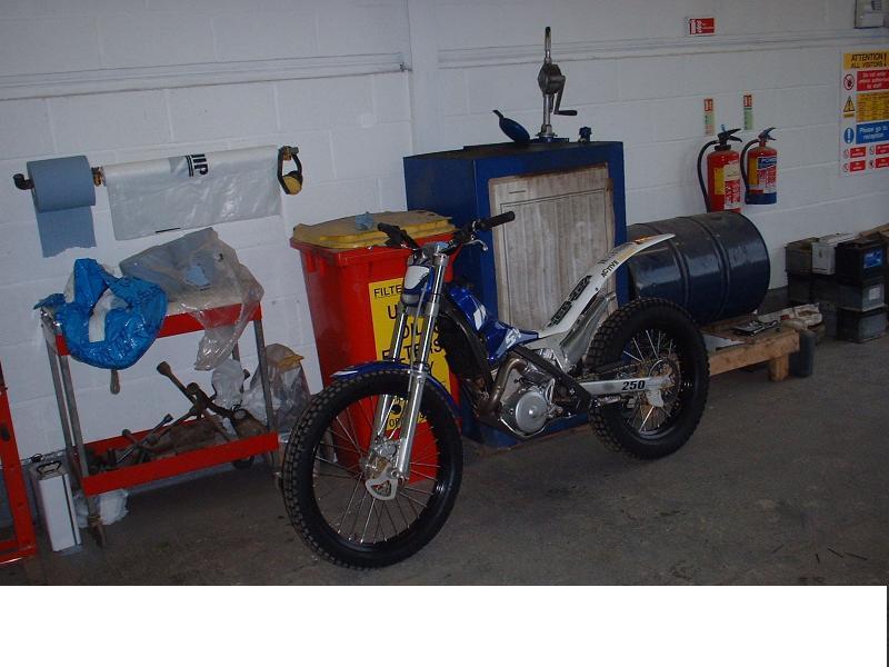

October 1, 200521 yr here you go this is my 2003 scorpa with black wheels have a look. they were done by talon Edited October 1, 200521 yr by trialsmatt
