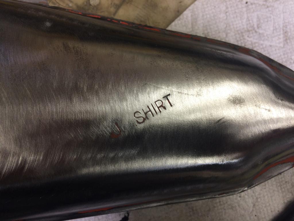

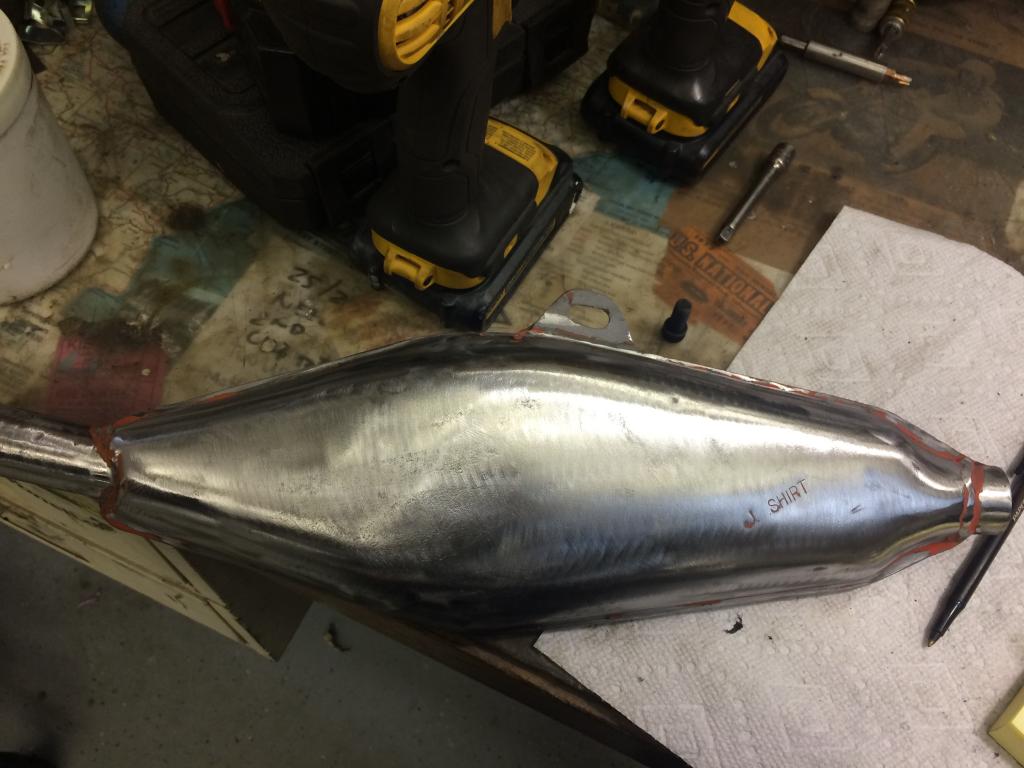

shercosteve Posted December 20, 2015 Report Share Posted December 20, 2015 Hello, Trying to learn about TY Yamaha's prepped by John Shirt in the mid 80's. I have one that I know has been in the US since 1985, I've noticed a few items that seem to be different than a stocker, Mine has John Shirt stamped in which appears to be a different style silencer than stock. Can any one tell me what John did to these bikes. Thanks, SB Link to comment Share on other sites More sharing options...
steve fracy Posted December 20, 2015 Report Share Posted December 20, 2015 I never had one of these bikes, but had my Yam mono's attempted to by copied. Exhaust port was raised, and ports cleaned up, flywheel lightened, JS silencer. My bike also had a much thinner head gasket to bump up the compression. Link to comment Share on other sites More sharing options...
ducman Posted December 20, 2015 Report Share Posted December 20, 2015 Originaly the silencer was sold in a dark orange colour.Here over in europe it was a must when you had a TY Mono back in the day 84/85. Link to comment Share on other sites More sharing options...

shercosteve Posted December 20, 2015 Author Report Share Posted December 20, 2015 Thanks for the info, I have 2 of the silencers, one which was orange in color both are stamped J Shirt. The engine does sound crisp and is very responsive, and the suspension is very good even for 30 years old. This bike was one of two Shirt Ty's brought to the US for Jack Stites to use in the US national series, in 1985. I havent had a chance to check the flywheel or the porting, for a 30 year old bike it really rides well. Thanks again, SB Link to comment Share on other sites More sharing options...

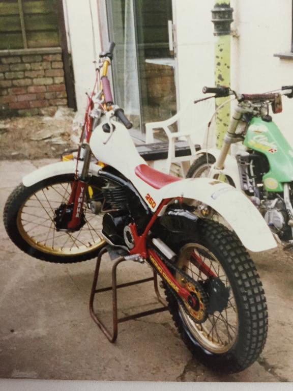

adamspad5 Posted January 2, 2016 Report Share Posted January 2, 2016 We used to have a John shirt 250 mono. It was apparently John shirt jnr's. This bike had been sleeved down to approx 183cc we were told, something to do with abiding to youth rules at the time. We did a rebuild on the engine and the piston was matched up with a Yamaha blaster 200 quad bike. Other notable changes were rear shock, front brake, exhaust silencer, one off sprocket guard. I'm sure there were probably more mods as the bike never lacked in power even with the smaller capacity. Will try and upload a picture but it was a long time ago. 1 Link to comment Share on other sites More sharing options...

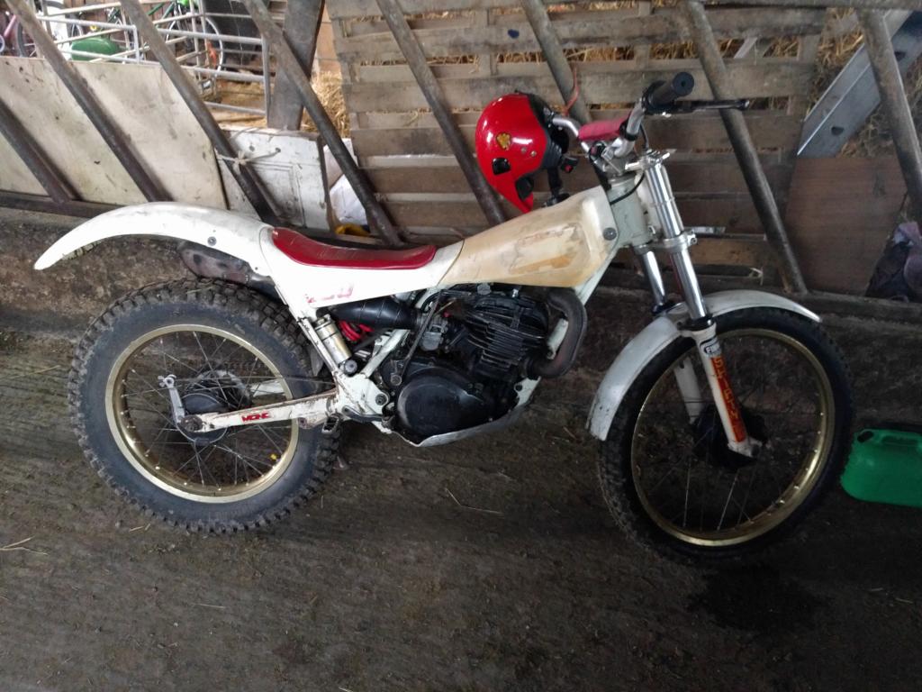

isitafox Posted August 16, 2016 Report Share Posted August 16, 2016 (edited) Bit of a bump but thought I'd post a pic of our John Shirt 250 (at least I think it's one of his). We bought it about 18 or so years ago when I used to ride and recently a friend of my dad had been riding it in a few comps but he's had it stood in his garage for the last few months. Currently just using it to bod about our farm whilst my son rides his pw but the plan is to strip it down and tidy up over the winter! Edited August 16, 2016 by isitafox Link to comment Share on other sites More sharing options...
