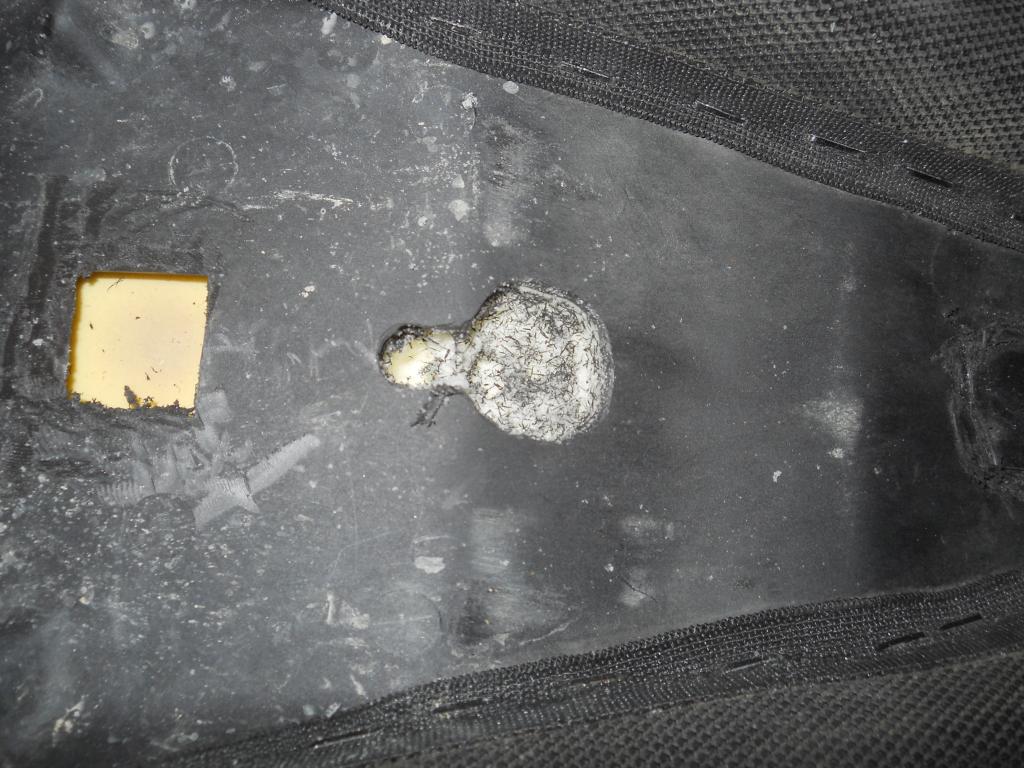

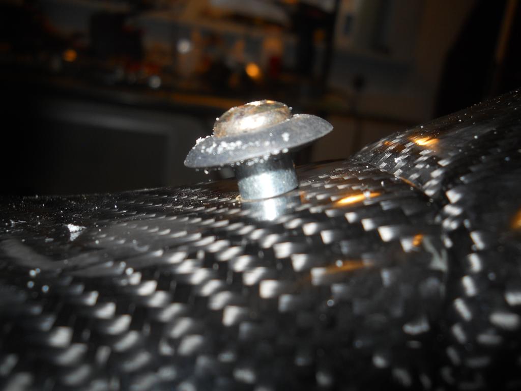

 This is how things are going with my bike ( Same way I did the Techno) , I made a * mushroom* with a small spacer and plastic washer along with a longer screw for the mount on the front of the fender, then trimmed off all the protruding  plastic from the seat base along with the rear mounting brackets, cut a * keyhole * in the appropriate location, I have to bend the seat base to get it to go on and the seat now snaps in place, it actually fits well enough that I probably dont need a mounting screw in the rear but I'll probably put one in anyway. So, one or two screws and it goes from trials to trail.

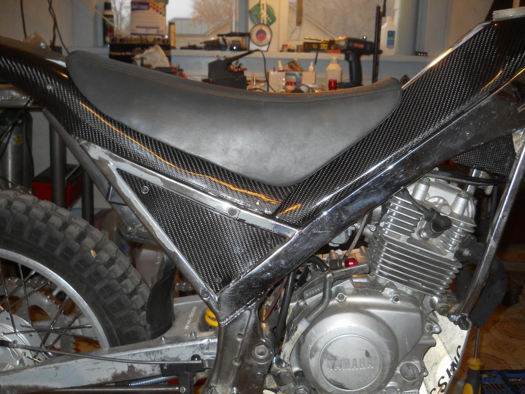

My seat arrived today, I have to say its good quality for the price!

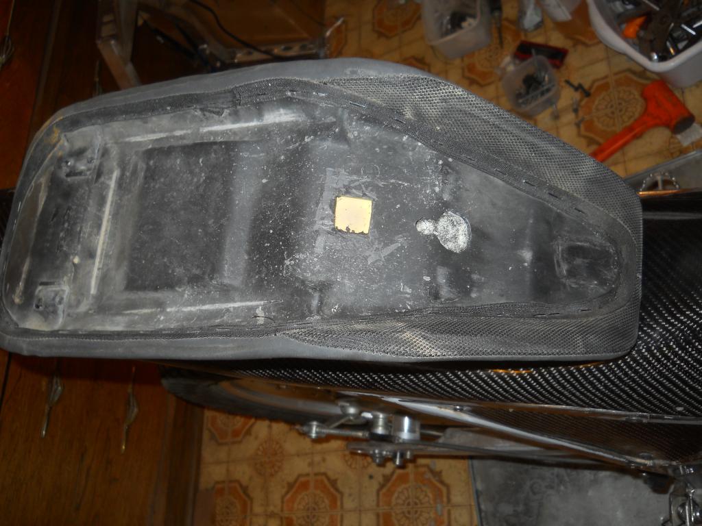

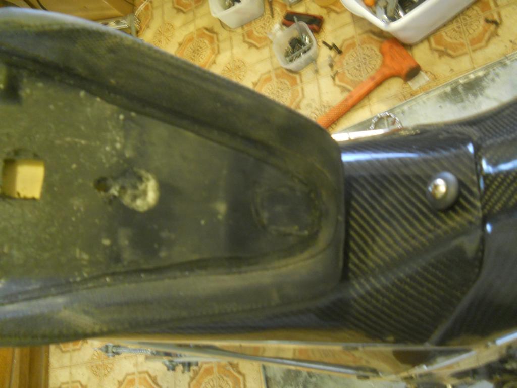

I used the same mounting method as denisesewa by cutting some plastic tabs off with a dremel and cutting a keyhole. A raised bolt was used where the plastcs attach at the front of the Beta Techno which the keyhole slid into, at the rear of the seat i had a bolt coming down from the plastic underbelly of the seat that slid through a drilled hole in the rear mudguard with a nut through the other side.
The seat is almost like its made for the Beta and looks really good without restricting movement for trials, yet is high enough to sit on the road or between sections. I had a quick look on my Gas Gas to see if it would work and it seems so, it doesnt sit as flush with the frame but still looks fine and is an okay height. I will order a second seat for my Gas Gas soon and if theres enough interest I will make a thread with a step by step guide to mounting a pitbike seat.

Here you can see the parts that needed cut out to fit the Beta:

 Good job Glynn !! kinda cool getting something for a trials bike for cheap eh?
Its a big change thats for sure! a seat for the same price as 1 Jitsie master cylinder cap
