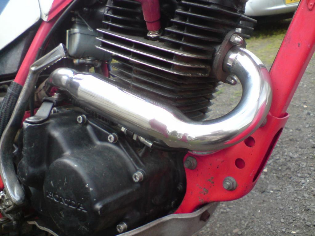

I was also thinking of getting a Shedworks cherry bomb exhaust header pipe, anyone got any experience good or bad?

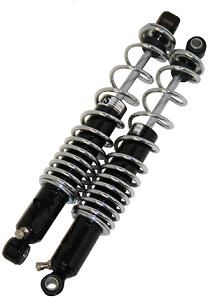

I've just put a pair of the pro's on my greeves and went for the 50's as I'm 16st so I thought I'd probably flatten the 40's
I'm 4 stone lighter, does having the shocks canted over from vertical increase the force or decrease it?
Not sure, that would be a question for the TY riders as that's a mod that gets done on the majesty conversations I think
You will probably need the 50's as the Tlr's tend to sit low at the rear, this also makes the steering head angle even more 'relaxed'
I'm similar weight to you and use 50's.
Think I would opt for Falcon or Rockshocks over the SM ones.
It's not the angle that counts. It is the leverage ratio
You need to measure two distances and divide one by the other to get the leverage ratio
distance one: distance between swingarm pivot and wheel axle centres
distance two: distance from swingarm pivot centre to centre-line of shockie (measured at 90 degrees)
If you divide distance one by distance two on a twinshock bike, you will usually get a number between 1 and 1.5
A standard 1960s Bultaco trials bike will have a number close to 1, and a 1980s trials bike will usually have a number near to 1.4
I weigh 95 kg and on my bikes that are near 1, I use 40 pound springs. On my bikes that are around 1.2, I use 50 pound springs and on my 1.4 bike, I use 60 pound springs.

I run mine on Rockshocks(390mm) and they work a treat, and you can adjust them for sag so you get more grip in muddy conditions. They can be overhauled very cheap and done by yourself. Take 20 minutes to replace the oil. I previously run NJB's and Betor and they are not in the same league.
Also you were talking about the power bomb exhaust, I have one fitted and it does give you more grunt on bottom end.
I had rockshocks on my TL 250 and my son has some on his TLR250, best shocks ever....
I you don't want to spend so much money, NJB experts are good for their price
