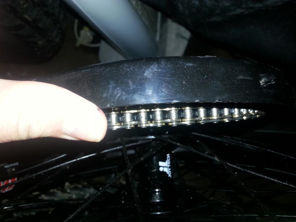

This is the set I bought http://osetbikes.com/gb/parts/chains/ bottom of page for £64.99, it all arrived in clear plastic bags with no labels.
the chain is stamped with 219 HS and on another link PR.
I've fitted it and he's ridden it and the chain has stayed on and jack is happy!!
I cant recall our chain having the same side wards movement as your video shows, I will check (the bike is kept at somewhere away from our house) and reply here.

finally got near the bike to take this picture, its show hardly any sidewards movement
