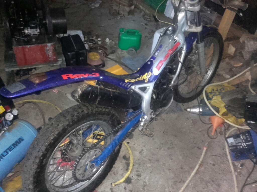

Hey. I got a Beta Rev3 from around 2002-2003- with a 250 ore 270 cc engine. It runs very well at idle , but when I speed,  it begins to shoot in the exhaust and go bad . What could this be? I have new spark plug , fresh gasoline . cleaned the carb . Im not sure if the pilot jet is correct adjusted. I did try first with 1 round, then 1,5, then 2 and then 2,5 and then 3 turns, but nothing helped.  Any tips?
Second thing, Im not sure how old this bike is, i got a frame number x ZD3B9000Y0002660 x  Anyone who can help me translate that frame number? On the engine side its written 352C/1 0 1/1. It go ta Mikuni carb

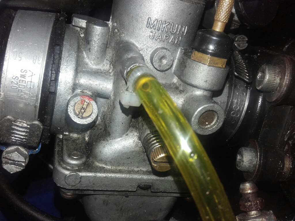

Just to be sure, The pilot yet is the little screw i mark with a red dot on the picture right ?

On the lower photo', is that a water droplet in the clear tube? Might be worth draining the tank and carb' and making sure it's nice and moisture free.
The one that's painted is your Air screw not pilot jet,normally set at between 1 1/2 to 2 1/4 turns out.The pilot jet is inside the carb,
