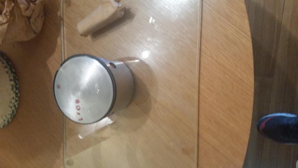

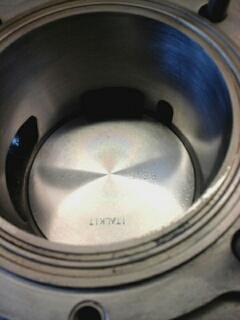

i have bought about 5 MAHLE pistons over the last 2 years i can get them but they are persang pistons need to cut the rear skirt shorter my 340 as a brand new 1 in i do have an original MAHLE piston for a 199A but theres nothing wrong with the After Market pistons ive had them and there good. This is a new piston in a 199b I just rebuilt for some 1

oh yes the port holes need to be put in as Larry says sory forgot to mention that. the guy that did mine had a special template to drill the port holes in my persang piston witch are perfect.

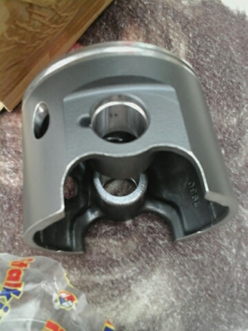

NOS Mahle pistons are best if you can get one, but I recently obtained a newish one for a M180 and the boss had to be filed out to enable the thrust washers to fit. It also did not have drilled oilways in the bosses but had off square ends instead.
