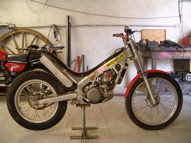

post-22464-0-75801900-1460737394_thumb.jpgpost-22464-0-75801900-1460737394_thumb.jpgHi, I post a bike/engine that I started a long time ago to collect your comments about; regards.
You need to tell a bit more about your work and choice of engine, also the weight of the finished bike (if I remember it right, the old Rotax four stroke singles are a bit on the heavy side). A bit more detailed pics of the work done to the frame would also be interesting. How does it run, compared to a well sorted 276 cc twostroke?

Hi to all, I forgot that already prepared a little description for another web-site, here's to all;
SWATTRO 315
The project started in the far 1999, when already defined the bore and stroke of modified engine,  talking to the friend Angelo ‘Mick’ Pensini I confided my purposes, he told me: ‘….stop!, I provide you the bike for this purpose….’ and him provide me a Cota 315R factory….from this work arisen three bikes, the first with modified frame in the 2001, the second with minimal frame modifications in the 2002, both bikes tested on italian motocross magazine and on phototrial in the 2003(* Cota 315 4 stroke); the third bike with fuel injection was born in the 2006….but this is another story….
After what described above and other projects after (professional and trials….) imposed a stop on the shopfloor bench of this engine up to 2012 when started the first merry-up of the engine on the SWM frame not modified that allow me the first test of the engine with good results but the original frame doesn’t allow the easy tuning of the engine, therefore I modified three frames for better handling of the engine accessory (i.e. carburettor….).
The first frame is on the photos, and the second and third have other minimal differences.

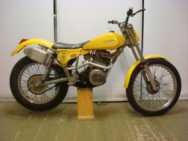

Cota 315 4 stroke

Superb work Marco  :thumbup:  :thumbup:
I think some of the Trials Central guys would be interested in your SWM mono, have you still got it ?
Best regards
Martin
Best regards
Martin
Hi Martin thank you for your opinion, yes I still got the swm mono; I'll post it asap.
Best regards.
Marco

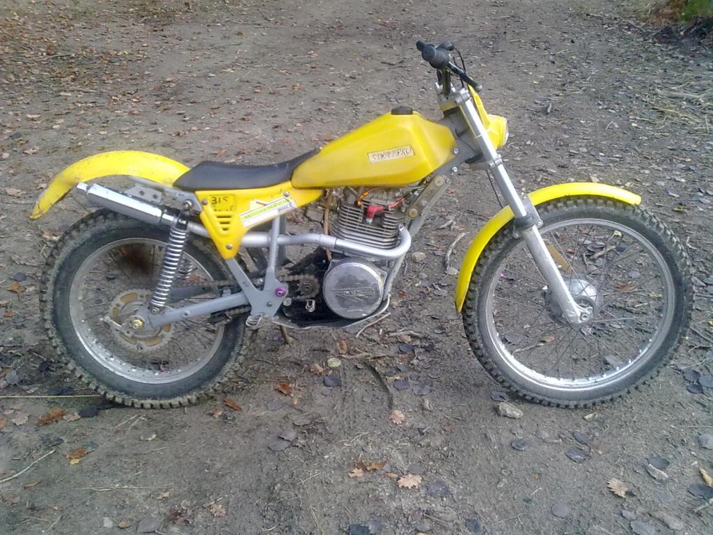

The exhaust pipe is very long, compared to other four-strokes did you try to mount the center box instead of the rear muffler, or is the bike then too loud?
Hi, I try to explain the reasons of the very long exaust pipe:
-I want use the genuine silencer
-I must use a '80 carburettor (and not a injection....)
-I want a excellent range of RPM (the engine runs well up to 12000....wide cam axle....low bottom end torque)
-I want a high bottom end torque by very long (and little diameter....) exaust pipe
I tested the engine whith absorbion silencer but the loud is like a CRF....
here you are the absorbion silencer version.
thank you for your opinion, regards.
