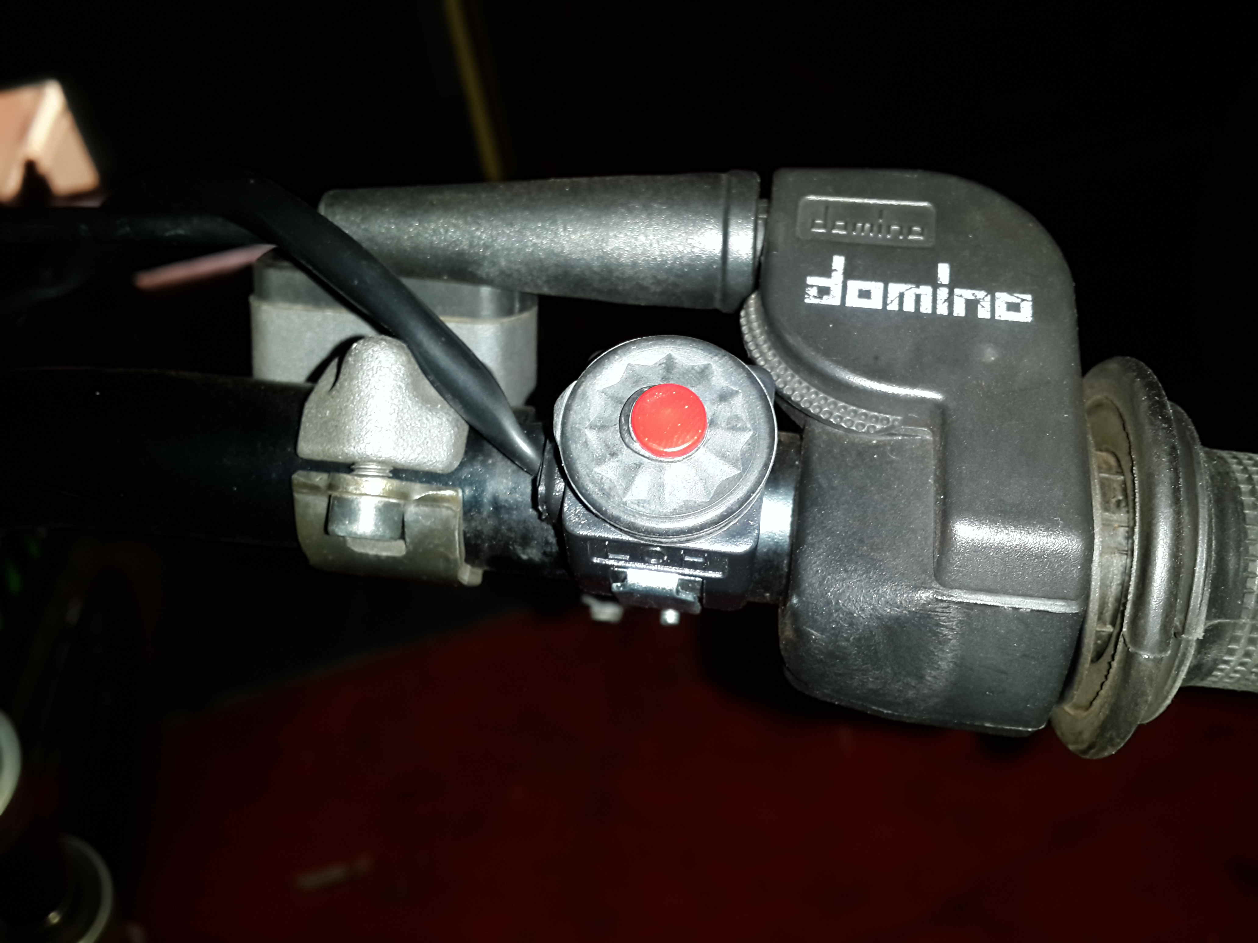

Momentary switch

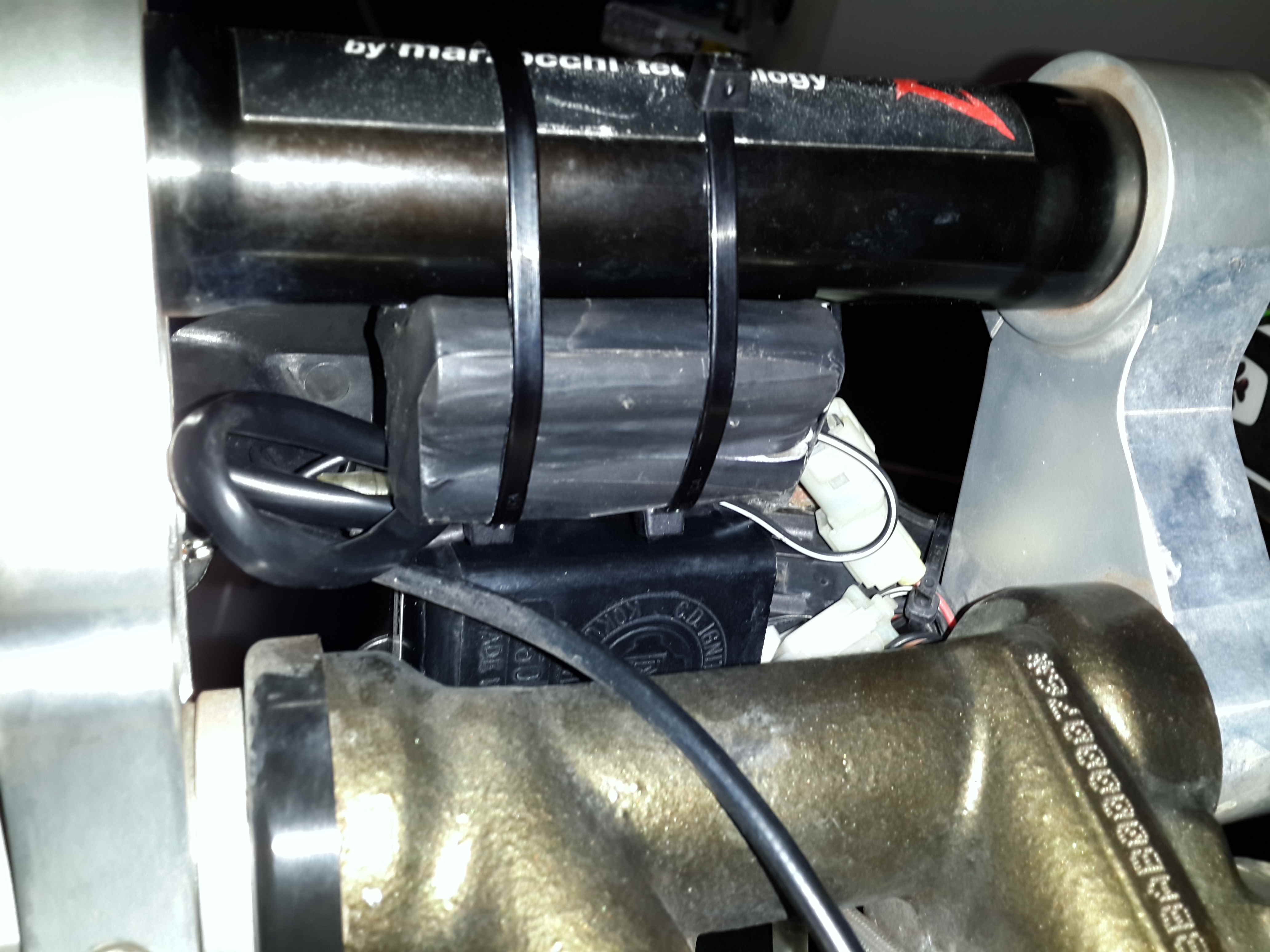

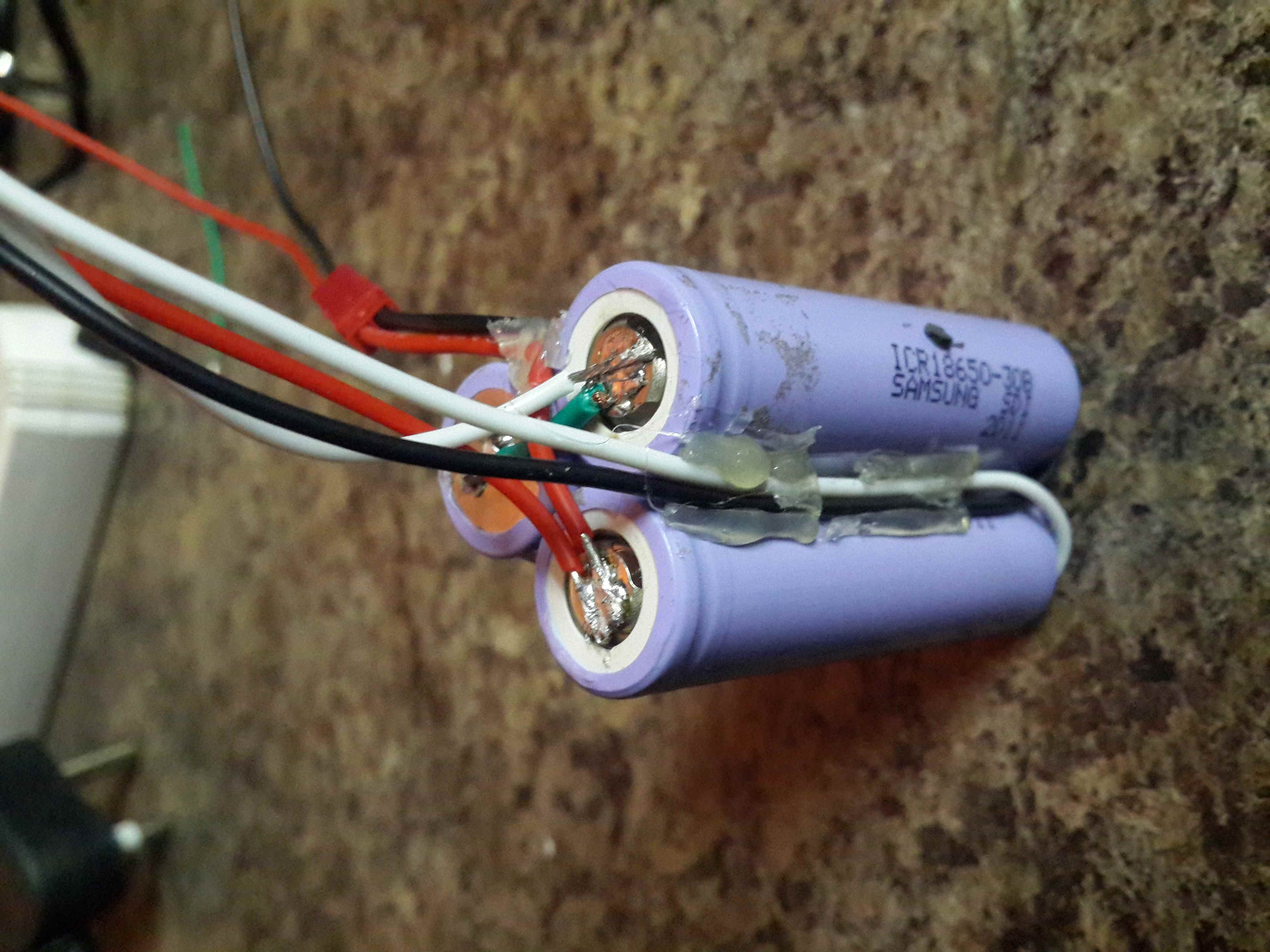

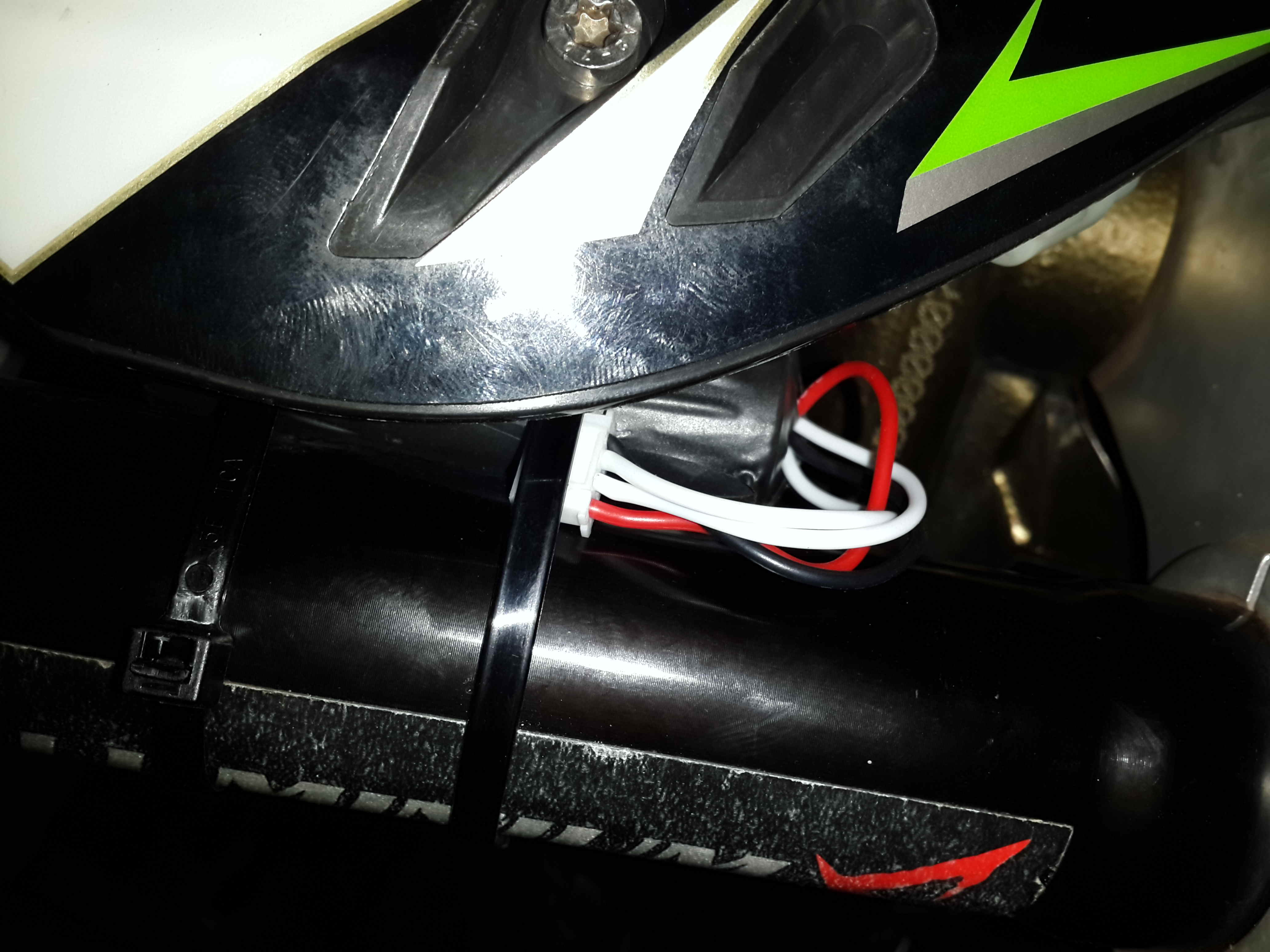

    I installed my 'Super Easy Start' on my 'new' 2014 Factory 300 R.
the little battery is strapped along side the Capacitor behind the headlamp-
+ from the battery goes to the button on the handlebar- other end of the switch goes back down, then to the diagnostics port.
- from the battery goes right to the diagnostics port.
No charging or anything, only works while holding the momentary button down.
This bike started for me pretty easily, but I like the potential trailside troubleshooting capabilities, MUCH easier starting if I were to run out of fuel and easier starting if I don't give it a good kick.

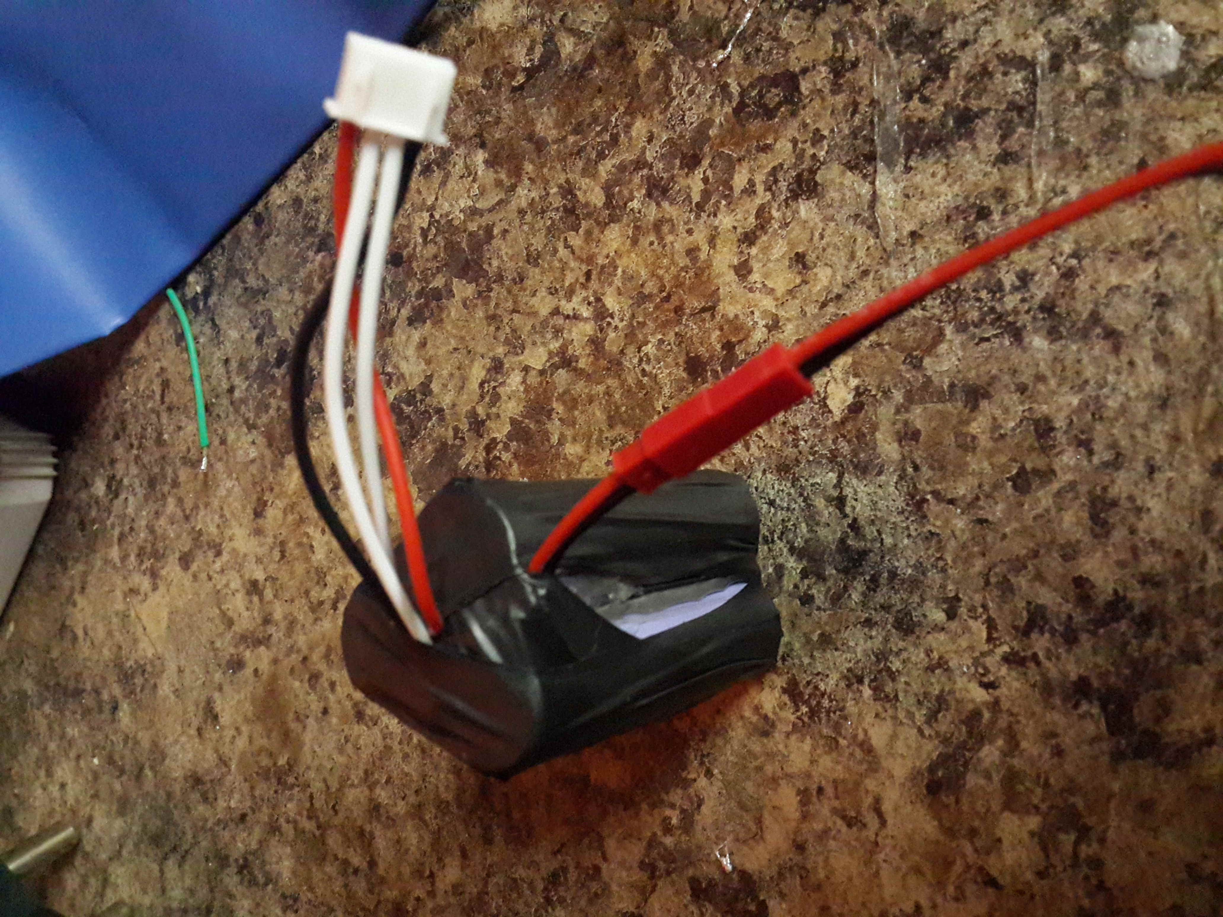

I made a very basic block diagram for the 'Super Easy Start'.
 I'll take some pics on the Factory 300 and where I put the battery etc. If I could find a decent source for the connectors, I could make these up ready to plug in.
Ask any questions- I'll get the battery I'm using also. I only rarely charge it, since it only has a draw when the button is held down, it lasts a very long time.

I did roughly the same on my 2012. Built a 12v battery using cells from an old laptop battery. Killswitch button to activate it. Chargecontroller pluggy for recharging.

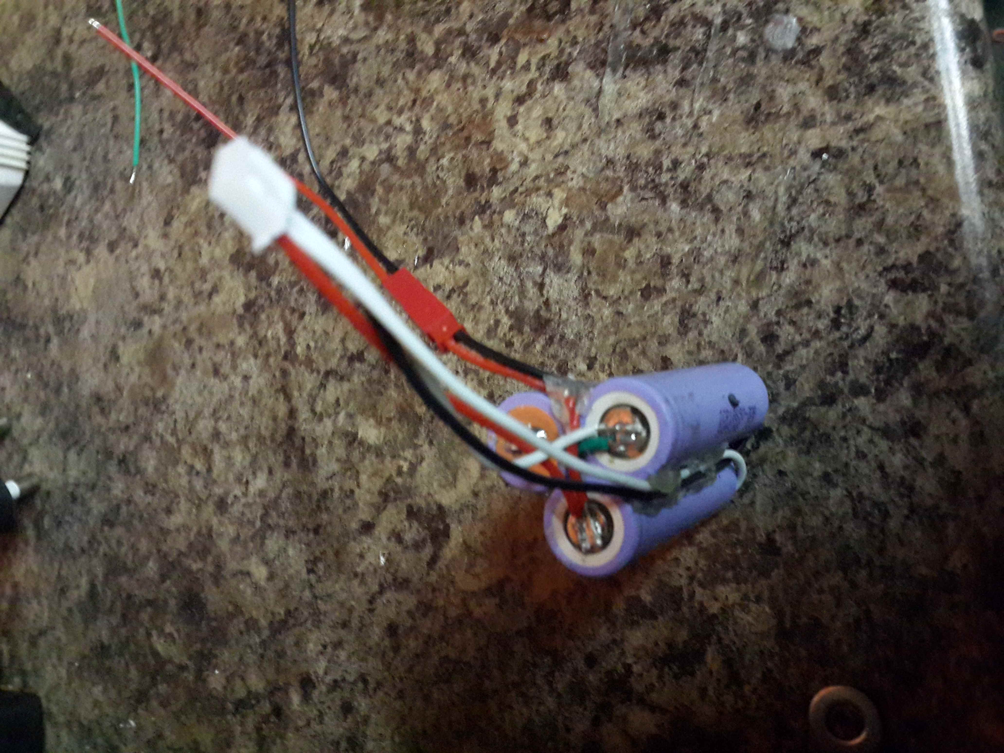

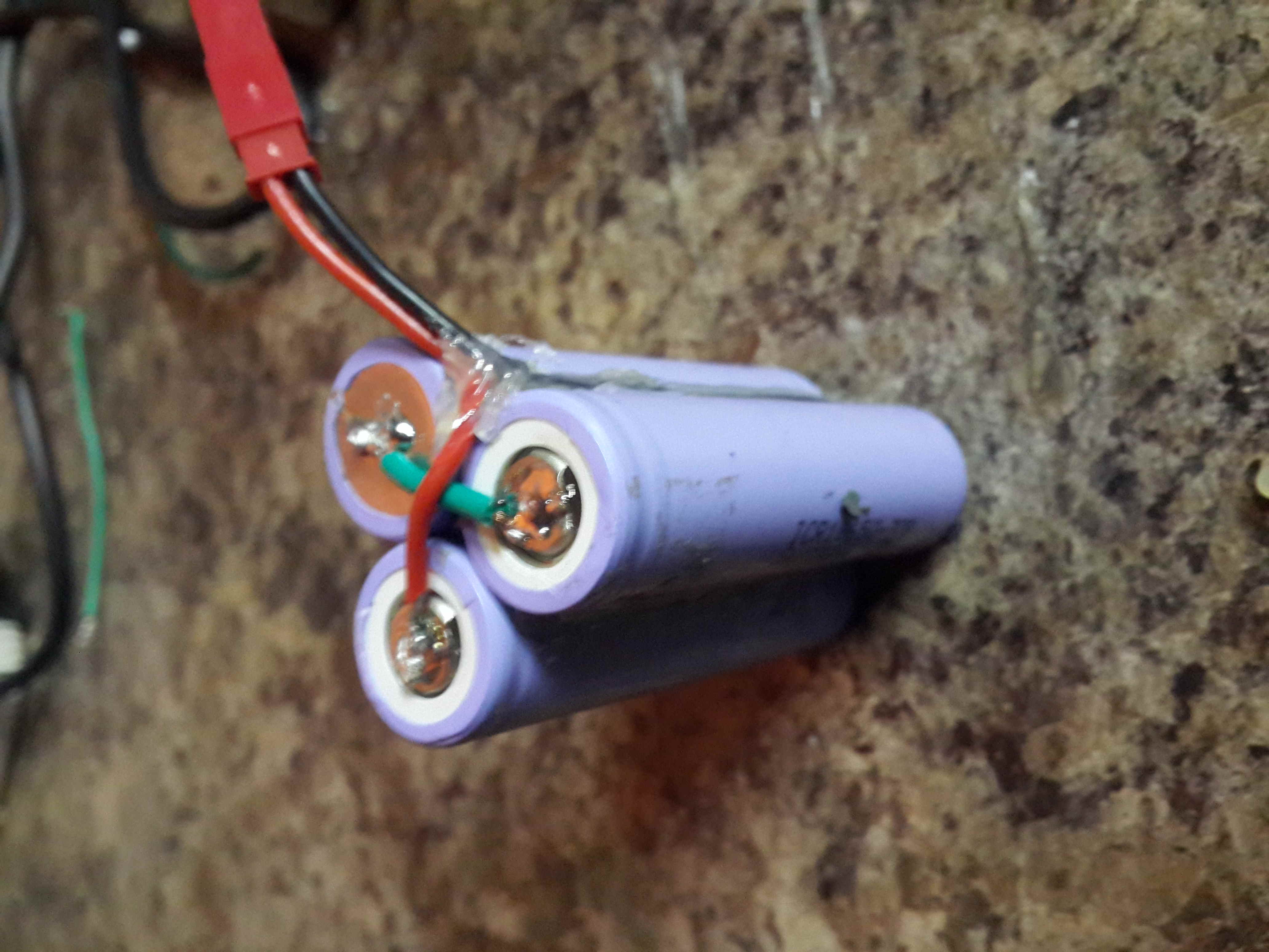

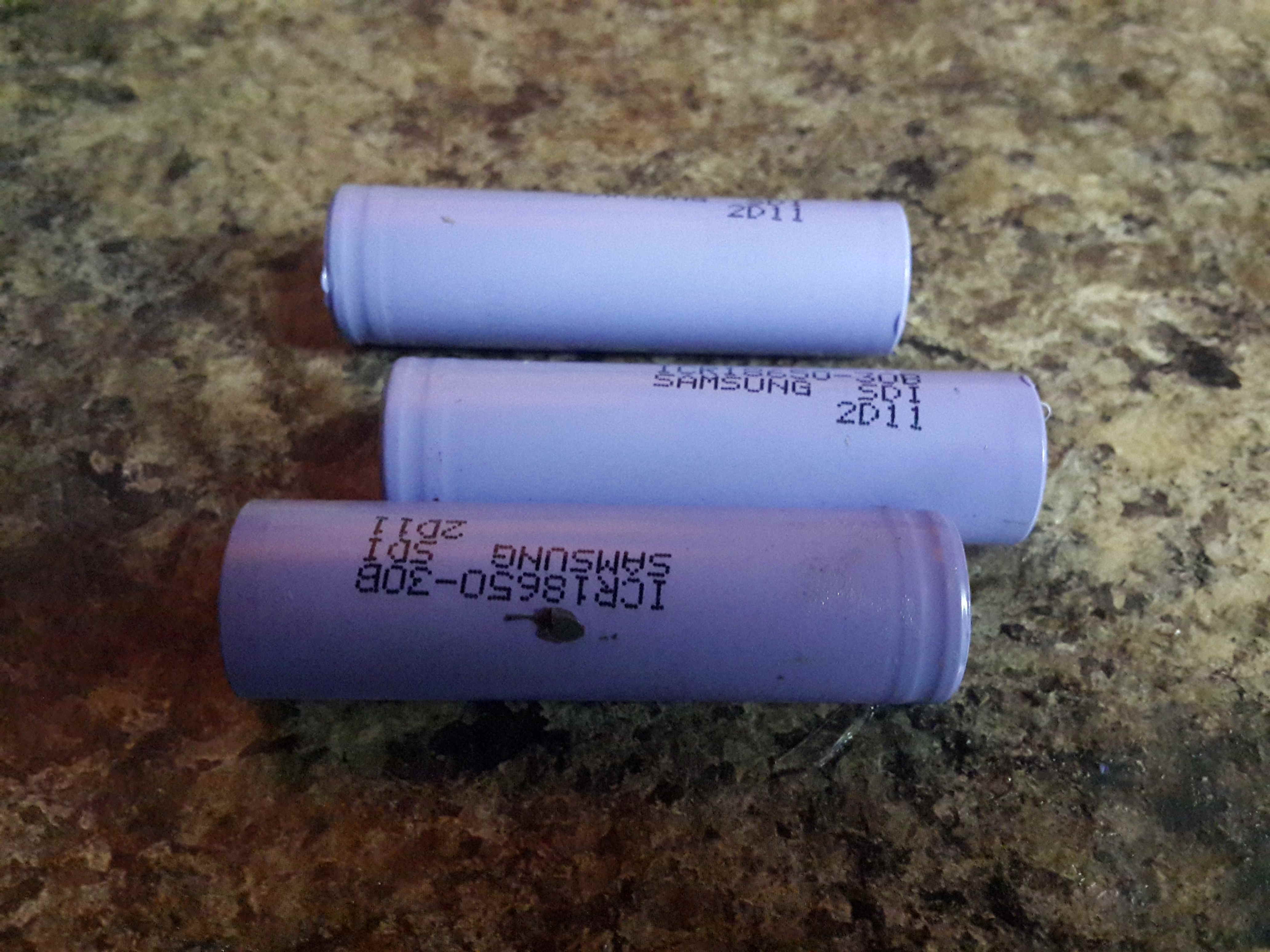

Noticed Mark used 3 lithium-ion cells.  These have a nominal cell voltage of 3.6 to 3.7 (a 3-cell series pack gives 10.8 to 11.1 V).
I used a different battery chemistry (lithium-iron-phosphate) which has a nominal cell voltage of 3 to 3.4 (a 4-cell series pack gives 12 to 13.6 V).
The advantage of LiFePO4 is that it may be charged directly from the OSSA's electrical system.
Edited by konrad
Thank you konrad! I will order some lifepo4 cells. I like the recharging capabilities. Any thoughts on mah? 4 x 400mah should be plenty?
I used IRF18650 cells rated at 1100 mAh.  It's certainly possible you could get by with less, I did not do an analysis.

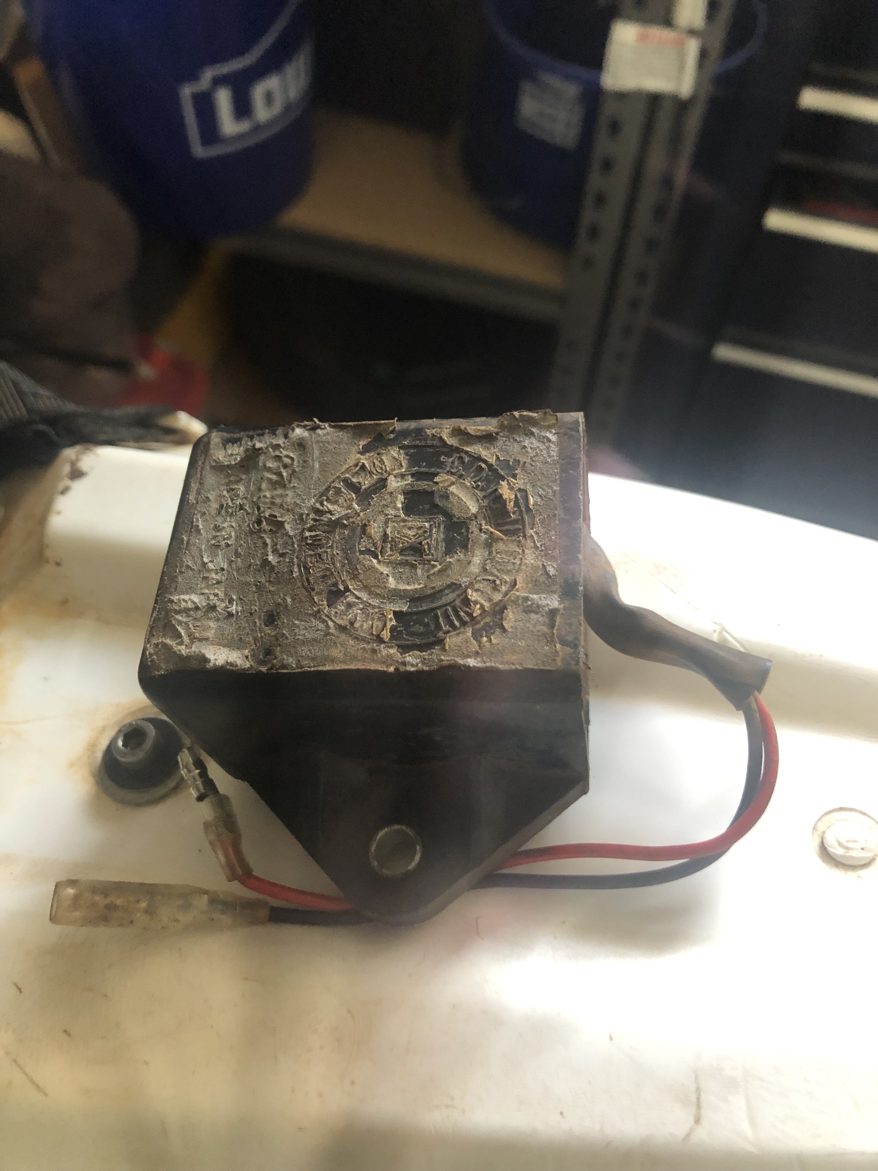

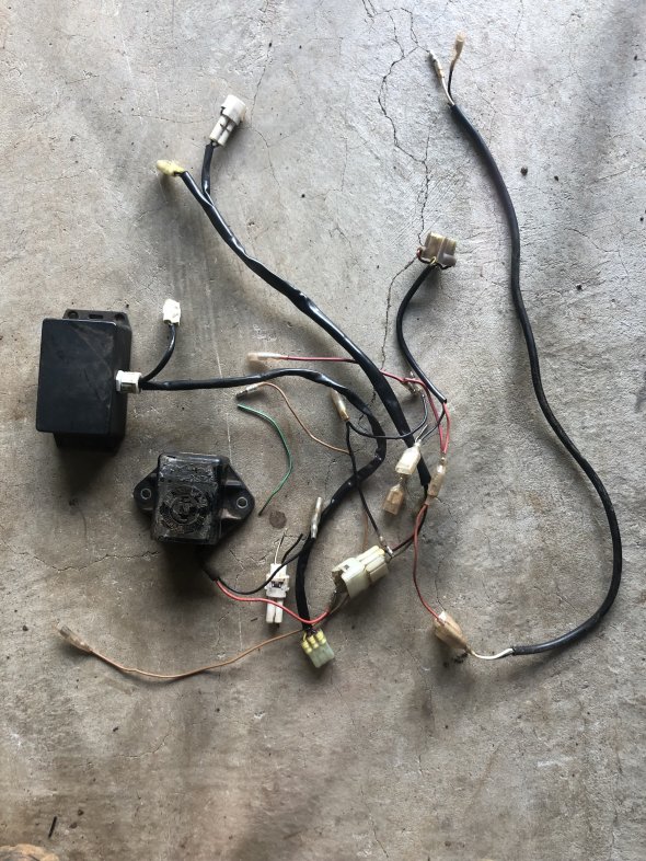

So I cleaned up the wiring on my bike and removed the existing easy start with the AA battery. As a a result I was able to remove a mile of stray wiring (don't need headlight nor horn) and a dozen connectors.  I also removed the small black box marked "CDI Ignition" which has 2 wires going to it.  Is this part of the easy start retrofit?  The bike runs perfectly without it.  Also would anyone advise from not re-installing the small storage box under the seat?  Yes, I am an OCD minimalist!  Saves 4 ounces! Thanks!
That's the filter capacitor.  Because you removed the Easy-start, I would not remove the filter capacitor.  It's possible the life of the ECU and fan could be shortened without it.
Holy crap. I hope I can remember how it was wired! Here is all what I removed!
