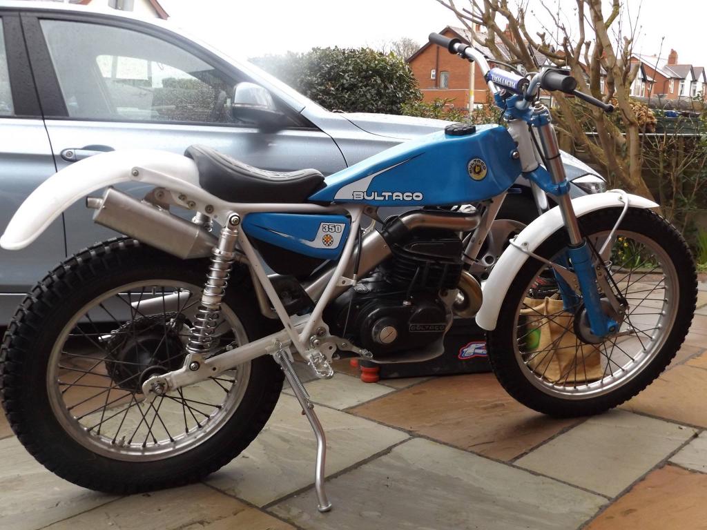

Hey model 80 - I Just got some 90 and 45 degree bends off eBay in thin wall stainless dairy tube, cut up with an angle grinder and got my old man to weld the lot up.
Weighs a bit more than original front pipe as the tube is a little thicker but overall the whole system is about 2kgs lighter from memory.
Another couple of pics attached...
Thats a neat job you've done there. Toying with the same idea.

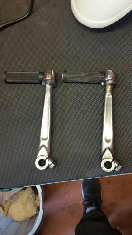

It looks like one Sammy Miller used to sell in the 1980's.
It's one of the alloy DOA ones, made back in the day.
those kick starts are rare i was Lucky to get 1 also the tear drop kick start .post-12321-0-39268500-1469904205_thumb.jpg
