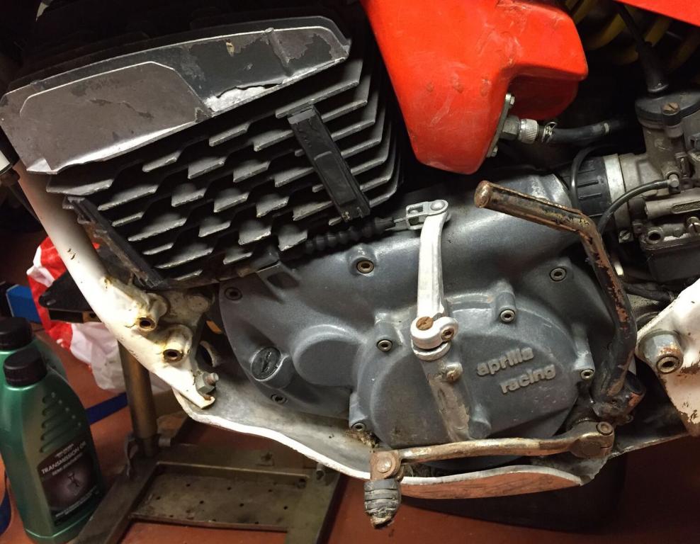

OK, I dug Speedy out of her hibernation and couldn't free off the clutch, no matter what I did.
Next weekend tried again and finally got her to free off but with terrible clutch drag.
So yesterday (these things take time!) I stripped the clutch down and my gearbox oil was contaminated with water (again) looking for all purposes like she had done a head gasket - as if watercooled - she was that bad. Seems to be a recurring theme with the old girl I can only assume water is getting in past the clutch cable entry point.
I have been using 10/40 engine with good results....gave me less drag than ATF....which seems counter intuitive?
I have always had a problem with too much slack in the clutch cable, to the point that I had run out of adjustment at the clutch perch. I have a cable from Martin ready to fit so hopefully this will be OK now?
Her last owner has done the clutch actuating arm mod...extending it....she also runs all the springs and has never had a heavy clutch.
I have roughed up the steel plates on a machine mounted rotary wire brush then further roughed them up with 80 grit. It has occured to me why trials bikes don't use MX style steels whereby the surface has oodles of indents to stop the 'sticking' action.
I seem to remember changing out the steels on my Montesa 315R to MX CR 125 ones and this cured the sticky clutch on that old barge.
Maybe I should spend an afternoon in front on the TV with my 'Snide Stick' watching old Minder's with a centre punch stamping hundreds of little holes in the steels, but then I suppose they would dressing by a surface grinder to take the high spots off...?
I've rough up (gently) the friction plates and cleaned up the oil drain slots.
I'm just about to dive into the actuator assembly itself, any tips on what to do or look for here...I hear and read of owners exchanging views about the size their balls & don't wish to feel erm....undersized ;)

I've given up for today, the new cable is still too long...not overall length but too much free inner cable. I don't have enough adjustment at the clutch perch to take out the slack....I'm wondering if I have something missing at the clutch cover end? My cable sits deep in the cover with no other fittings....should the be another adjuster at the clutch cover end?
There is an adjuster at the spindle of the inner clutchlever. With this screw you can adjust the clutch.
To do so you have to unthighten the security nut for which you need the little nut wrench from Rotax.
To get to the adjuster screw and secure nut you just have to unscrew the rear plastic plug of the clutch case.
Don't forget to rethighten the secure nut properly after adjusting the screw. Mostly you have to hold the adjusting screw with a screwdriver whilst thighten the secure nut and all this happens inside ... wrist clock mechanics ...
The actuator adjustment is not a problem....is this slack in the cable.two cables same issue....strange.

thanks for the reply. The clutch cable that came with the bike is a Venhill, the new replacement that I have had for over a year, now as a spare, is from Martin @ SWM Moto...which makes me think that something somewhere isn't right with my bike....but what I don't know?
When I rebuilt Speedy a couple of years ago, I had to raise the 'outer cable' out of the 'clutch-cover-cable-entry-hole' by some 10mm by inserting a fitting I made up. This meant I now had some spare adjustment left at the clutch lever perch.....if that makes sense? So thinking about things my cable out is around 20mm too long on both cables.
The clutch actuating arm is fine (not breaking/broken) as are the rest of the mechanicals in there....it's as if the cable entry hole in the clutch cover is simply too deep....... :unsure:
Edited by iconic558
I'm just getting my head in a fizz here....
....would an incorrect cable route cause this problem?...it can't do can it?...no matter what the route the cables relationship to the inner and outer is the same and wouldn't effect the cable inners length...?
Depth of clutch cover cable entry hole is 14mm....so that can't the problem if I'm looking for 20mm
