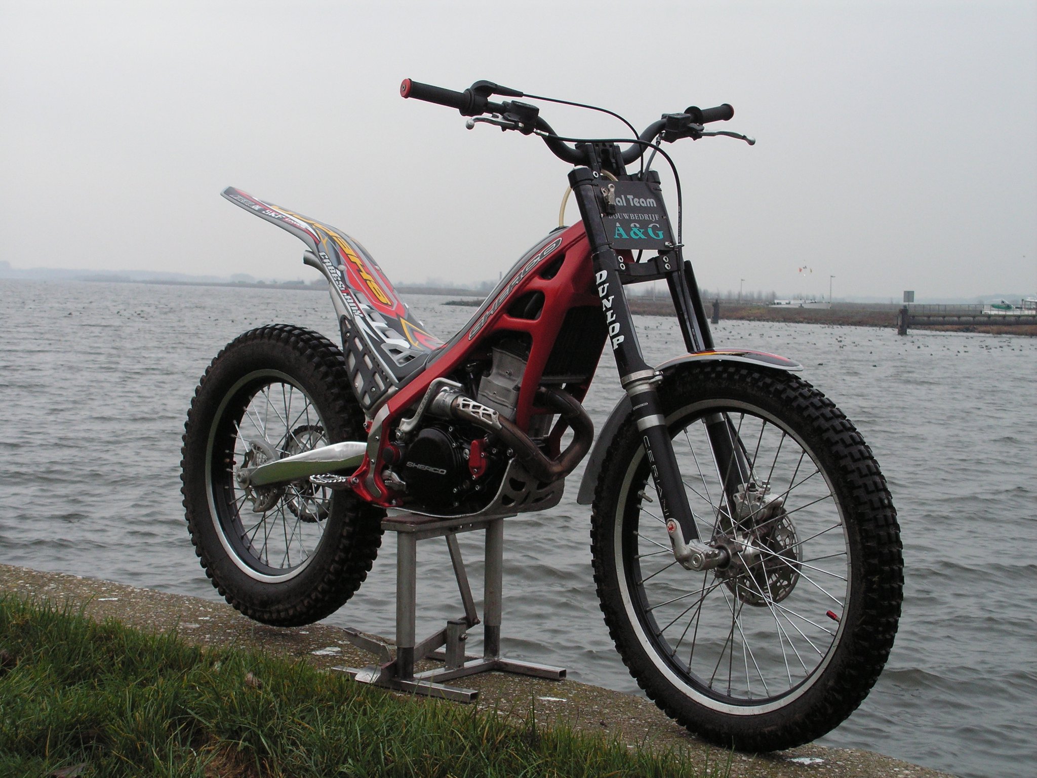

Cool to see your blog. This is my old bike, good to see it's still alive.
Owned it between 2008 - 2010. (It's a 2008 model, not 2009 btw) If you want any info about it, just ask. The bike has quite some history and did back then a lot of small mods to improve the bike.
Edit: Yes, I changed the carb after a few months to a sps version. Trottle response is so much better with the SPS carb, compared to the normal version.
Edited by lars1990
What can I say? Welcome! It's a small, small world.
Thanks for acknowledging the model year! We were right after all about the SPS mods.
So far no questions. I'm going steady but slow. No need to rush.
Received the M31x1 machine tap. Looks like a good quality item.
Good luck! This is how the motorcycle looked like in 2008:
That's a real bonus! Thanks!
Seeing that pic, I just know I'm gonna curse the day that engine has to get back in the frame....It's a tight squeeze.
