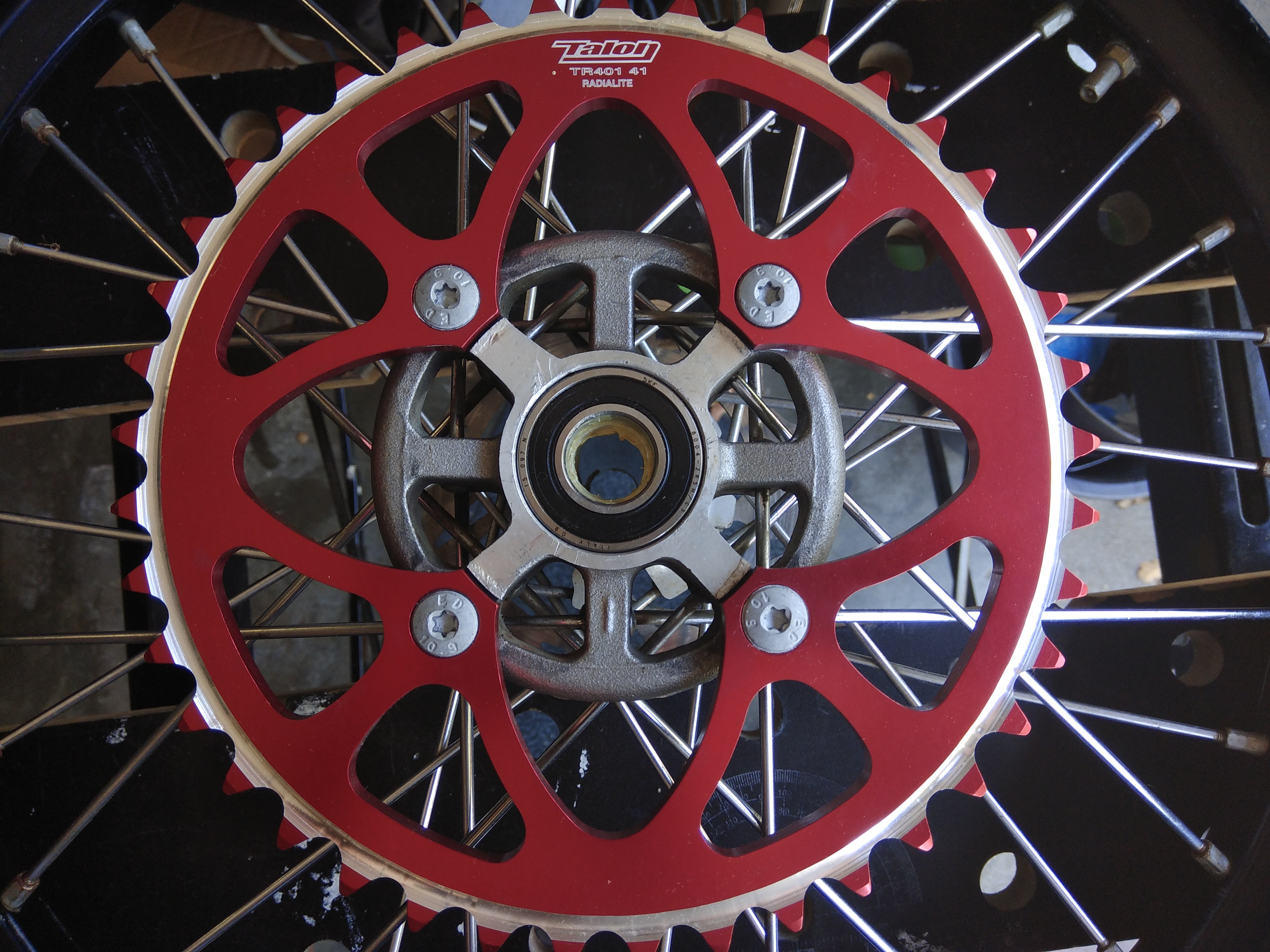

Got the new bearings in, as well as the new rear hub spacer. The old one had several deep dents from the axle. Just shows what this bike has endured. It also explained the large play of the rear wheel, despite the previous owner having replaced the bearings.

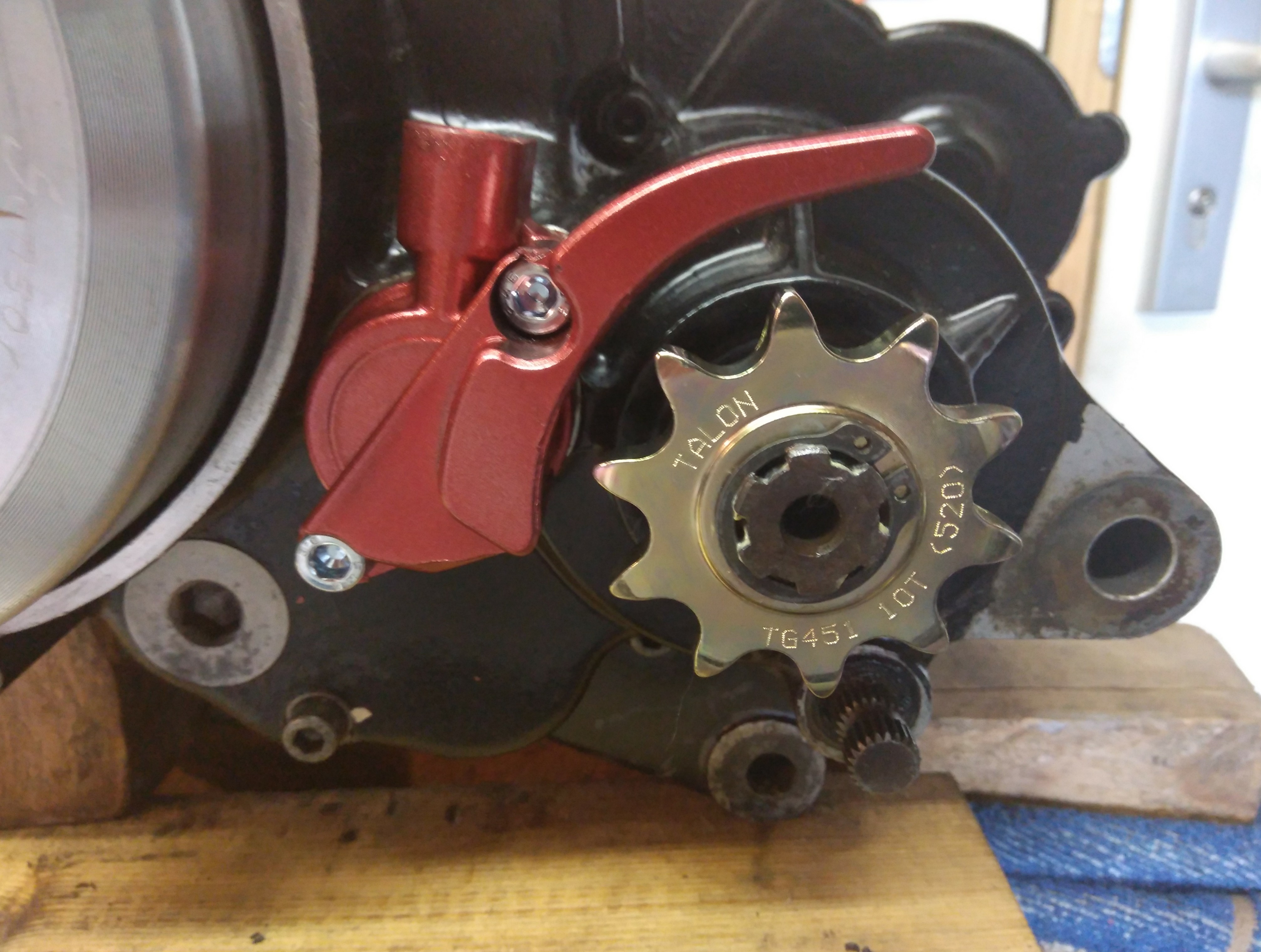

Mounted a new red anodized rear sprocket with 41 teeth. Used new sprocket bolts, since it came with non fitting countersink bolts. New nyloc nuts on the back.
On the front, a new 10T sprocket.

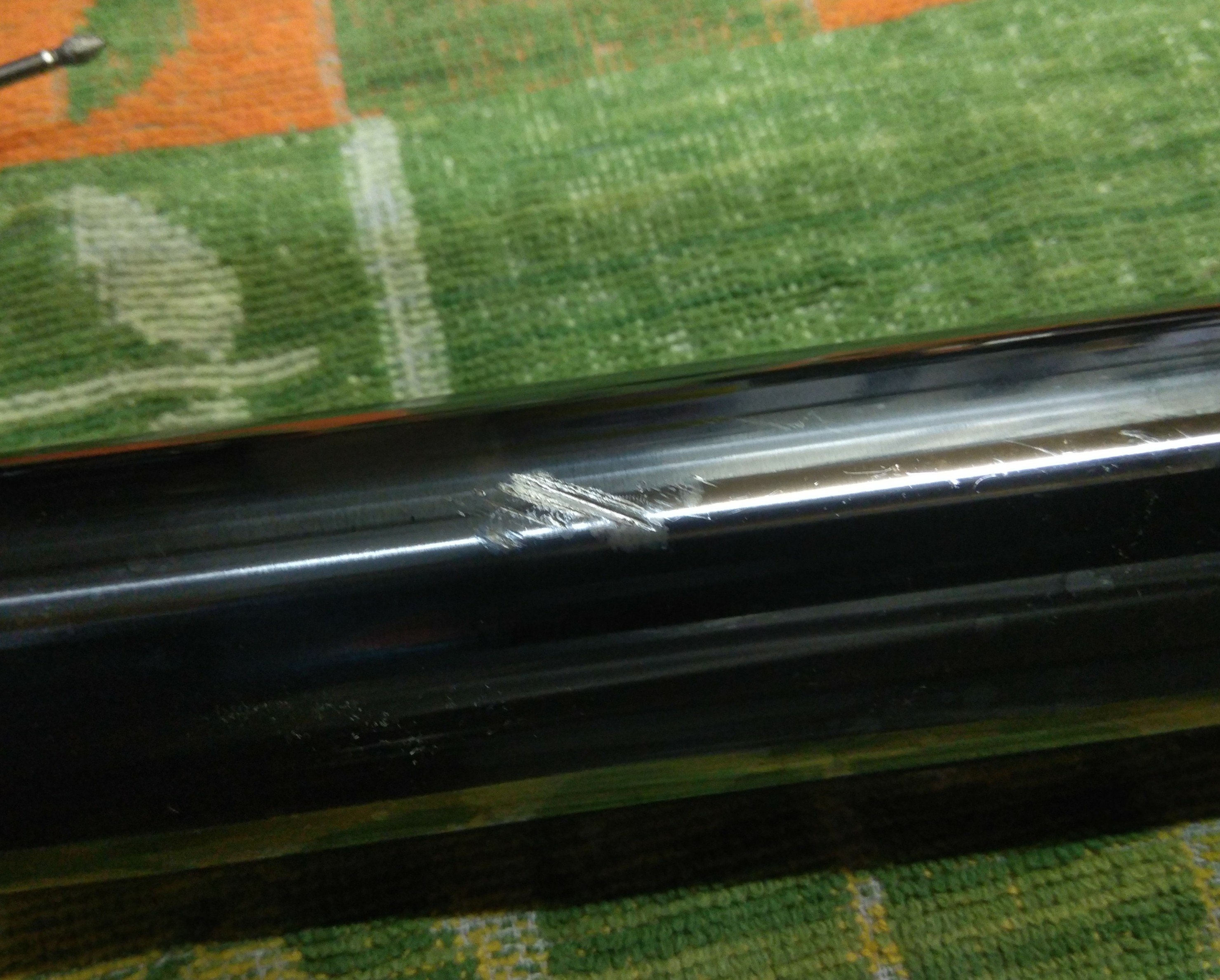

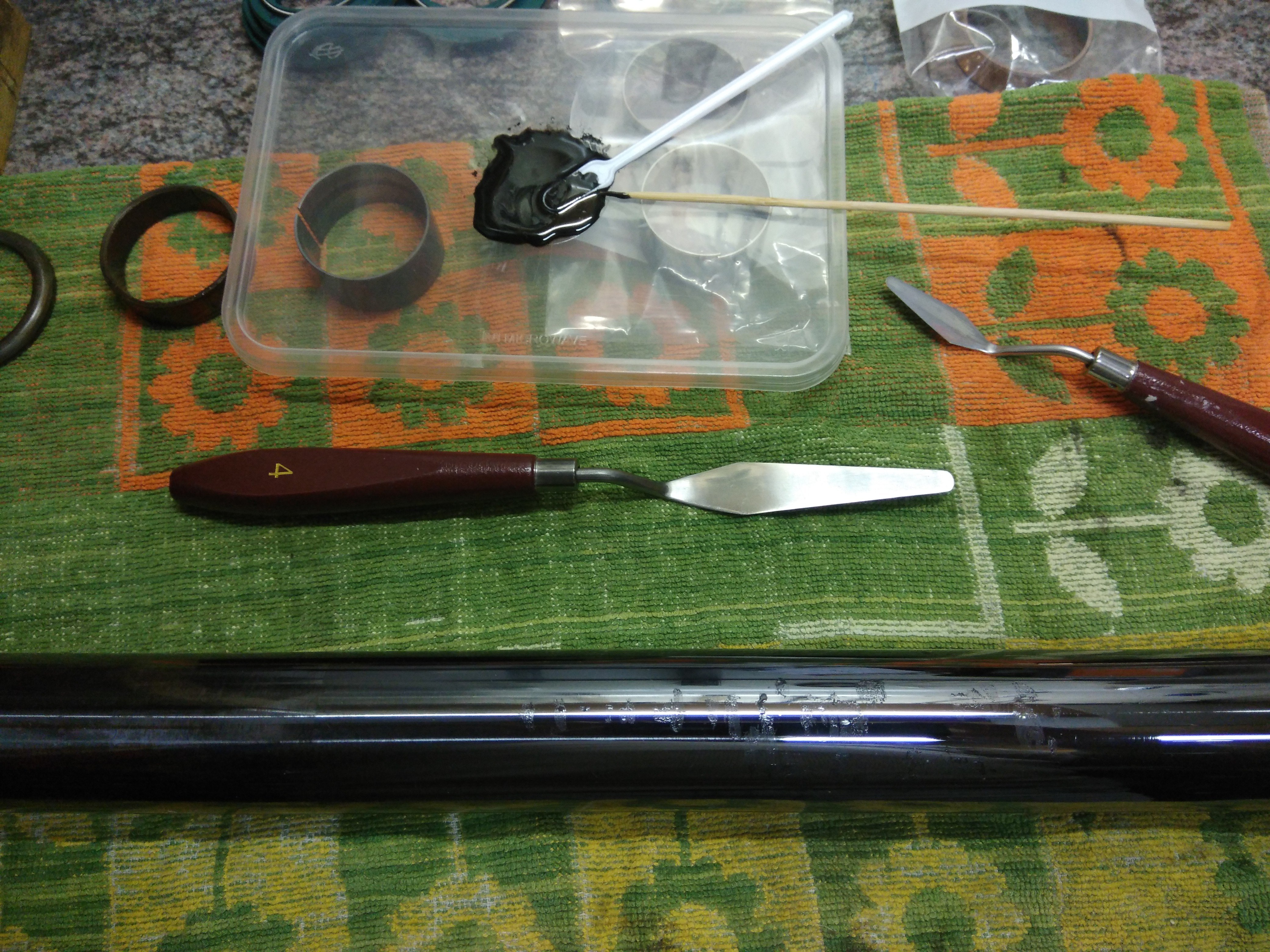

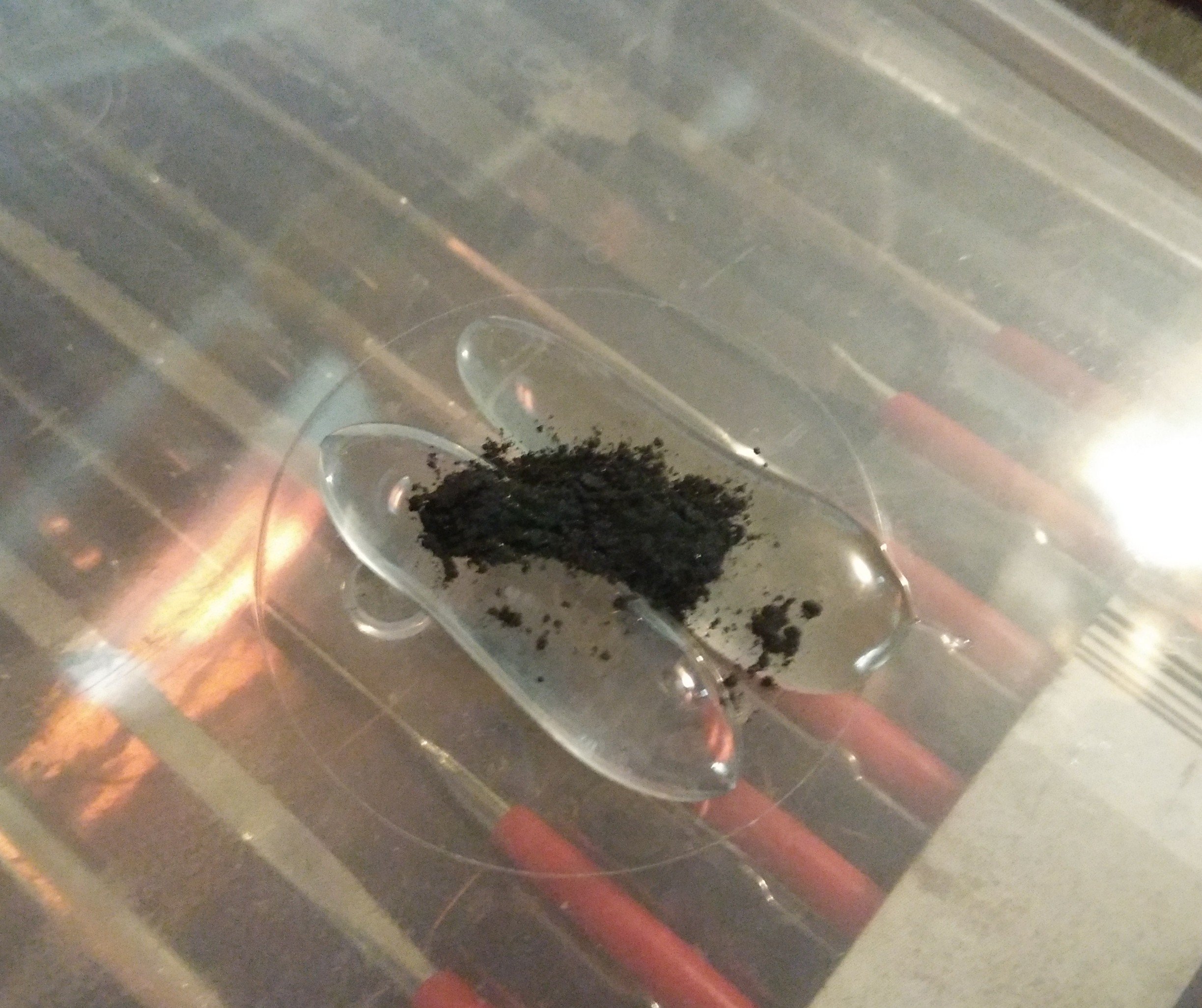

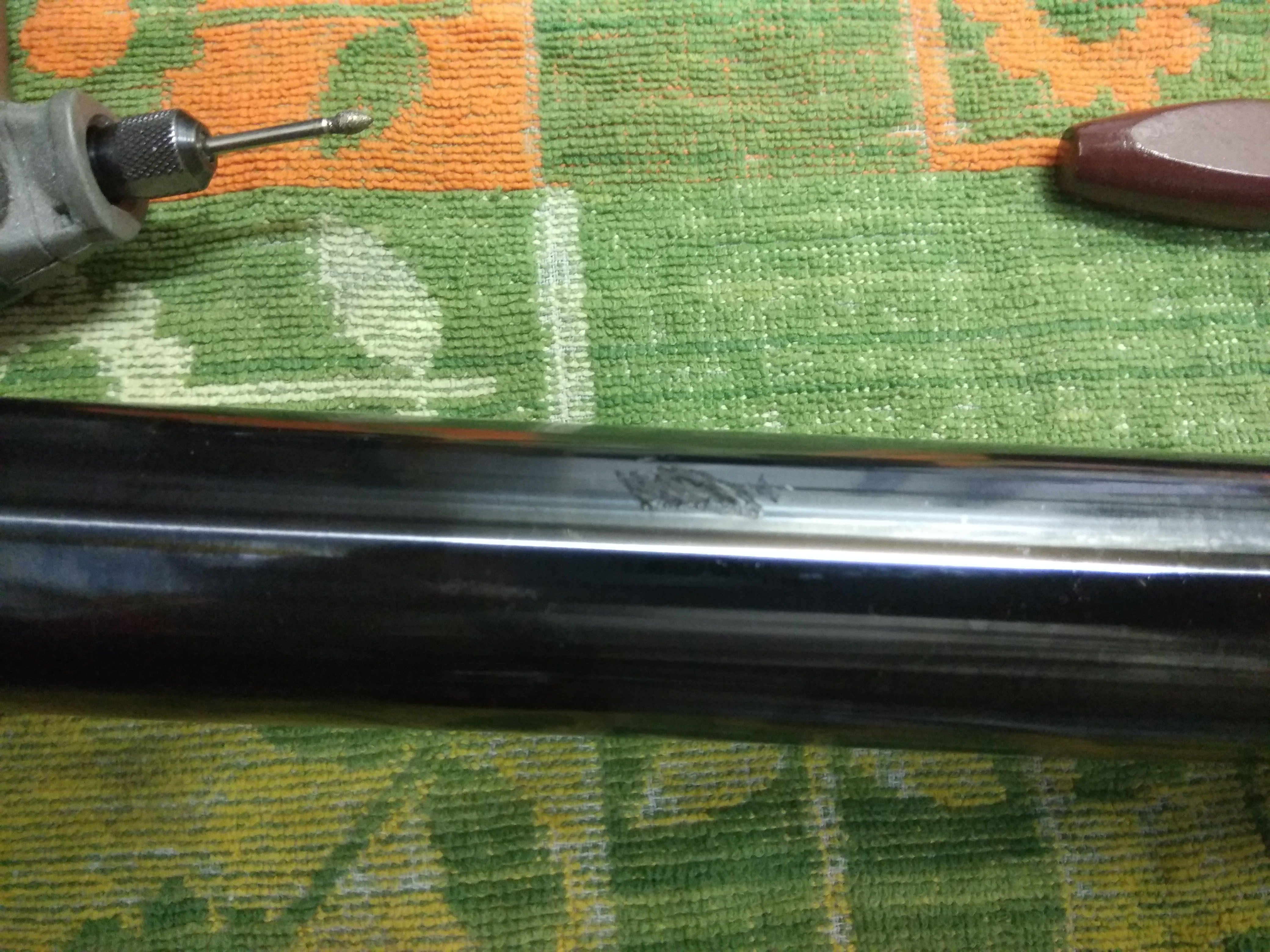

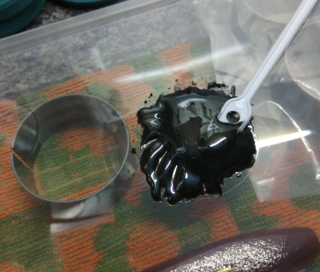

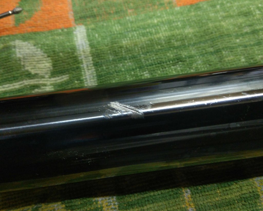

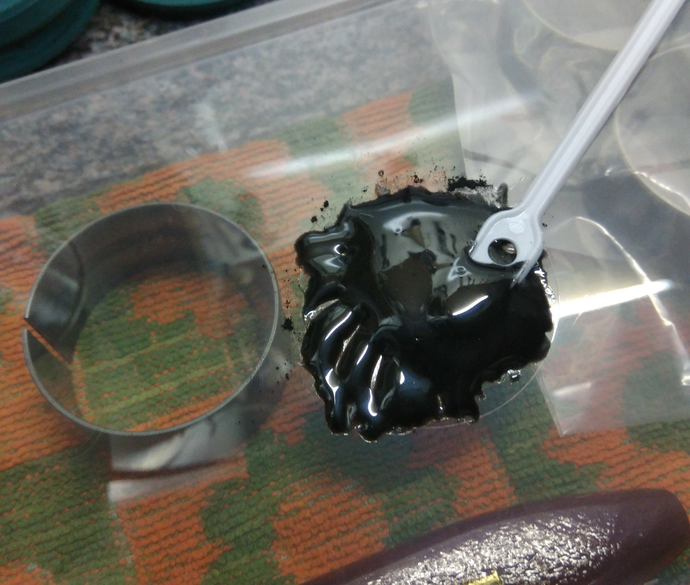

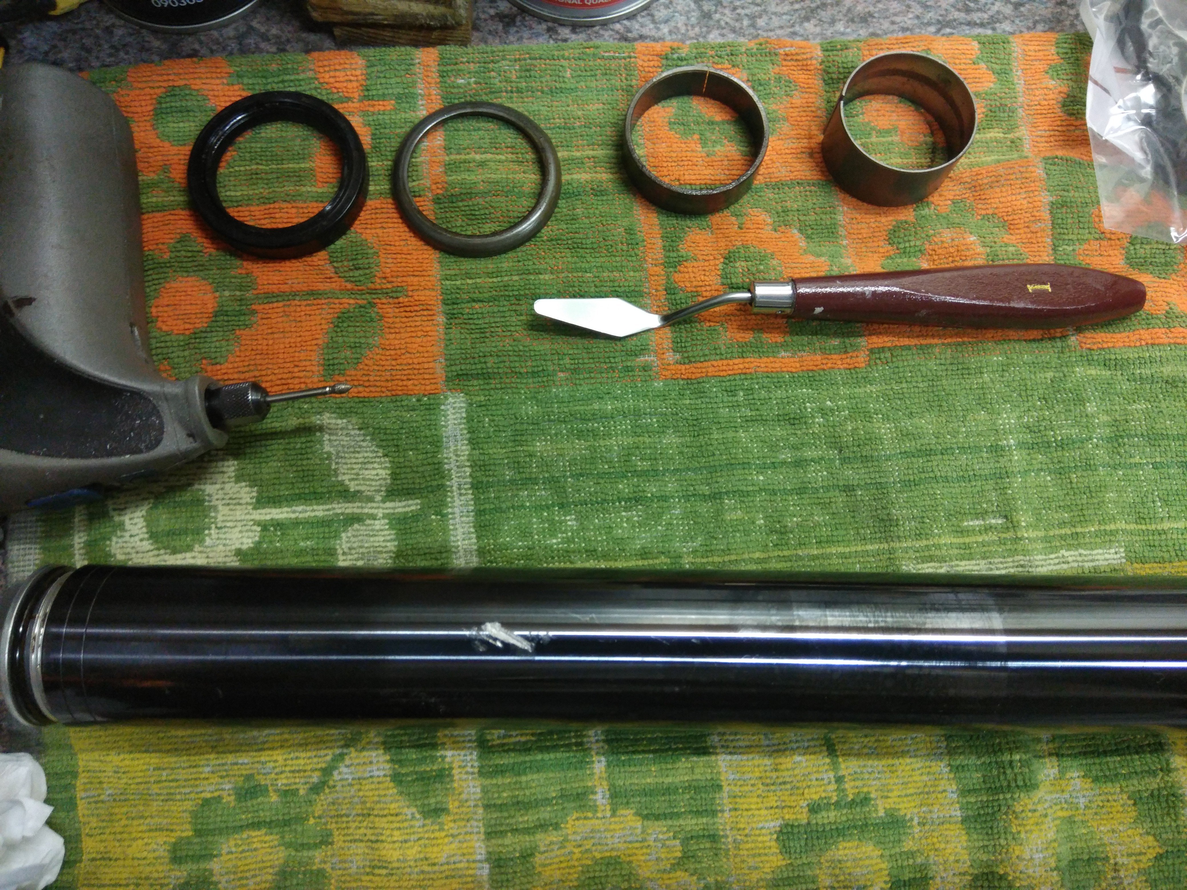

Took the forks apart, heavy pitting and deep scratching on the black diamond coated tubes. Filled all the damage with black epoxy, will try to sand it smooth without damaging the black coating. Fingers crossed.

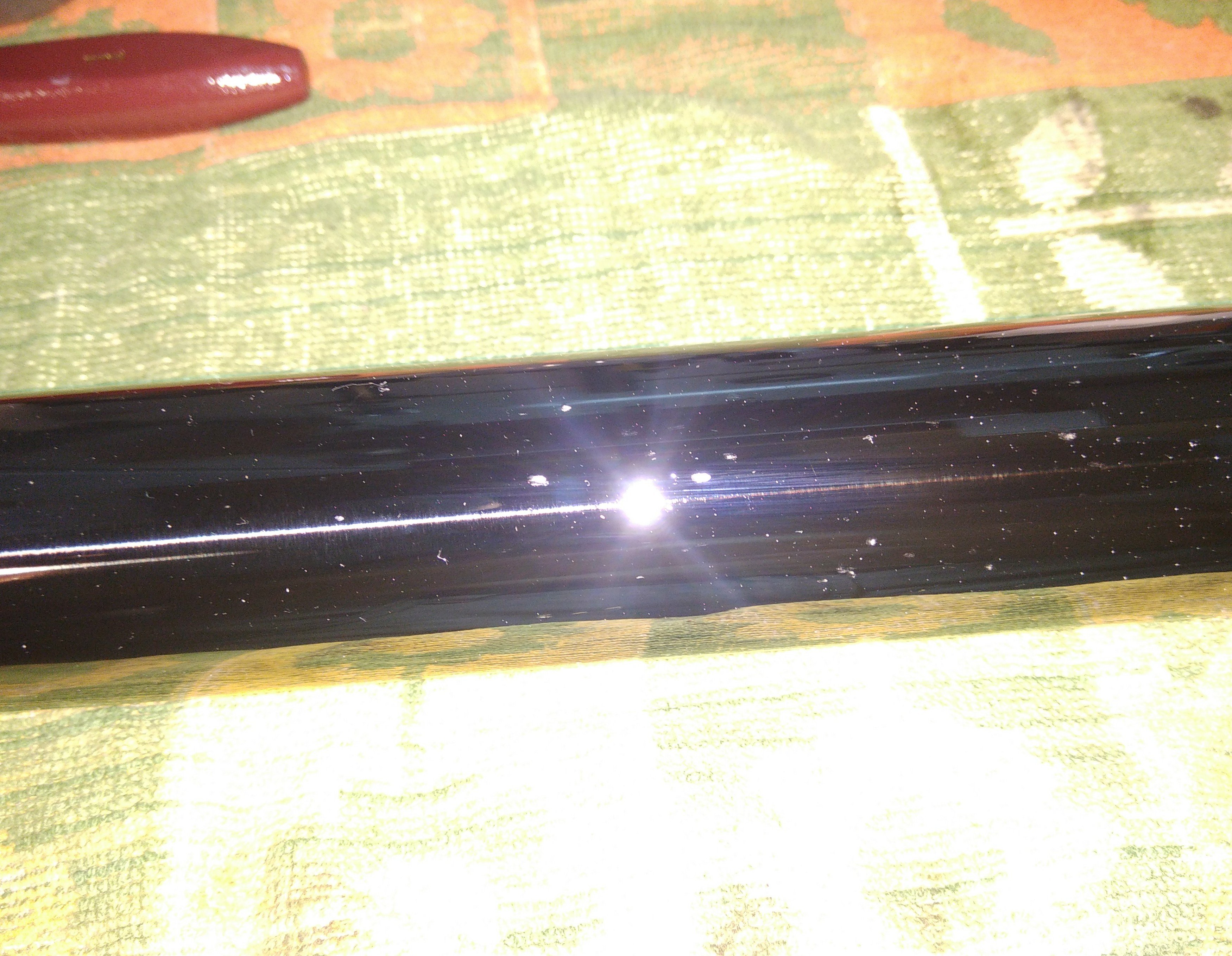

Sanded the patches of black epoxy down using 1200 grit waterproof. Looks usable now. Mounted new bushings, seals and wipers.

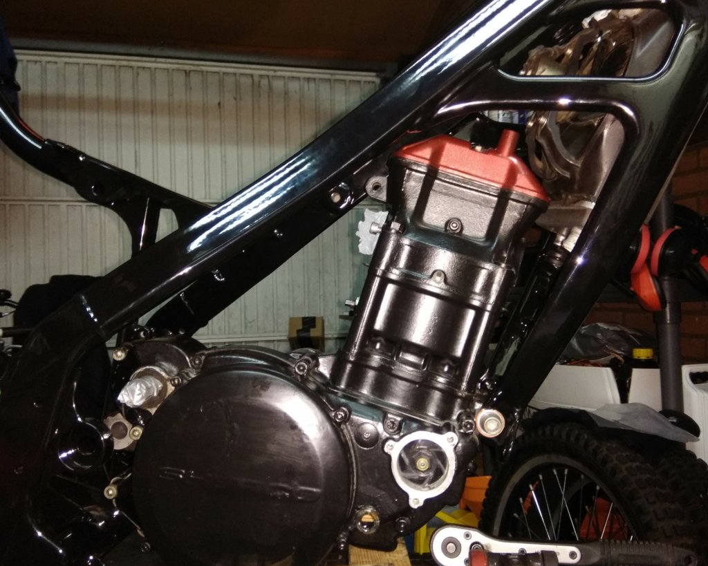

Got the engine back in. Hardest puzzle in the world. I have no idea how to describe the procedure of fitting the frame around the engine. After several hours of messing about, it suddenly went in. No damage to the powdercoated frame.
