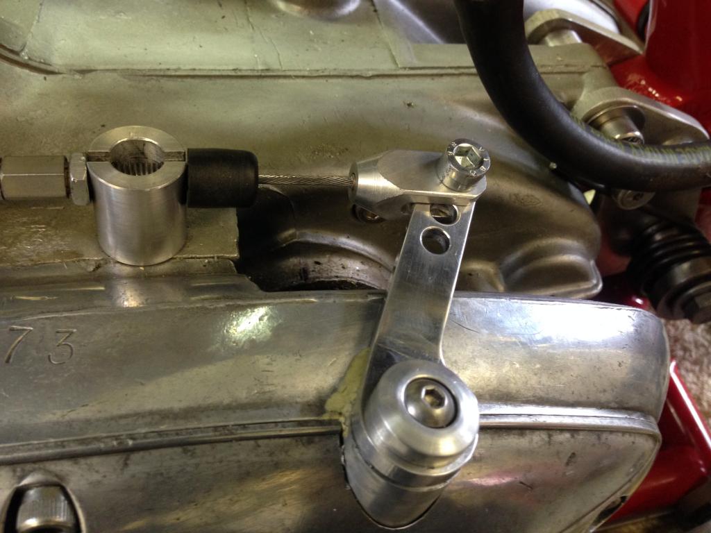

I fitted one and it's really good, clears fully and has reasonable feel. The clutch i fitted was a second hand ybr 125 clutch but I have dumped the bantam actuator and made my own cam type unit which may help with the feel!?
