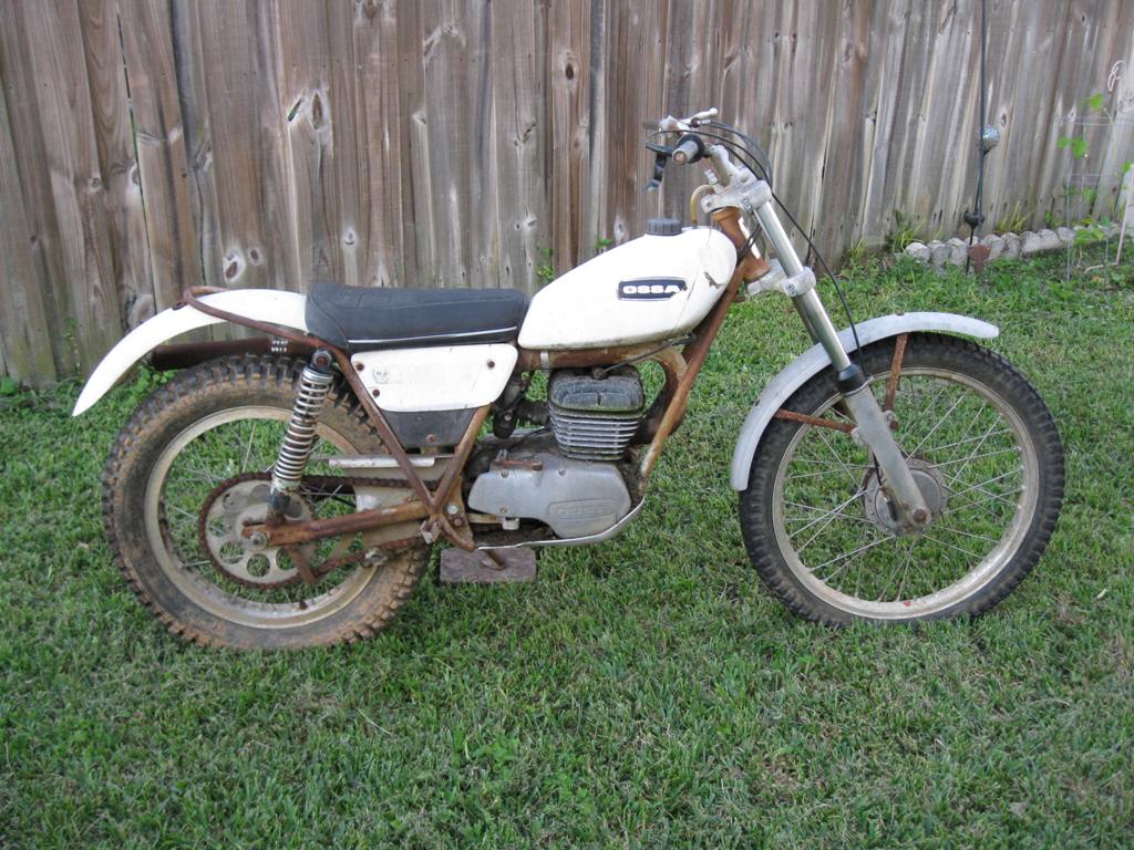

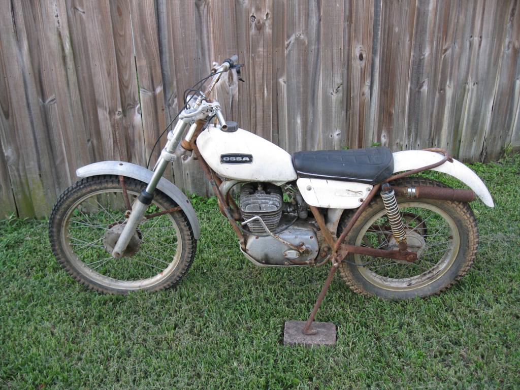

pmk Posted November 6, 2016 Report Share Posted November 6, 2016 I first will say I appreciate the experience and knowledge here. I grew up riding when these machines were being made, but never considered them as I was a kid growing up racing MX when the Japanese bikes arrived and became dominant.  Fast forward to 2016, I wanted a trials bike. Many reasons why. My good friend and riding buddy purchased a 72 MAR about a year ago that was supposedly very nice. He learned it was good but lacking in the fine details and he does not have or own junk. A few weeks ago, knowing he needed some original parts, I noticed another MAR on a Facebook group that was for sale reasonably inexpensive. He acquired it. So he had plans to build a very original machine with original parts, and a second rider. His words were that of we could ride together.  During the time while his second bike was in transit, the wife and I travelled for both family stuff and vacation. The wife and I ride tandem bicycles, both on road and tandem mountain bike. During an event, I spent time with a friend and his wife. With a combined age of my friends at 160 years, it is always fun to see them and ride with them. They still to this day ride a tandem mountain bike off road.  During one of the meal gathering, I was talking with my tandem mtb riding friend, and long time dirt bike rider, about trials bikes. He knew I wanted one, and we discussed my local friends two MARs. He informed me he had one that he had purchased new in 1972. He had ridden it a bunch, but his wife also told me it was her favorite dirt bike of all those she rode.  The following morning, they insisted I pick up the MAR and if possible bring new life into it, or if beyond reasonable effort and expense to get going, use parts as needed to build one of the other two into a more original machine.  So we drove to their home on our return trip to Florida, and picked up the MAR. It had been sitting for a while, stored outside, but had been run randomly but not in a while. The owner said the last time he rode it the clutch was stuck and would not release.  She is rough cosmetically, but viable still at the moment. Ironically the engine is free and smooth. 1 Quote Link to comment Share on other sites More sharing options...

pmk Posted November 6, 2016 Author Report Share Posted November 6, 2016 Yes, it does have matching numbers and I agree parts are available. The possible wrench in the works is how much it will cost to make good vs what it is worth. I am not really into making it a perfect restoration, rather a nice rider that retains the look and ambiance of a vintage trials bike, I think... Quote Link to comment Share on other sites More sharing options...
lotus54 Posted November 7, 2016 Report Share Posted November 7, 2016 It looks very complete.  I ditched the Amal and put on an OKO from Mid-Atlantic Trials. Cheap and works wonderfully (kept the Amal in a box).  If the engine/trans is good, then bearings, cables and perhaps sealing the fuel tank and could be a great runner.  Mark  http://www.mid-atlantictrials.com/OSSA.html Quote Link to comment Share on other sites More sharing options...
