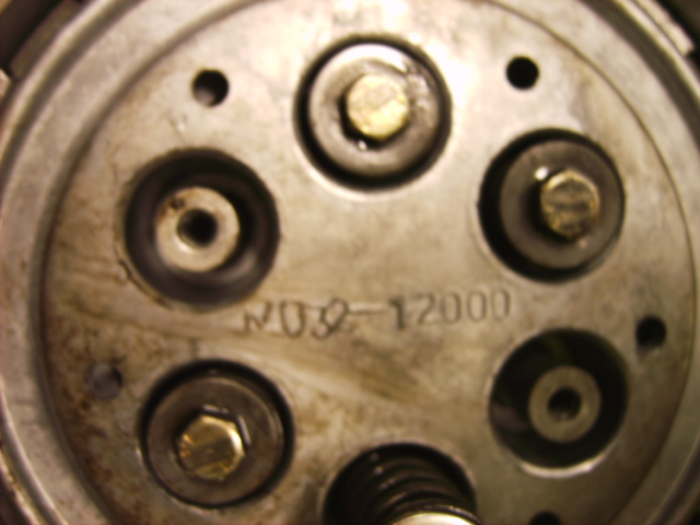

Its fairly common practice to remove some of the bolts from the clutch but not normally that way. Either...
a) refit ALL bolts... more expense unless you have them or
:D remove another bolt so that they are spaced equally.
There are four springs in atm.
i havnt taken the other two out,...that pic was before i took the clutch apart. there are only four springs in there, quite even distribution. in the pic you can just see the spring of the forth one at the bottom.

Your missing clutch springs would have probably been taken out to allow the clutch to slip a bit more, it makes it easier for beginers learning to ride.
yeah i thought that,
just thought the ease of the hydrolic clutch meant you wouldnt have to remove the springs.
see how the clutch copes with the newly beefed engine ! :D
