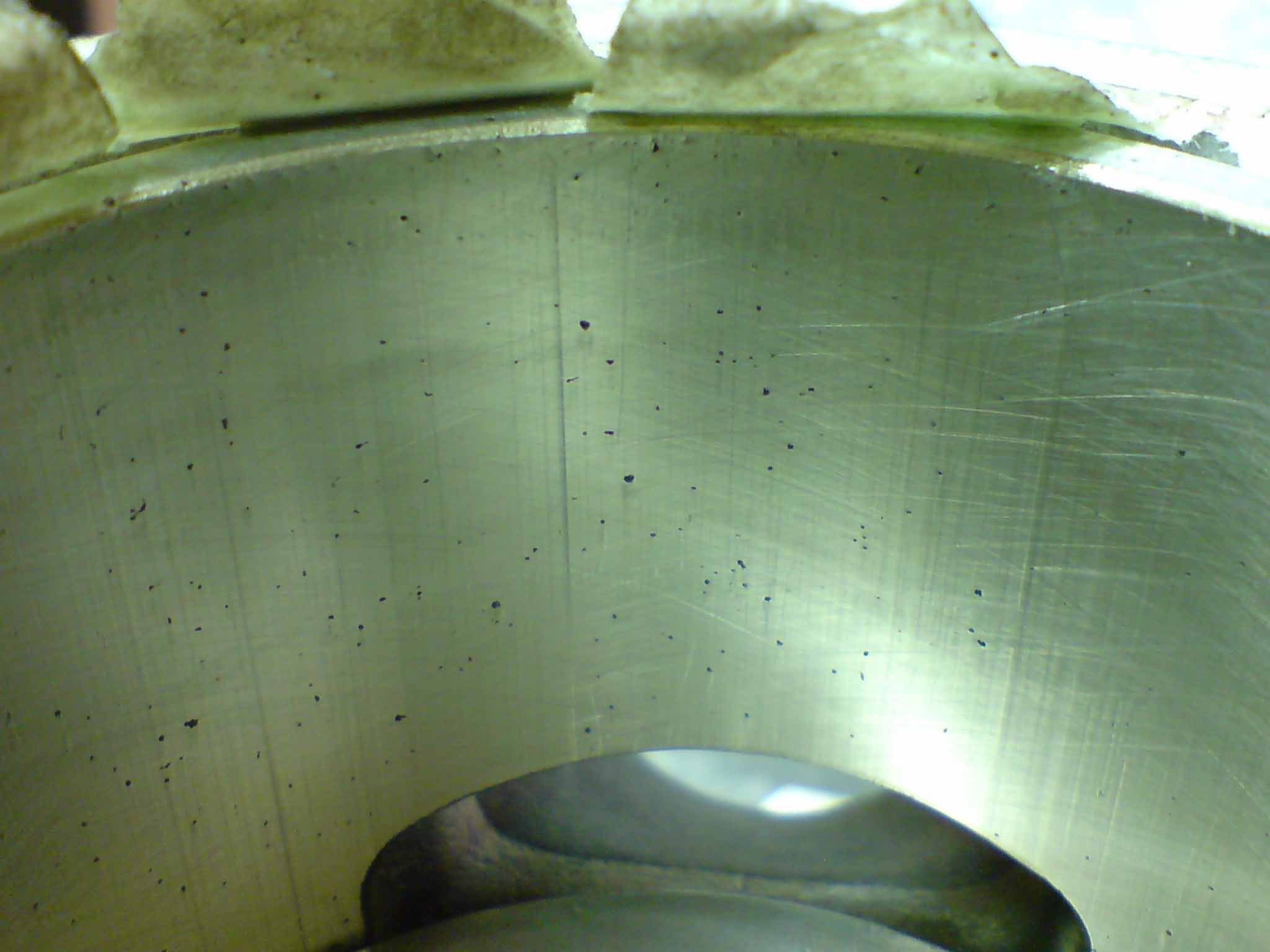

Make some good pictures, preferable not with yr mobile phone, and show us the pitting. I had two barrels done and there is no pitting when done proper, but the pictures must give me a good idea about that.

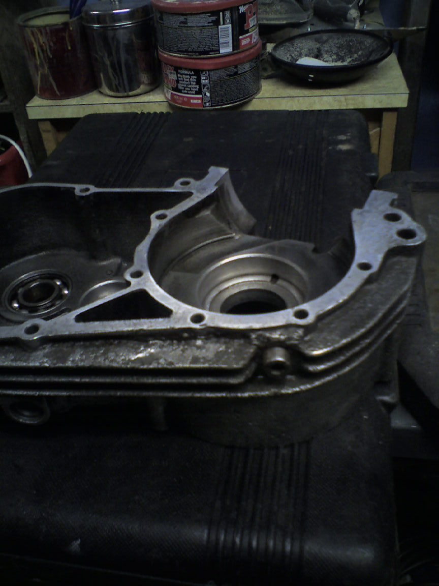

Right a quick question on this side while i look into the piston and a picture of bore pitting
here is a picture of the casing, there is a plug directly under the area of the crank and the main bearing
WHY ?? B)
there is no oil there is there? the gearbox oil is seperate and its a wet clutch
So its a drain plug ?
why and when would i use it ? im abit confused :)

The drain plug is for when you either drown your bike & the crankcase fills with water or when your float needle starts leaking and fills the crankcase with fuel (no overflow on a Delorto).

Im getting worried about this piston now, this one does have abit missing out of the skirt but no windows, and there is the pitting in the bore.

BORE
had a chat with a a chroming place, they say that the pitting is normal, the more you take out of the bore the more pitting you will come across, think its to do with the casting process, and theres nowt you can do about it
anyway, he says, that its not that bad, and it will run fine. BUT i should put an additive in my petrol to line the bore, because i dont want a build up of carbon in these pits as that will score the piston.

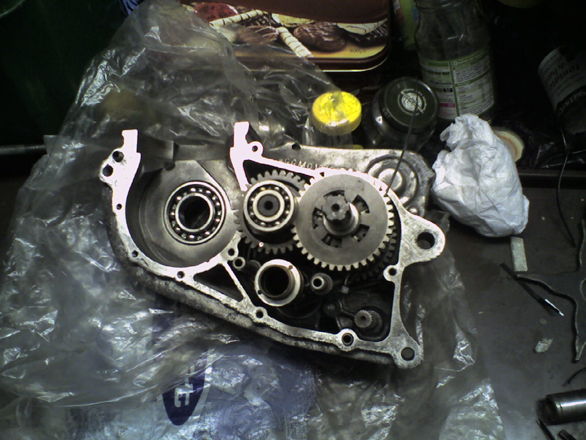

Got the gearbox in now too !! :chairfall: Went in quite well and easily actually :chairfall: , my dad lost the charger for his camera, so i couldnt get the pics for where the selector forks went on the shifting drum, but i worked it out :P

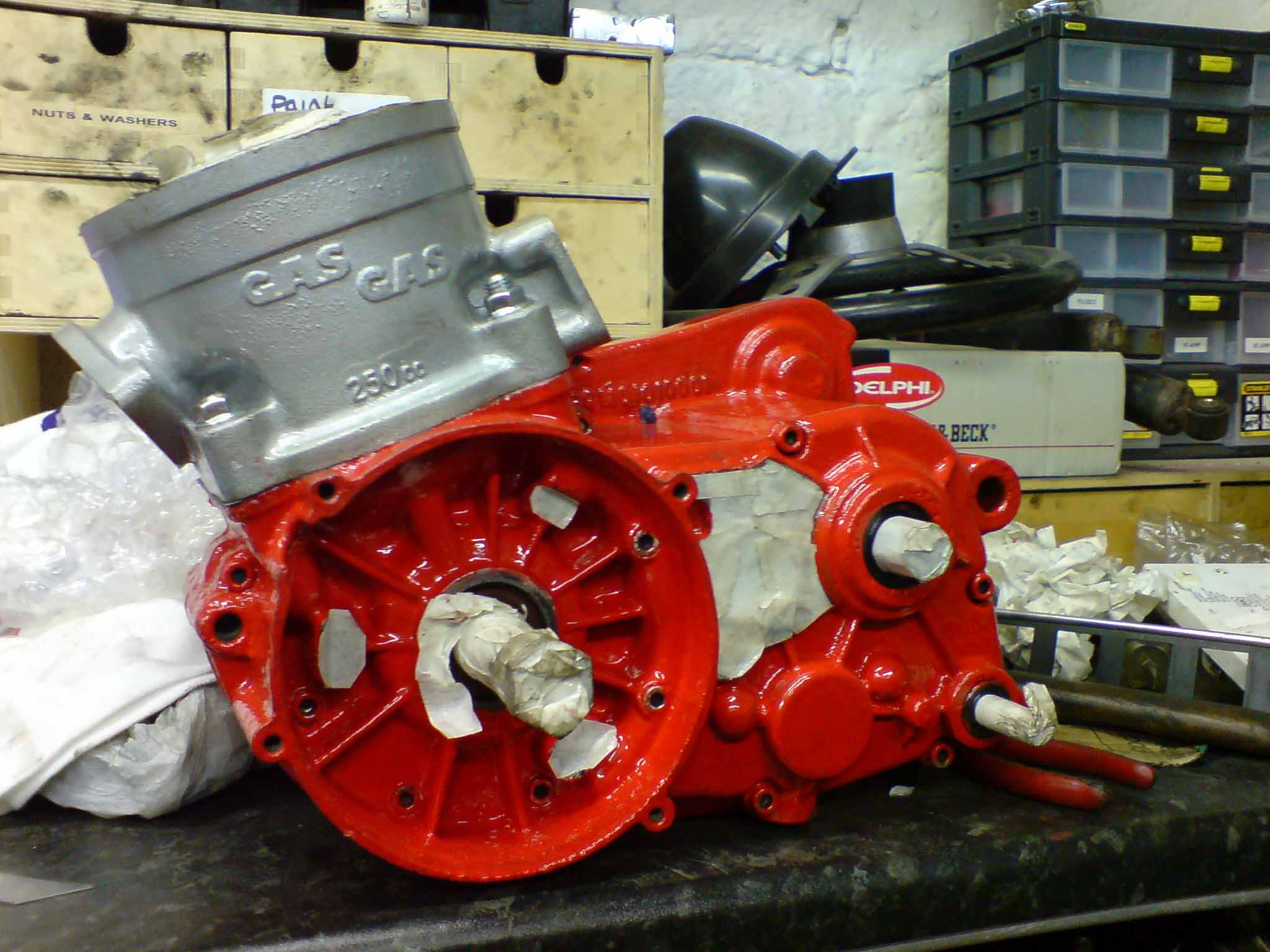

Hello !!
im going to post the pics so far now, and the ones of the bore for you gasgas...(sorry for the wait)
Ive painted the engine casings, with hamarite metal paint a **** load of coats and a long time to dry... and i dont think its as hard as i want it to be so im abit gutted about that
Bore has been clear laqured with clear high temp paint !! :blink:
I recon in a couple of years ill have to take the engine out and paint it again ( properly ?? )
Well here are acouple of pics,
Ive fitted the bore and piston (drilled a hole in the side for the timing) and i also changed the mains bearings, front sproket bearing, crank seals, con rod kit, coil rewire, whole gasket set,
Anway, ive got to put the head on now, and rebuild the otherside of the casing, and then laquer the frame.
My dads advised that i just paint it on nice and thick...lol ??? :chairfall:

pic of the barrel, this is the worst part of the pitting and in honestly looks worse than it is
barrel
