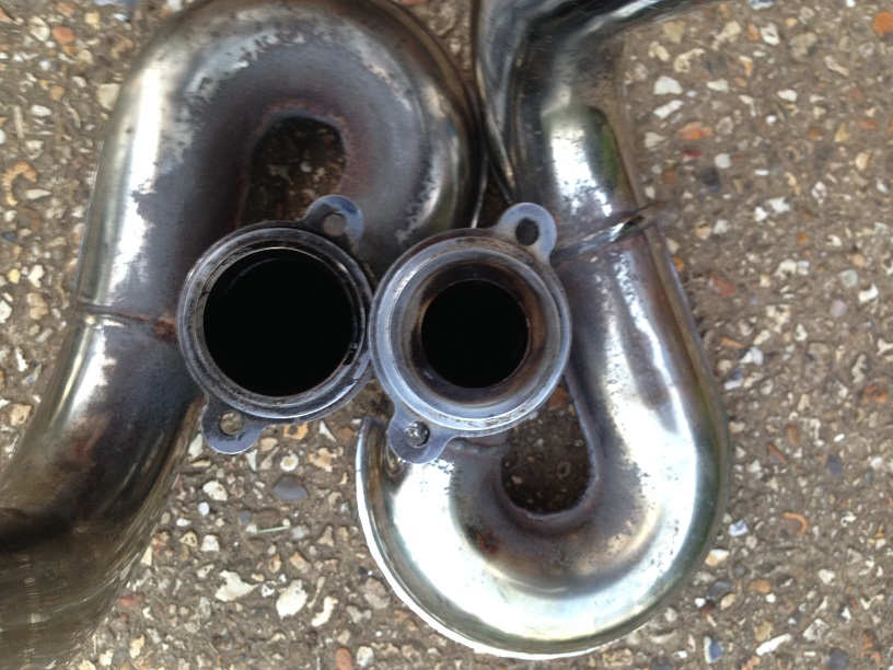

Can anyone tell me why the exhaust header pipe I just got on a well-known auction site has a narrow neck where it joins the cylinder?
First I thought it was from a smaller CC, but looking at other ones online I've seen them advertised from the 290cc. My bike goes well with it on but will it overheat?
It will be an insert that is normally fitted for use on 125s, see if you can remove it as it will have an effect on a 290

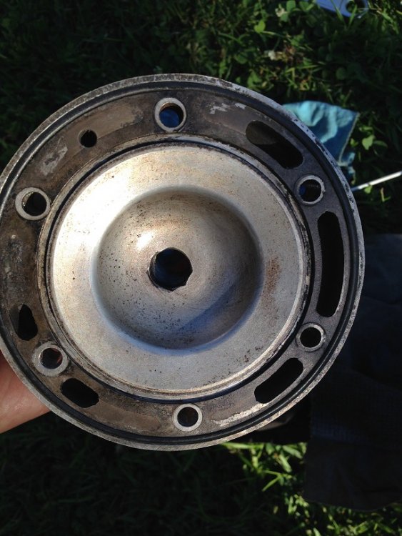

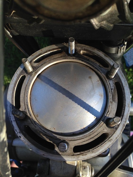

  • I finally lifted the cylinder head and it wasn't as bad as I'd feared (pictures below) The piston and head were completely caked in carbon, so obviously hadn't been open for a very long time, but
Early 125 pipes were made small and did not require an insert. It is ona them!

Put it back together and run it on 80:1 full synthetic good oil and rev it out  on occasion to get some heat into it.
Is it likely to be damaging on a 250cc engine do you think?
It doesn't appear to be an insert, more like the whole neck is narrow.
Here's what the two exhausts look like side by side - my old 2.5 exhaust (left) and the narrow on the right:
