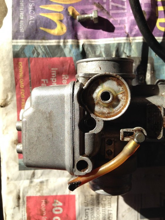

While cleaning the carb I found there was a lot of sandy grit in the filter
Also the jets appear to be 33 pilot and 124 main, does this sound about right?

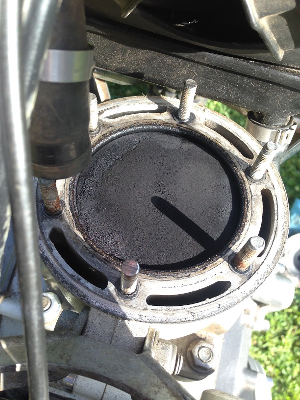

  • I finally lifted the cylinder head and it wasn't as bad as I'd feared (pictures below) The piston and head were completely caked in carbon, so obviously hadn't been open for a very long time, but
Yup, looks like it's been severely neglected.
I don't think the pipe is blocked, it looks as though its been burnt at some point! Although I hadn't realised this was a breather, in my ignorance I'd assumed it was an overflow, so I'll check that's not blocked either.

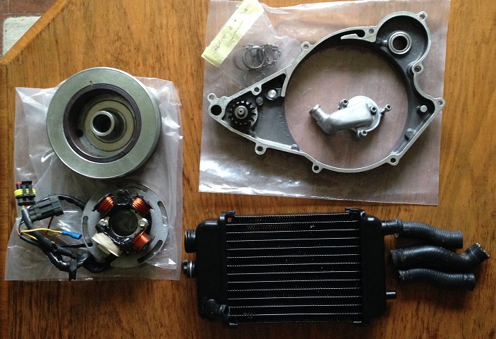

As luck would have it, I came by a very clean looking stator plate and a few other parts (clutch housing inc. pump and a pristine radiator inc. hoses).

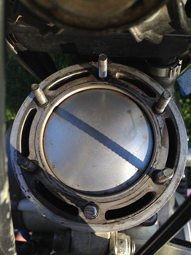

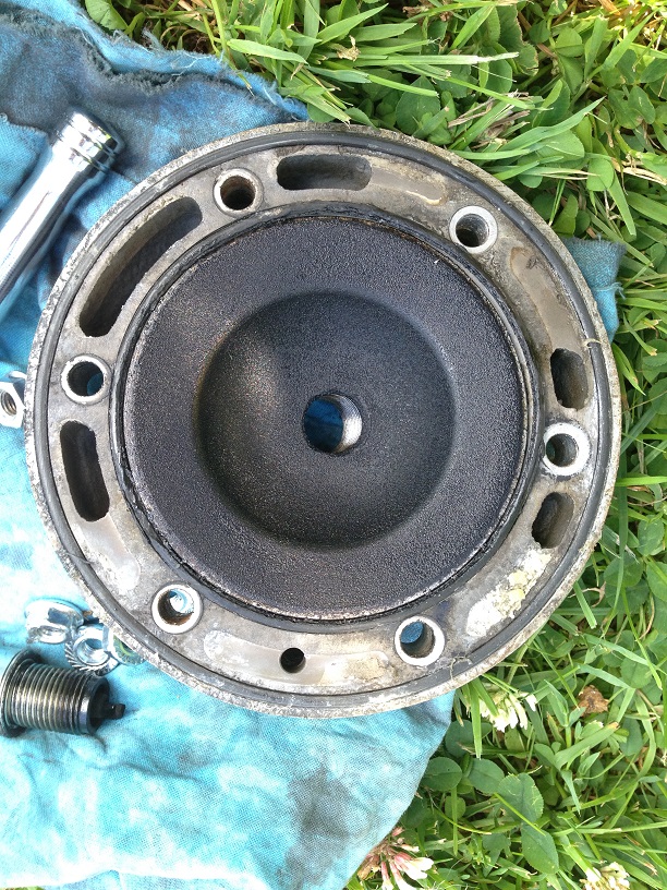

The piston and head were completely caked in carbon, so obviously hadn't been open for a very long time, but once cleaned off didn't look bad at all. It's probably the original piston!
It looks like it's taking in too much fuel judging by the residue in the cylinder and on the spark plug?
Edited by bluegnu
