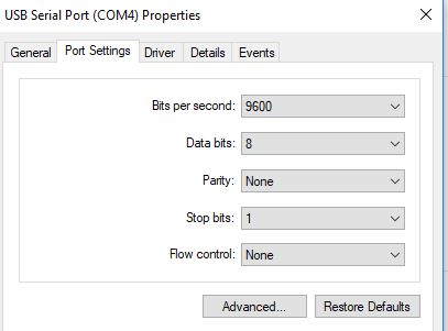

Hi,
I checked my drivers and all seem to be correct (see attached image).  I have 2 x FTDI cables (A) USB-RS232-WE-1800-BT_0.0,  and (B)  USB-RS232-WE-1800-BT_5.0.
I also have 2 x laptops - 1 x Sony Vaio with Windows 10 - which is the one I have snipped the attached driver details from, and 1 x old Dell Inspiron with Windows XP. I also have the FTDI driver (for XP laptops) on this laptop and the system shows it installed and working properly.
The problem is that with both laptops and both cables I still can't get the K-Scan to see the ECU.  I have tried all possible variations, so I am still suspicious there is a difference between the generic FTDI cable and the Btwice cable.
If anyone has any suggestions they would be very welcome.  Thanks.ECU not found.jpgIMG_1144.jpgIMG_1145.jpg

Hi,
I have tried all the Com port options 1 -10 as well as Auto.
If you have the Btwice cable can you check the port settings to see if they are the same or different to mine - as attached?
Thanks.
