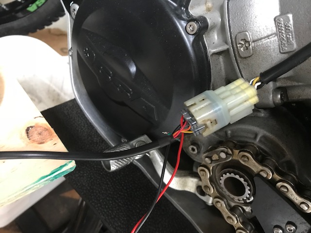

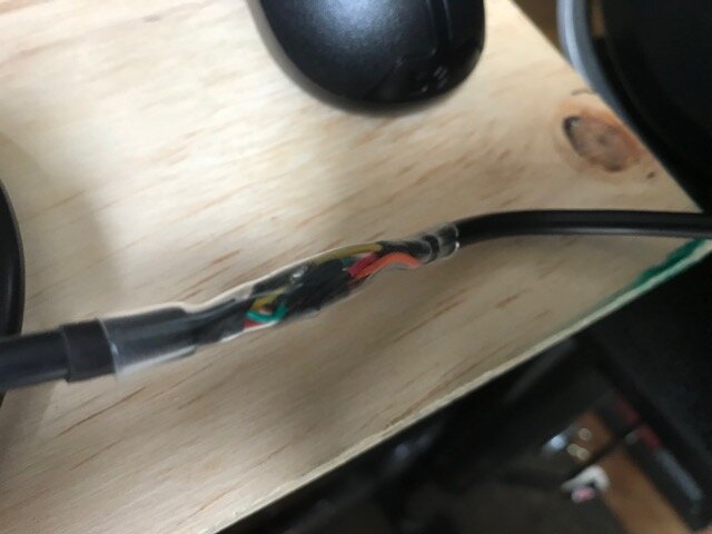

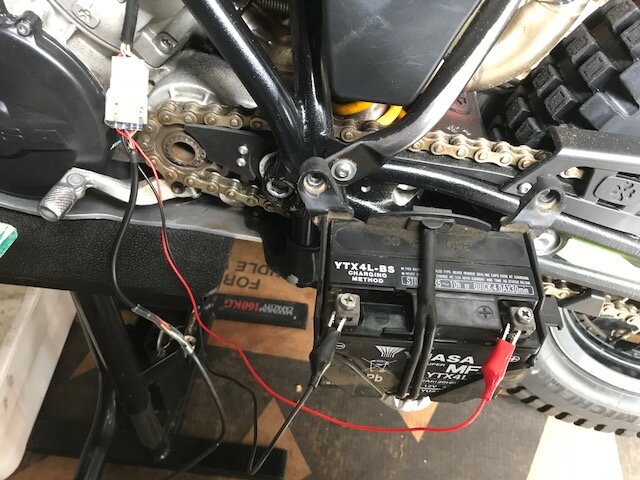

Hi All,
Just an update.
I received the new FTDI serial TTL-232 USB Cable over the weekend and grafted the terminal plug from one of my earlier failed FTDI cables and plugged it into my TRi300.  It works !
See attached photo's.
Thanks.
