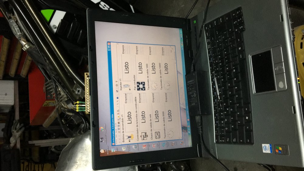

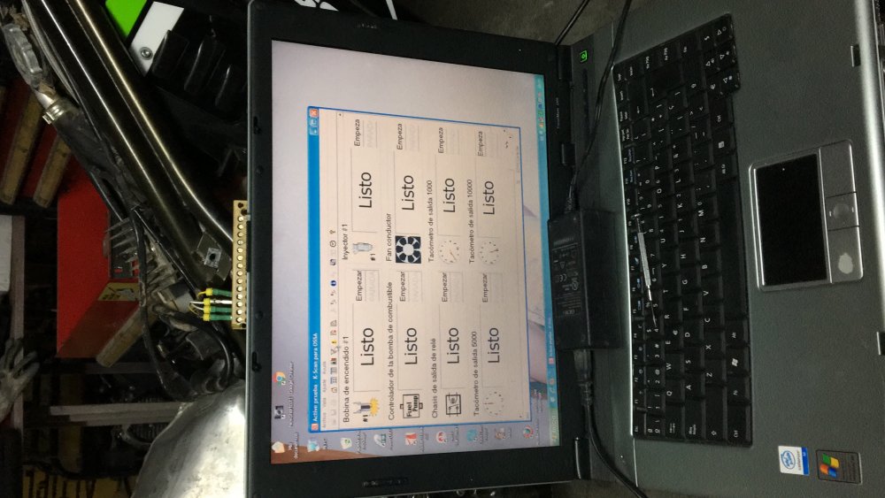

I reset the tps and it controls all the tests fan, relay, fuel pump, clears codes, shows ecu data, hours. Dont have any calibrations, think i have latest.
Excellent, so if it reads as well as writes to the ecu then it looks like a cheap solution is found!
