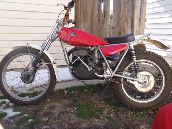

I'm just getting back into the sport after a 20 odd year rest, hoping to do some twin shock trials and dual sport events on a 1978 Bultaco Sherpa T model 199a.
What I'm after is some history on the Bultaco 350/325 sherpas, model years, specs, major change dates etc. Do the vin numbers hold any details of build spec and dates etc.? Are there any useful web sites with model details? I know the much later model 199b was a 6 speed motor an had box section swing arm but don't know much more than that. When did the color change from red to blue? Did the tank seat units change over the models? How do you tell the model apart? The example I brought has the gear change on the right, they are supposed to be on the left??
I attach a pic for ref...

Welcome to the forum jontribe. A quick glance at your photo indicates to me that the bike is a Model 199, circa 1978/79 which was the last of the red Sherpa T's and not a 199A which where the first of the blue Sherpa T's in 1980/81. A give away clue is lack of the reenforcing gusset on the top of the swinging arm. Also the 199 didn't have a cut frame to facilitate the bash plate.

Agree with model 80. Your bike in the picture is defiantly a 199 so the red paint is correct.. The 199A came out in late 1978 was painted blue. Had an aluminium bash plate under the engine, reinforced swinging arm and a different magneto cover and kick start. The gear ratio's were also changed with most notable visible difference between 199 and 199A is the later has a smaller rear sprocket. Other minor changes including adjusting the height of the engine in the frame by a small amount.
You bike looks quite original. In the UK we would have had a different tank to that fitted for the rest of the world. The only thing basically not correct is that seat is wrong.
The gear change can be set either LH or RH. LH was standard and with this set up the rear brake is operated by a cable that loops across to a bracket on the frame down tube near the silencer. I can not be sure from your pictures but I think I can see a blob of weld but the bracket seems to have been cut off. This cable operated brake is a bit spongier than the direct operated rod and opinions will vary as to what is best.
