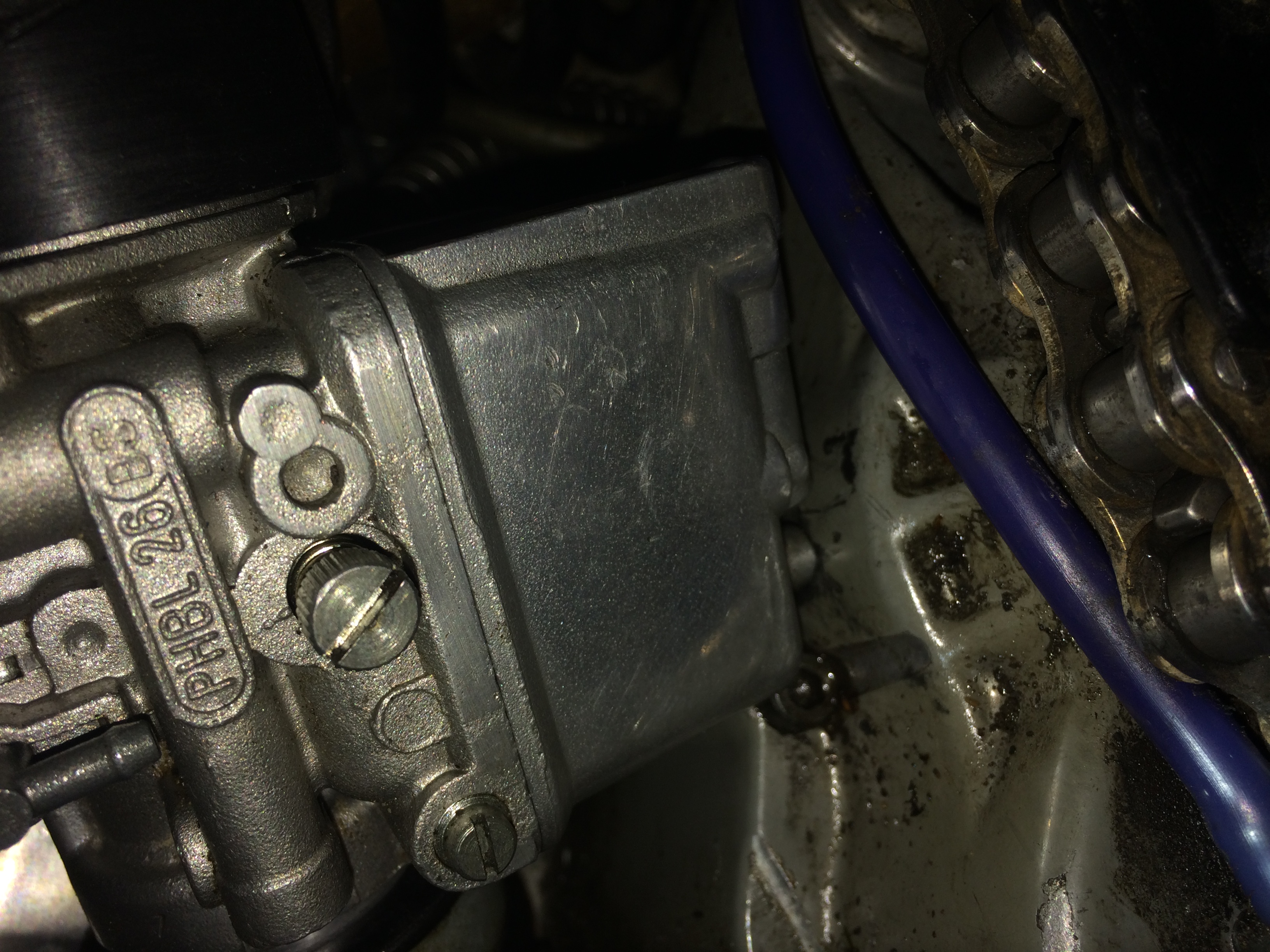

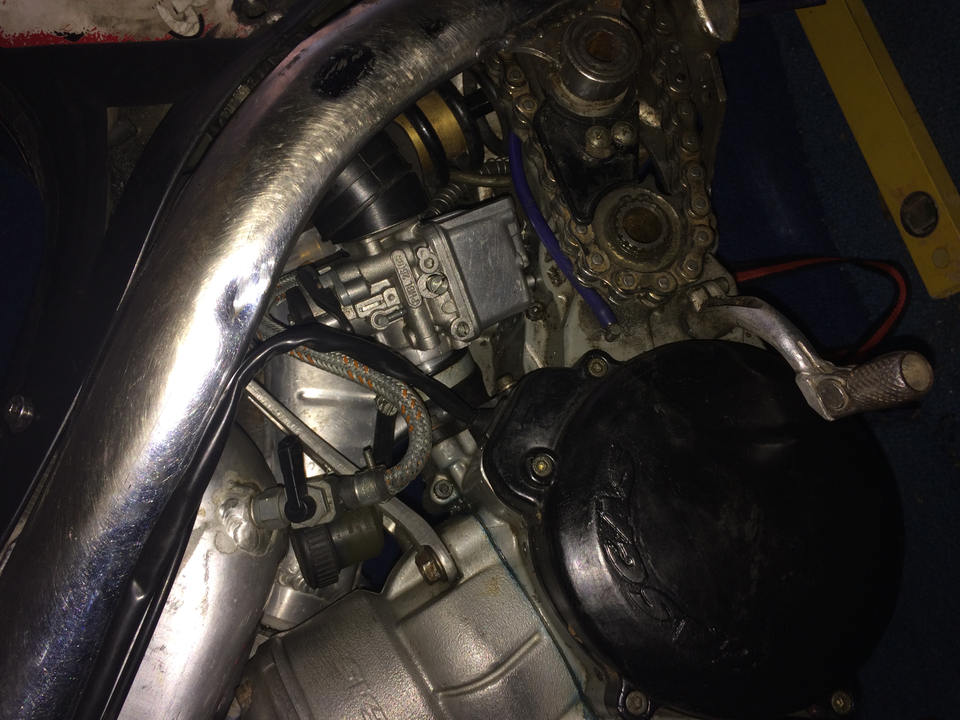

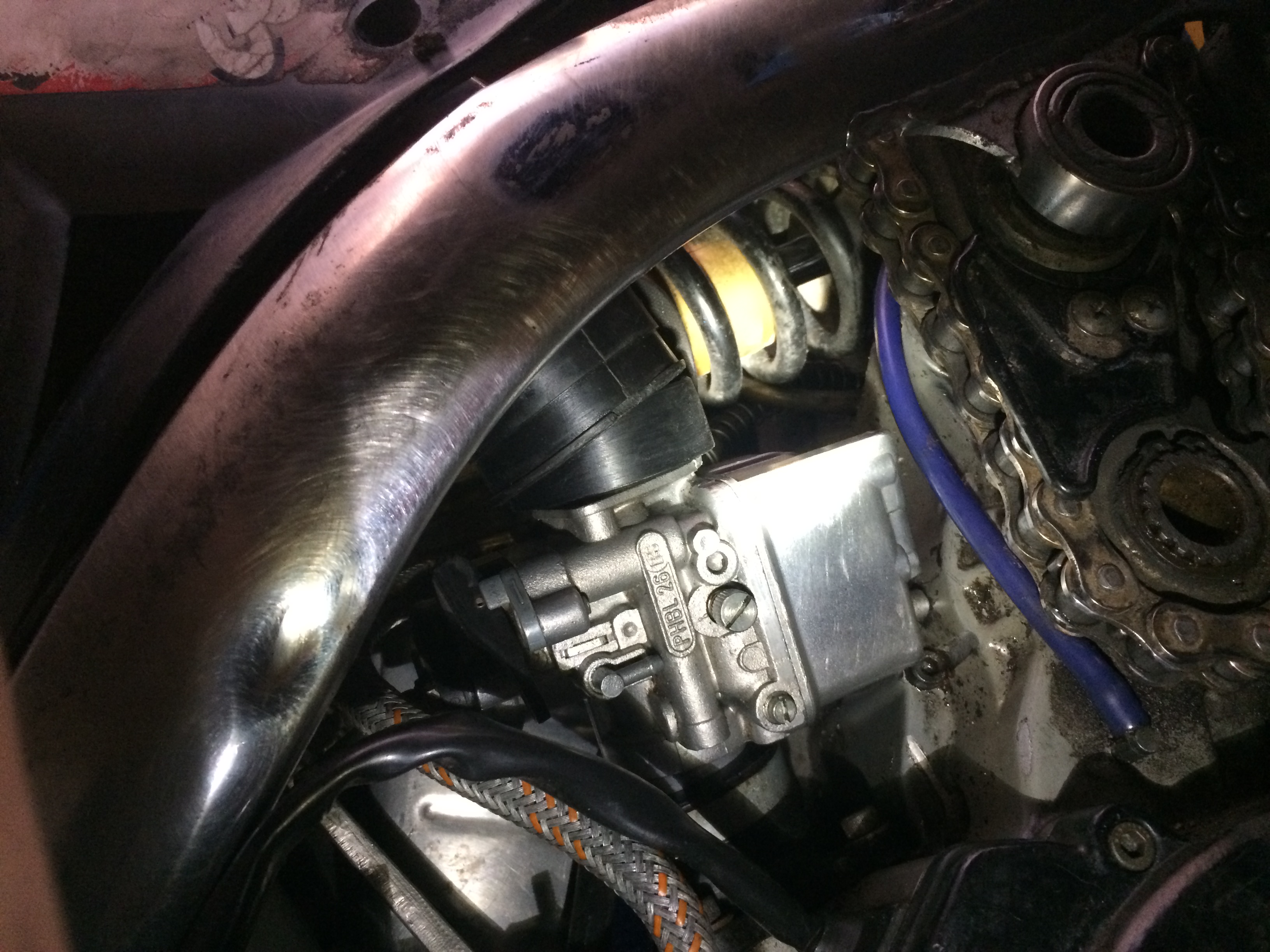

Attached is the photos I just took- the bottom one shows the nipple that is hitting the engine.
sorry for the poor pictures- it shows the current gap, and after a few mins of riding the gap at the bottom is 2mm+, allowing dirty air into the carb.
Pretty common on those early 2002 bikes for that rubber tube to "shrink" a bit over time. Gets stiff and smaller!
Gas Gas used a new part in 2003 Hence the BT280"3" 28017 part number
Either fit a new airbox rubber tube # BT280328017, or like you said get something to extend the original.
If you follow my procedure above together with warming up the airbox connection, i'm sure you'll find the carb will connect better.
Also, make sure that the carb is fully pushed into the airbox even if this means you're having to pull it out of the engine side a little.
