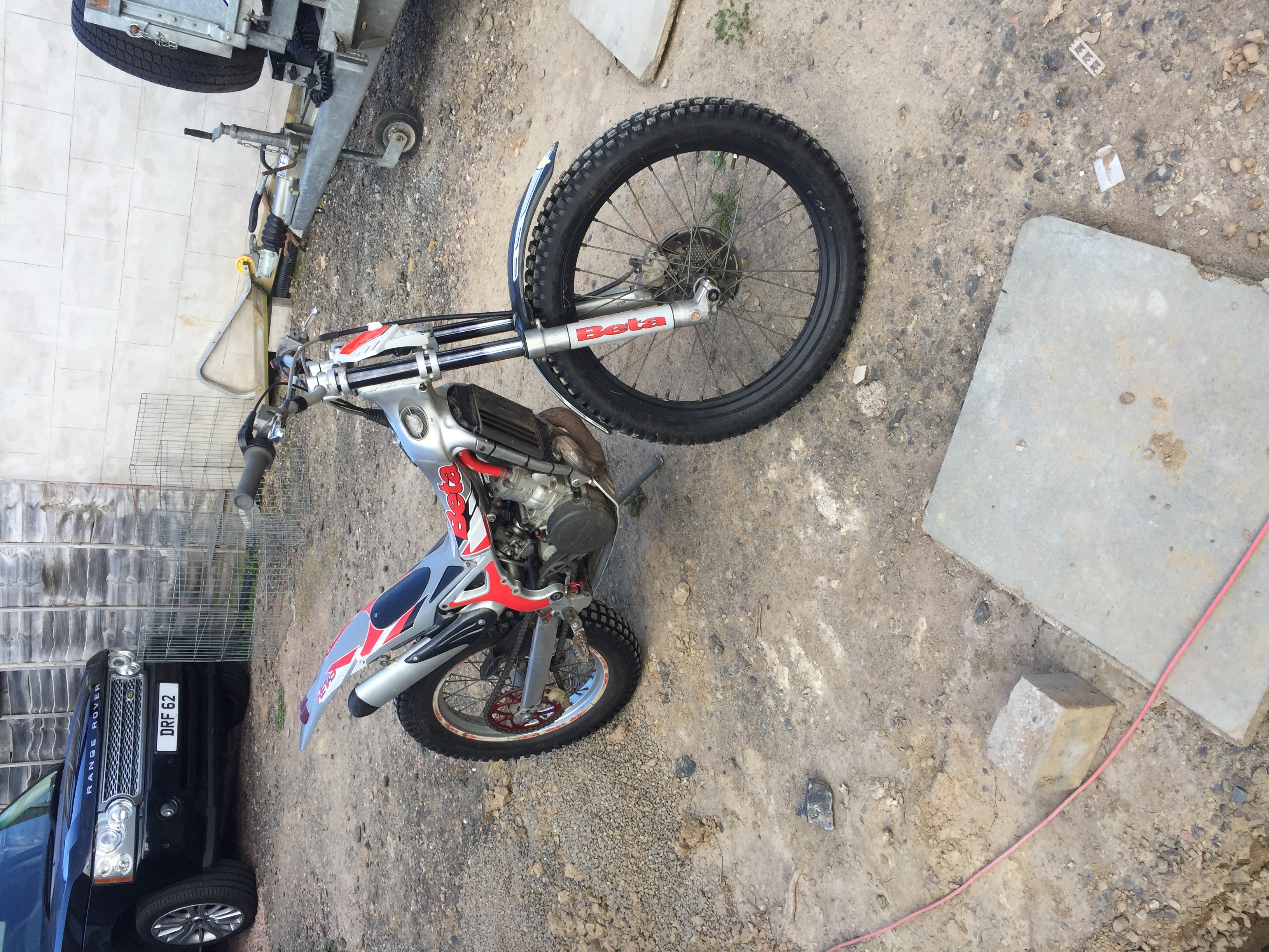

Hi, can anyone help? Just picked up a Beta Rev 3 270 2007 looking to confirm if this is the correct year and engine size.

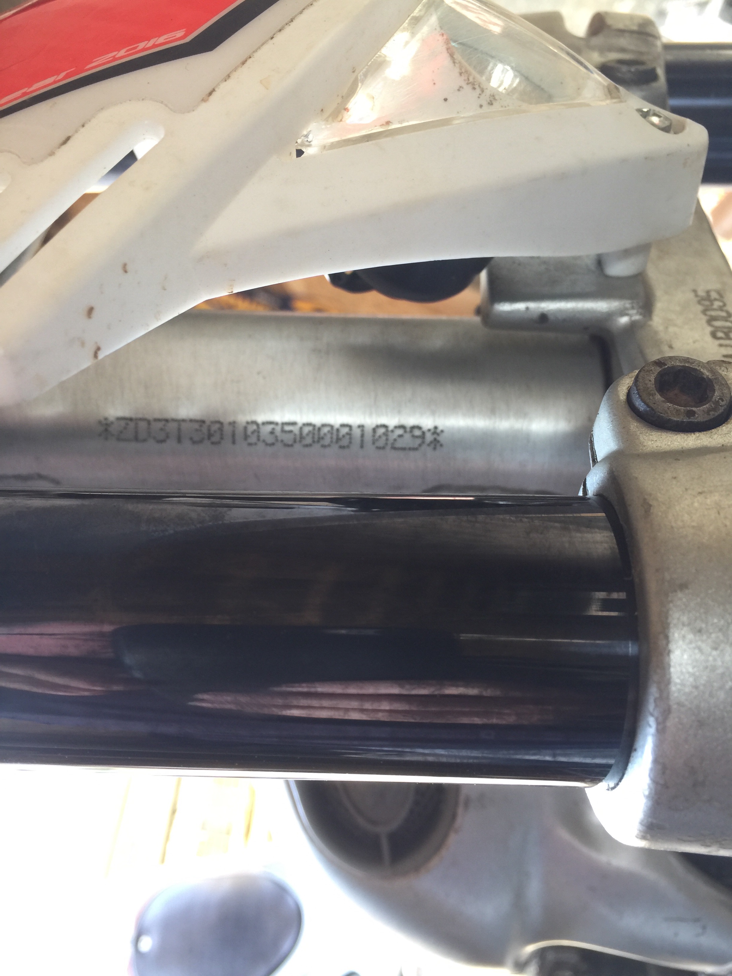

Go onto Beta uk look up the year you think and the frame and engine numbers on there you may have to try a couple of years to get the correct year , One wheel is wrong colour
Thanks Scorpa 250, tried that, but still couldn't find it.
Davy
So it look like a 270.
ZD3T3000040000001(125cc)
ZD3B9000040010809(200cc)
ZD3T3010140000001(250cc)
ZD3T3010340000001(270cc)
Edited by bilks
Many thanks Bilks, i had a feeling it was older than the advertised. is there a way of identifying the engine.
Davy
Only with the frame no's or unless you take the head of to measure the bore dia.ID yes for the 270 model
