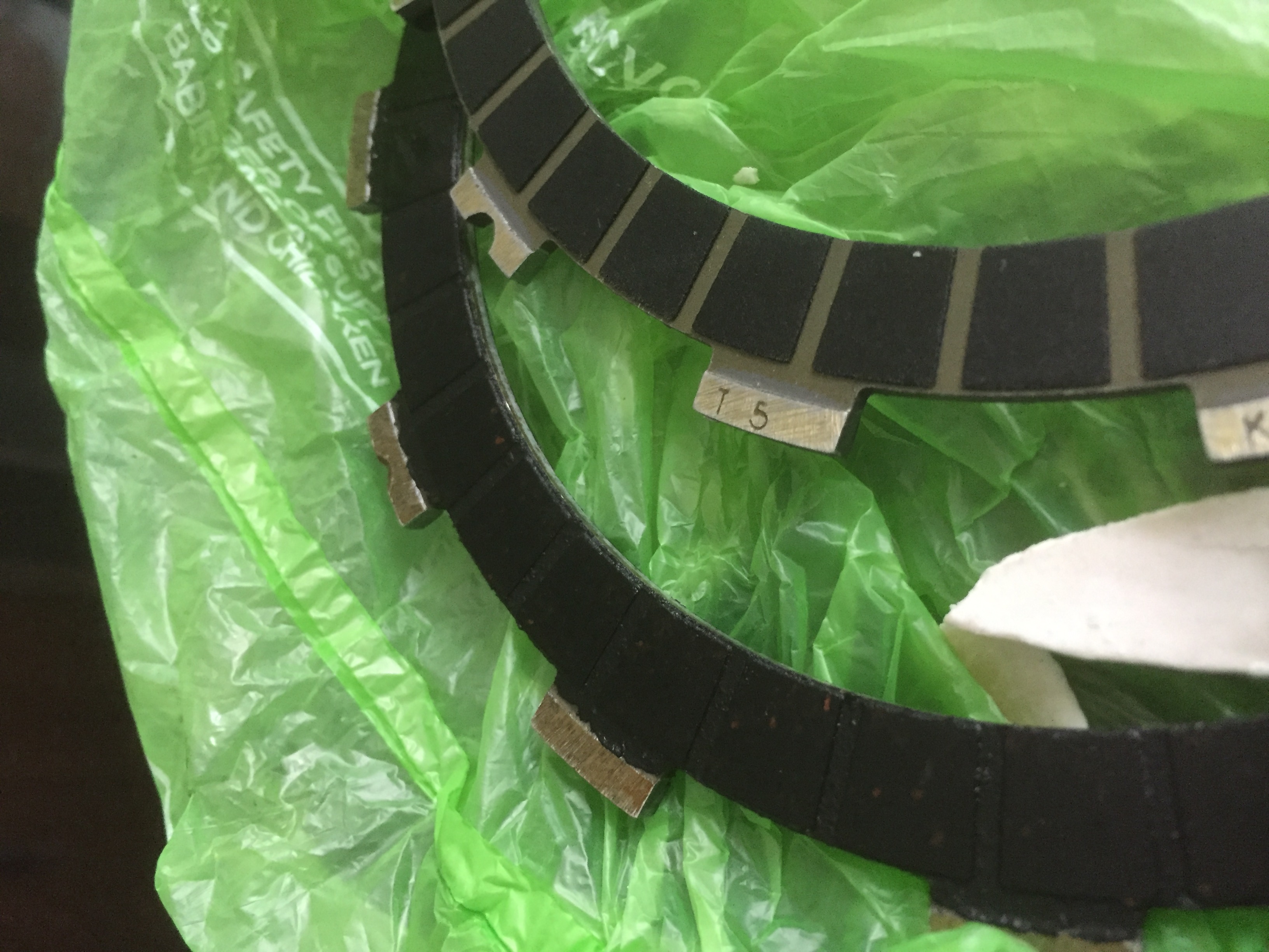

Thanks all, just cleaning and inspecting the plates have noticed the plate in first is different from the others, see photo, it's black in between the pads and on all the others it's a gold colour, do you think it's just because it's the first plate, all sizes look the same. Sorry for all the questions but have never taken a clutch apart before so learning something new every day ?
The only way you could tell for sure would be to measure the thickness of the disk with a set of calipers.  I didn't have any different color or type of disks in my 4RT, but have had different thicknesses of the steal disks on my wife's Gas Gas and the glue issue on my daughters Beta 80.
Edited by jonnyc21
Out with the measuring stick, more tools to buy, i love my local tool store , thanks ;-)
