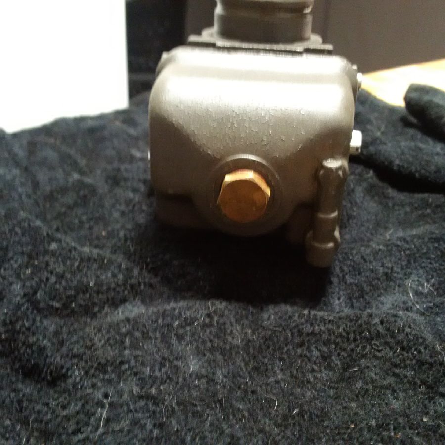

How does the carb bowl come apart from the carb? There seems to be no external screws holding the 2 pieces together? I removed the drain plug but I cant see it holding the 2 pieces together. I don't want to try and pry the 2 sections apart and ruin the gasket.

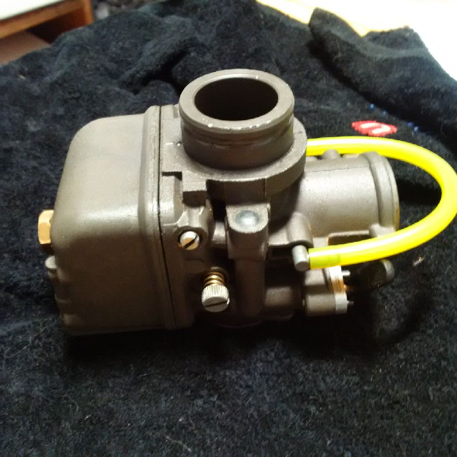

  • Is there a hole in that yellow pipe?

It is only held on by the drain plug/main jet holder, it also fits over the bottom of the choke jet with an o ring - its probably this that is holding it, there is an o ring between the bowl and carb body too, no gasket. It should come off if you wiggle it enough.
There was, I replaced it? Was I wrong?

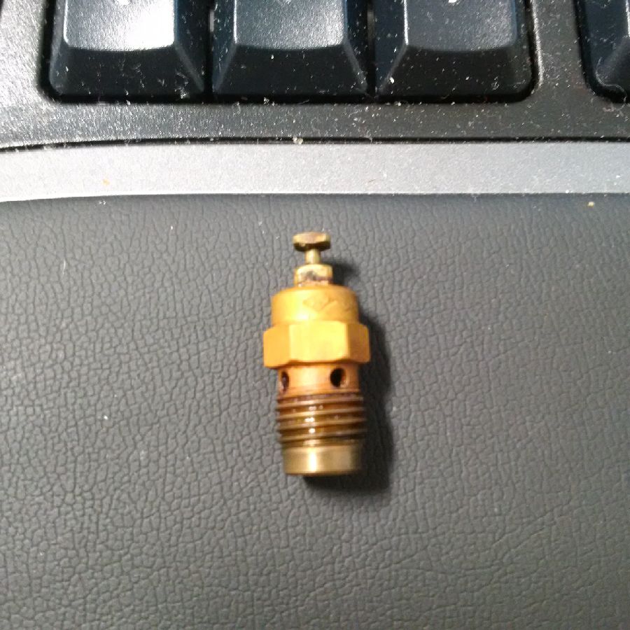

Is this top pin meant to be tight or is it made to go up and down?
Without a hole in the pipe no fuel will be drawn out of the carb, the two stubs are float bowl vents and need to be open to atmospheric pressure, a lot of people (me included) don't use a pipe at all on the vents.
The 'pin' in your photo is the float needle which allows fuel to flow in to the carb. The needle should be a free fit in the other part (the needle valve), if you turn it upside down it should fall out. It could just be gummed in place with old fuel/oil, but the chances are it needs replacing, if it doesn't shut off properly you will have crankcases full of fuel.
