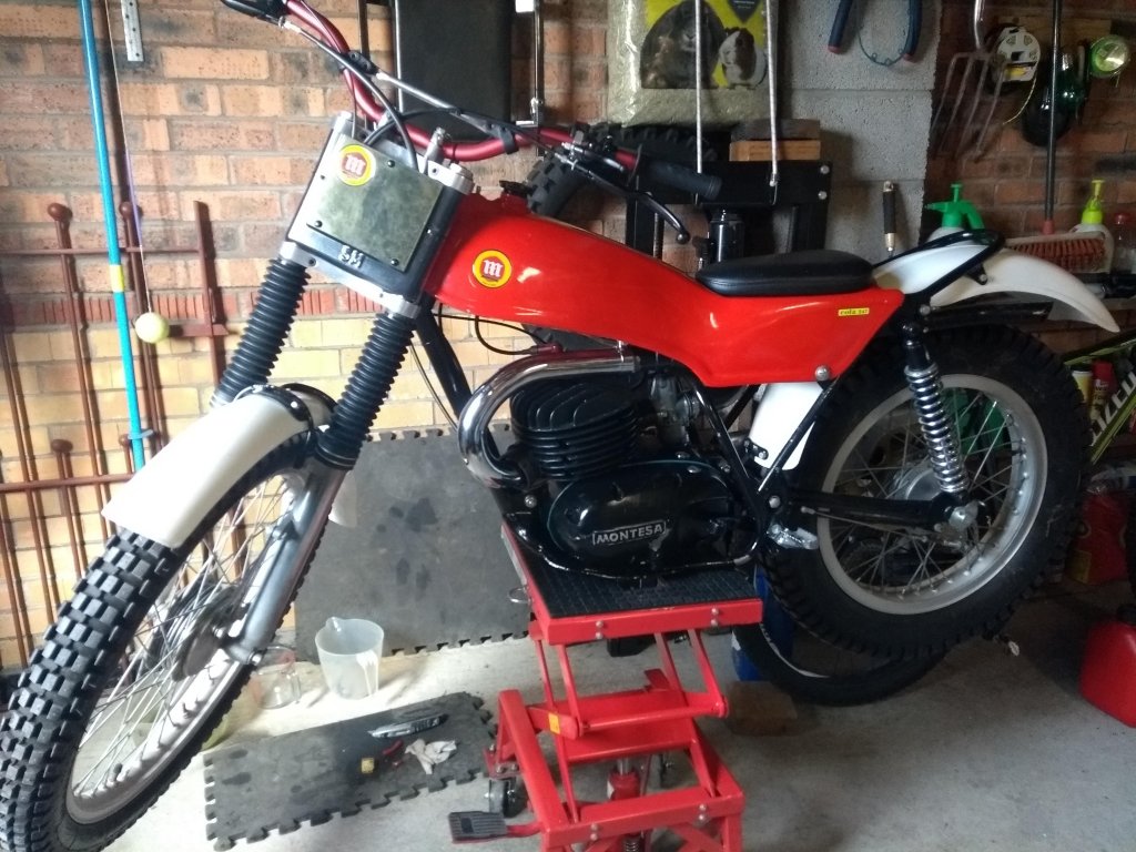

Can't believe how time has flown since my last post on the 247 non-start saga - with the 2018 season well underway and the UK weather looking positively Mediterranean (I wish!), curiosity got the better of me yesterday, resulting in me removing the old bedsheet thats been covering the Mont since last November. Feeling a mixture of dread and optimism in equal measure (dread from past experiences and optimism courtesy of Heineken), I've decided to have another crack at getting 'TOBY' (The Old ******* from Yesteryear), started and commissioned for the season ahead.
New ignition coil beckons, failing which, it'll be either an electronic ignition upgrade + rebuild, or electronic ignition upgrade only, depending upon whether it does the trick or not and if it does, how things sound looking in from the outside.
Wish me luck.

Still a Work in Progress, but I'm getting there.
Success will likely, see me cartwheeling nekkid along the A48 - wearing nowt but my Hebo trials boots and a stupid grin!
