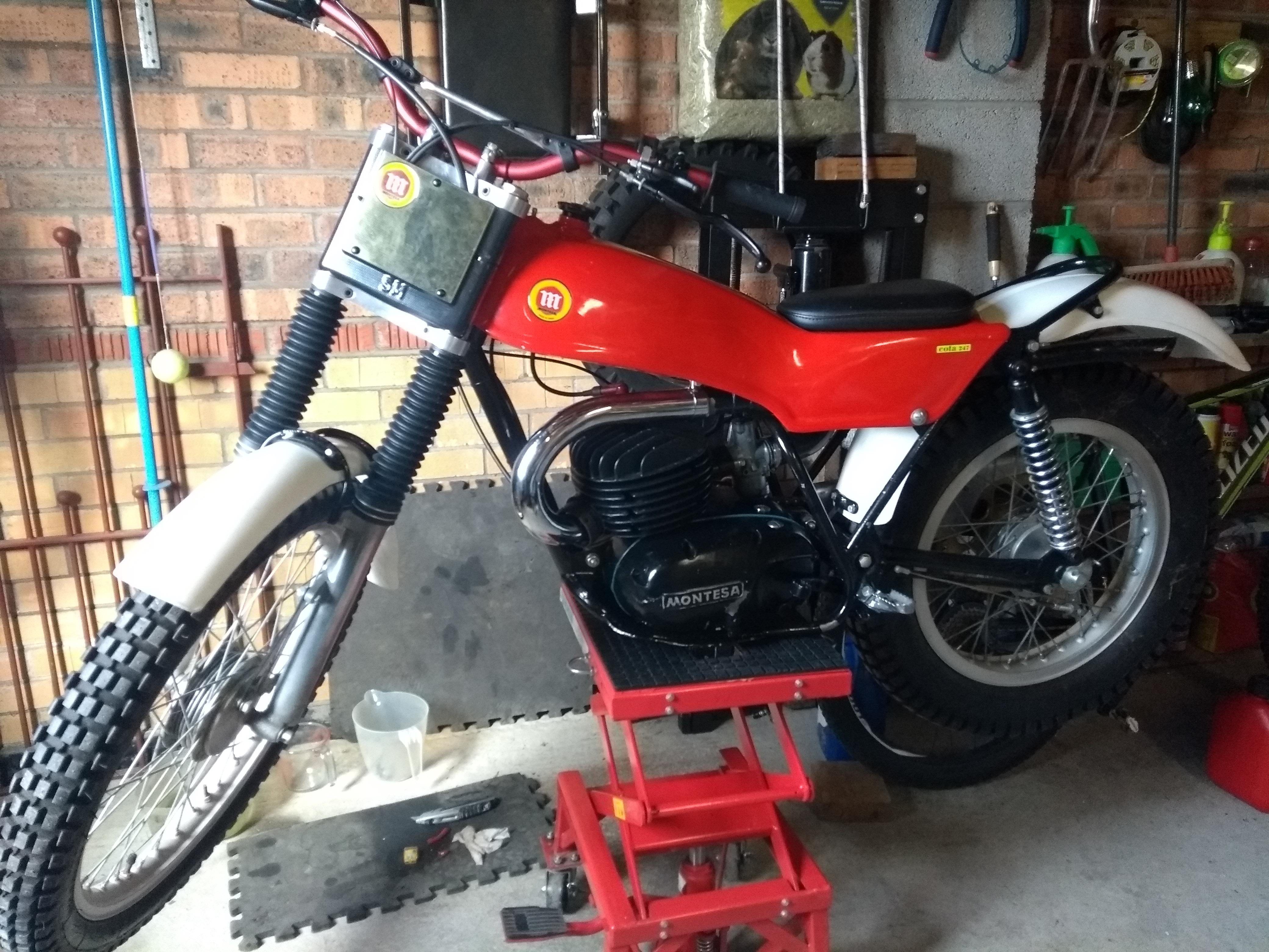

... and here he is (TOBY), The Old Bast**d from Yesteryear (sorry, the bike fought me all the way, in every way... it got personal in the end!), finally ready to trial.
Nice bike! Great to see you persevered and worth it in the end :)
